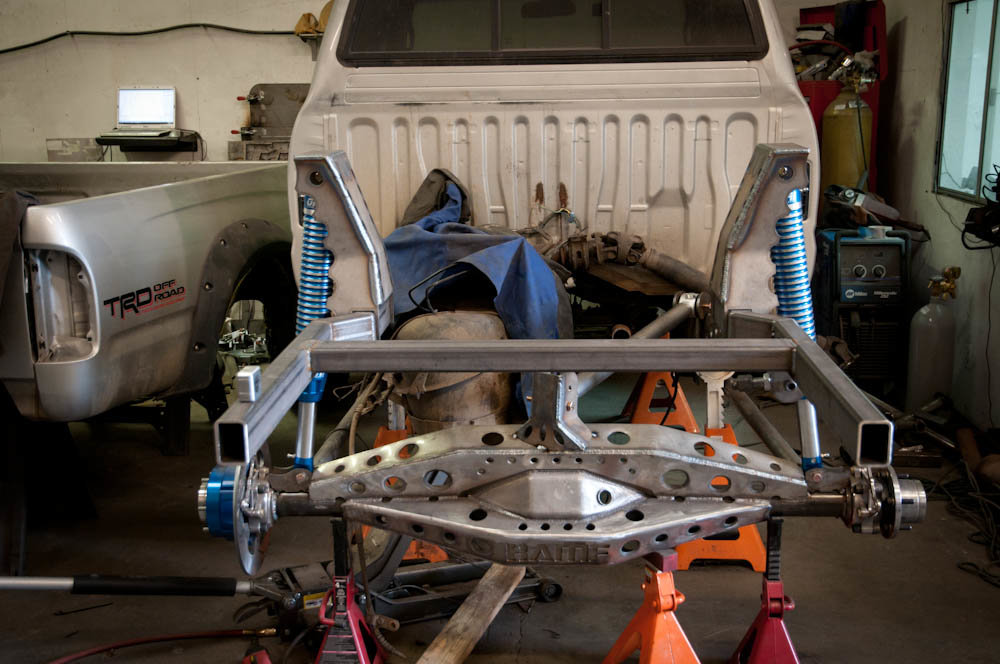

    I'm also going with CV shafts so the pinion angle is going to be set at 0 degrees to the drive shafts.

    Oh ok. It just looked like it was set way too high for normal u-joints but I figured you had to have a reason for it lol. Are the CV's going to be as strong as the u-joints? I don't think I've ever heard or seen of anyone putting them on the drive shaft.

    There not CV's. Its the slang term for a double cardan joint driveshaft.

    Yeah there is plenty of room for the links and the frame. I might have to make a custom rear slider leg so the lowers don't hit it at full bump. And do some more bed side trimming.

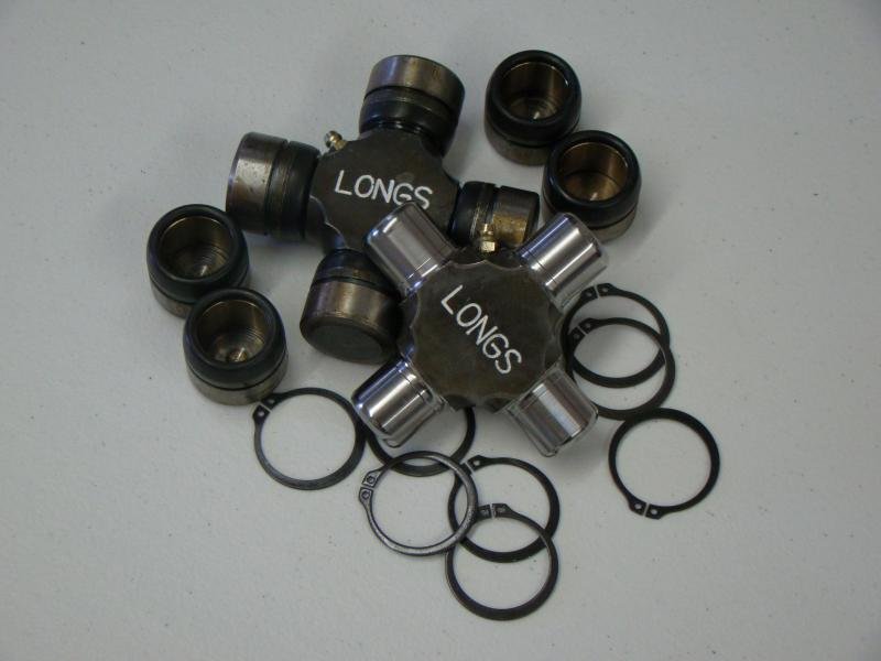

    Just picked me up a set of these bad boys :cool:
    $200.00 each :eek:

    At least thats cheaper than CTM's or Yukon Super Joints...non-greasable Spicers for me...plenty strong for 37's according to ECGS.

    Yeah I was tossing out the idea of CTM or Yukon and decided to go Longs. There has only been 3 reported broken joints according to Bobby and that was the first batch and that's good in my eyes :D. I don't think I'll ever brake these.

    I might look into these if I break stuff. Maybe sprinkle so Chromo fairy dust around the truck. :D

    I was talking to Bobby a couple years ago and told him I broke his u-joint... "Hold on I need to sit down for this... Did you just say you broke my longfield u-joint?" Oh.. no I meant the caps got ruined.. "Oh I was about to call the press to come to your house and congratulate you on breaking them"
