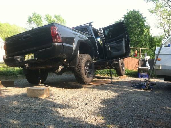

    Josh which 10 holes had to be drilled out the bottom 5 on each side? & how long was total time to ship/get to you? They look nice bolted up.
  3. May 26, 2011 at 6:13 PM
    #43
    JLink
    JLink [OP] Well-Known Member
    May 9, 2010
    #36795
    12,582
    Josh
    Ocean, NJ
    Lifted, Locked, Armored. Ready To Wheel.
    There are 10 holes on each side. 5 are already there, in the vertical part of the frame. The 5 that need to be drilled are for the bottom side of the frame. The sliders basically have L brackets that need to be bolted horizontally and vertically to the frame. I used a floor jack to push the drill up and it worked like a dream. I ordered them April 15th, and got them May 24th
