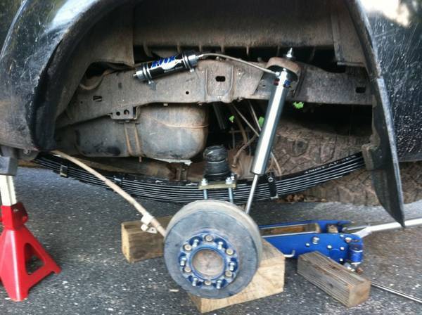

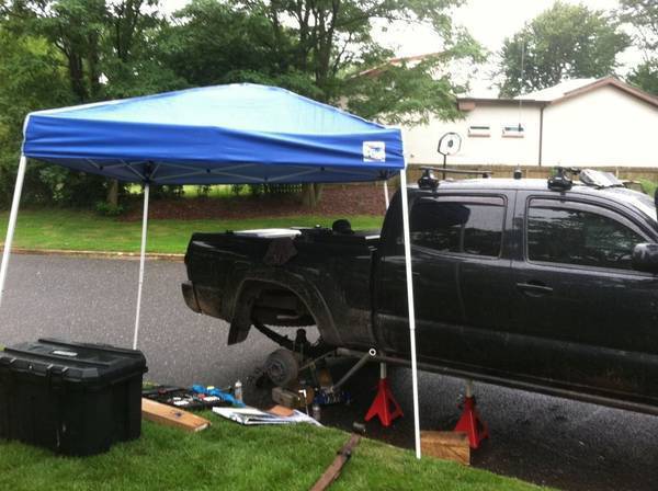

    Last night I got the passenger side rear suspension swapped over to an all pro expo leaf pack with u bolt flip kit and timbren bump stop, as well as the fox remote resi shock. Got started on the driver side too but a bad ass storm blew in before I could get the old leaf pack off. Heaviest rain Ive seen in a LONG time.

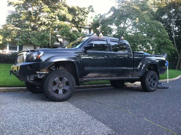

    ^ Working in the rain...
    ^ All pro expo leaf pack, All pro U bolt flip kit with timbren bump stops, fox extended travel remote resi shock
    ^ all done!! so much better with the bigger lift in the rear. Bro lean is mad dumb...
