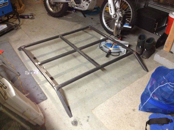

    So I pulled the diffs, shipping them to east coast gear supply monday for 4.56's and a front arb locker to match my rear arb locker.
    Also sending the CV's to CVJ axles to be remanufactured. 90k miles on them so its time for some maintenance.
    Last week I bought some metal and built a bed rack for my roof top tent. I used 2.5"- 3/16" thick angle iron for feet, and 1.25" 14 gauge (0.83 wall) square tube.

    Looks good josh! Is it shorter than you tent? If it is then your good if not you might want to add another support across just so you can use the clamps on the tent

    Tent overhangs 4" on all sides. Tent iirc is 48x56 and rack is 40x48

    Perfect! Nice job! I have to add extra supports because my tent is like 3 inches to short on the bedrack :eek:
