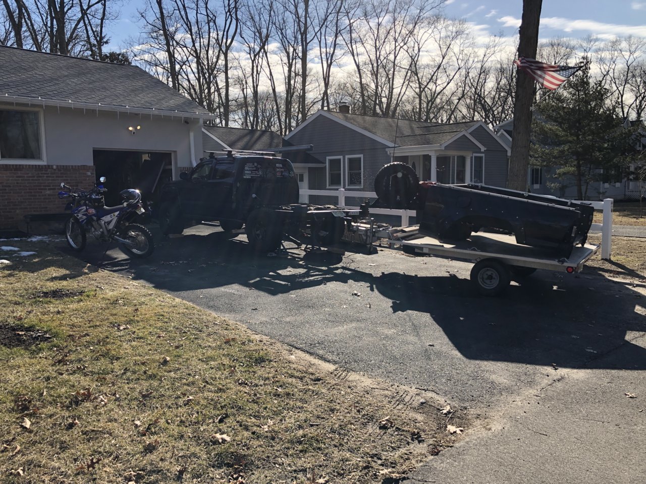

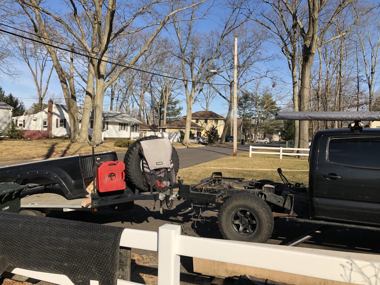

    Getting the bed off was a real pain in the ass. Ended up having a coworker swing by with the bucket truck to lift it off.
    I also pulled the 3rd member to send to ecgs to replace an air seal. That ultra grey rtv was really holding it tight.

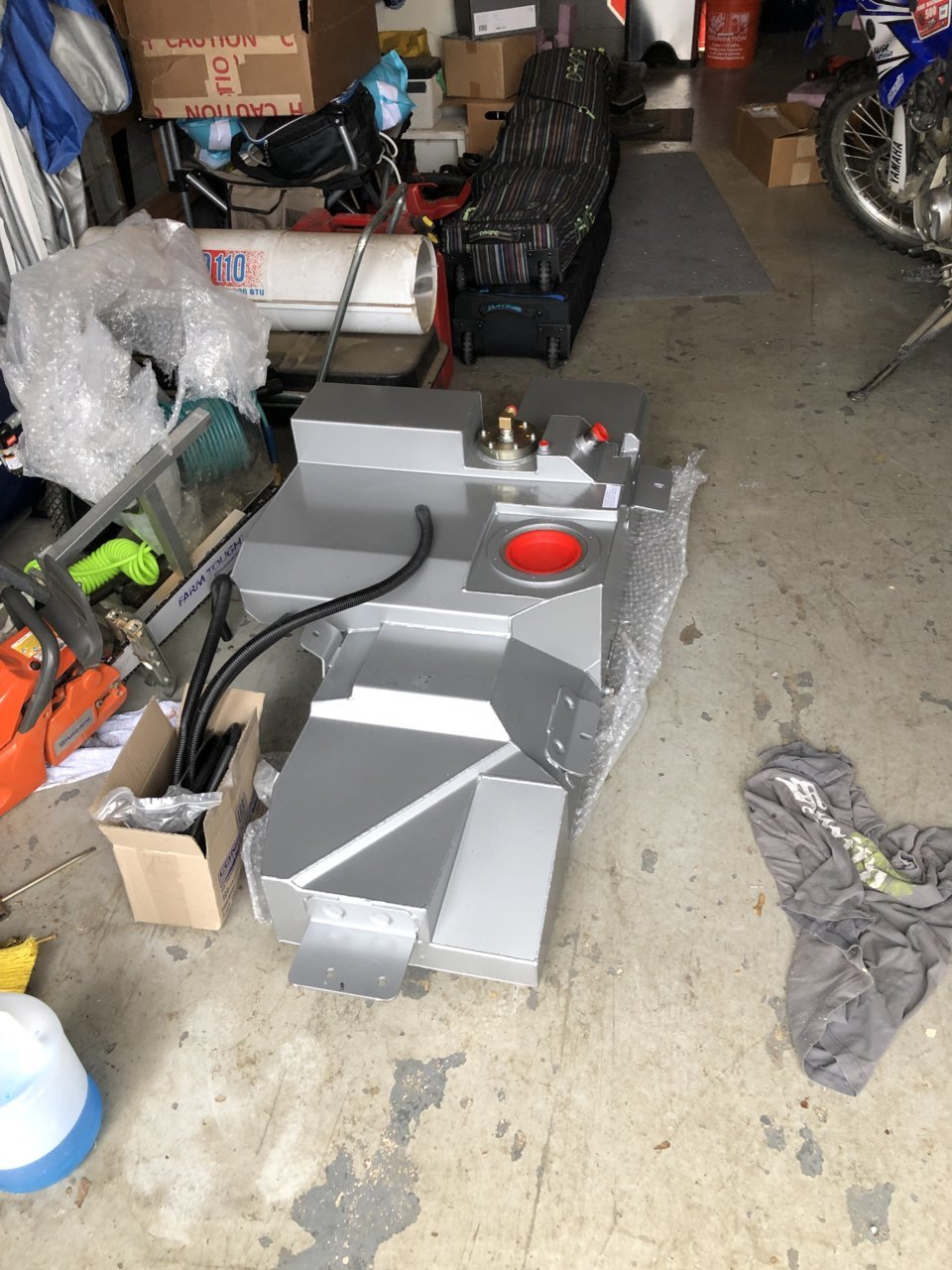

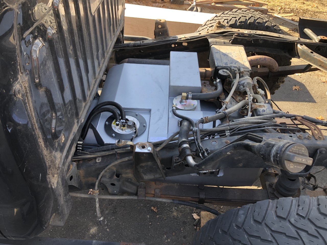

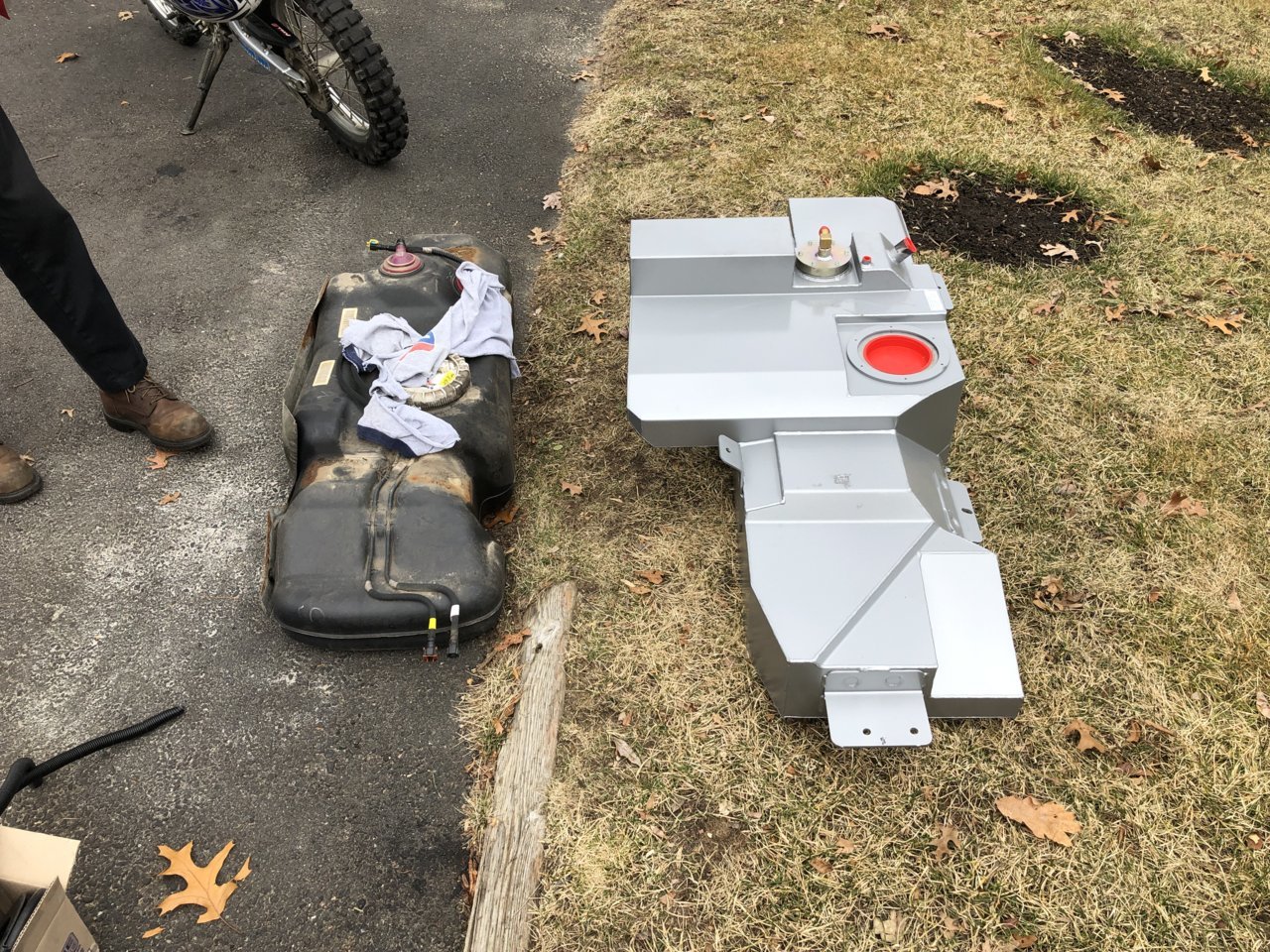

    Got the new tank in today. Poured 3 gallons into it and let the truck run for a little while. All seems good so far. Going to double check all the connections and bolts tomorrow and then put the bed back on.
    Sucks only being able to work on it before work at 3:00.. work always ruins everything.. :p
    Had a bolt break while trying to remove the old tank. Rear driver side strap bolt. Had to cut the box open and remove the bolt with vise grips, then welded the box back together.

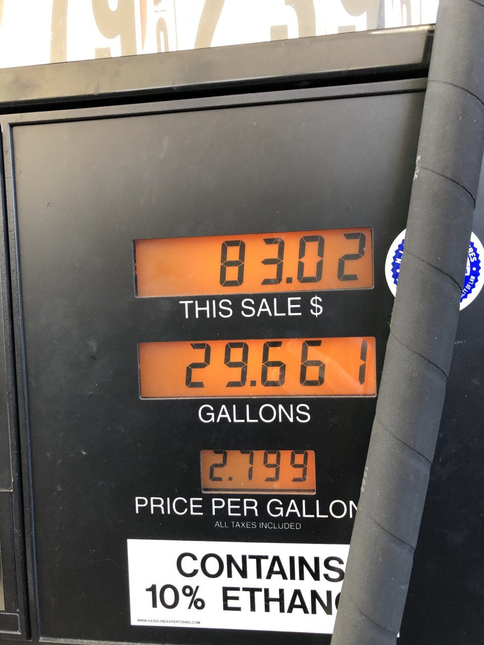

    Ok so the tank is in and it has officially been filled. No burping issues. Took 29.6 gallons.

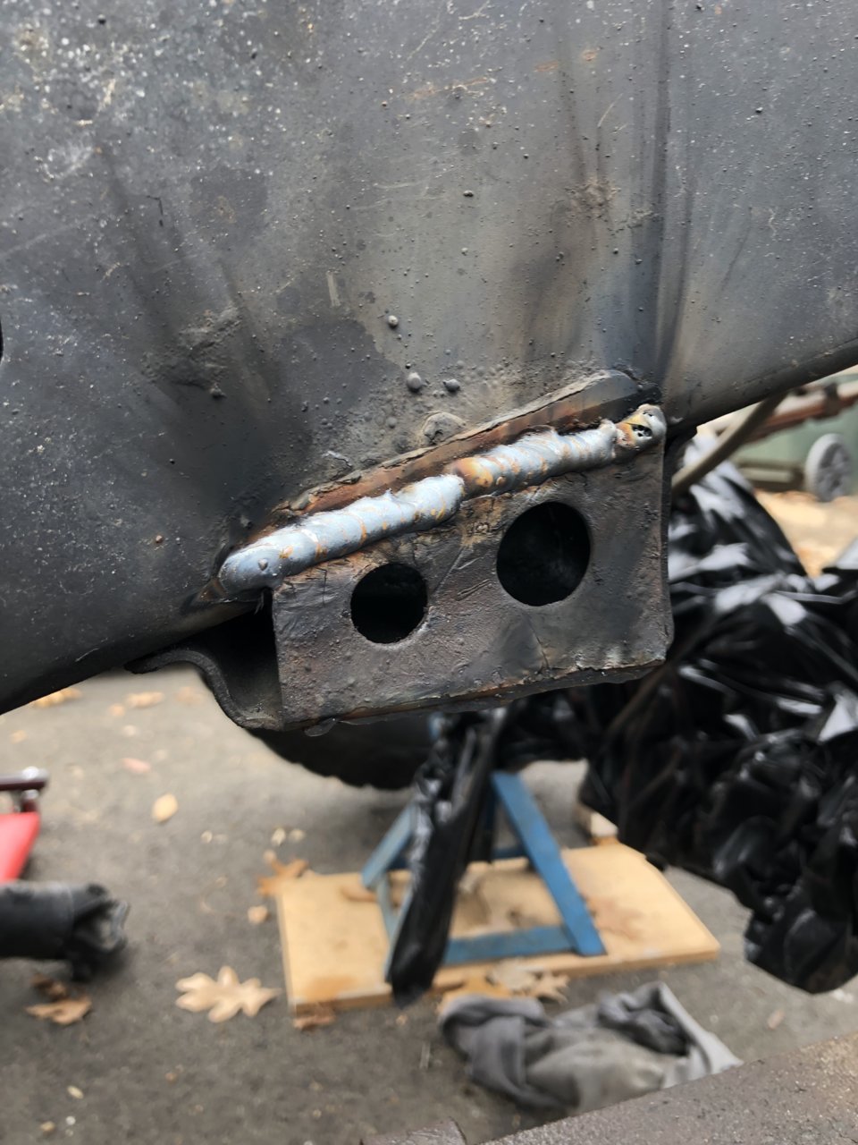

    Plan for tomorrow is to mount the shocks and weld on the ruff stuff resi mounts.

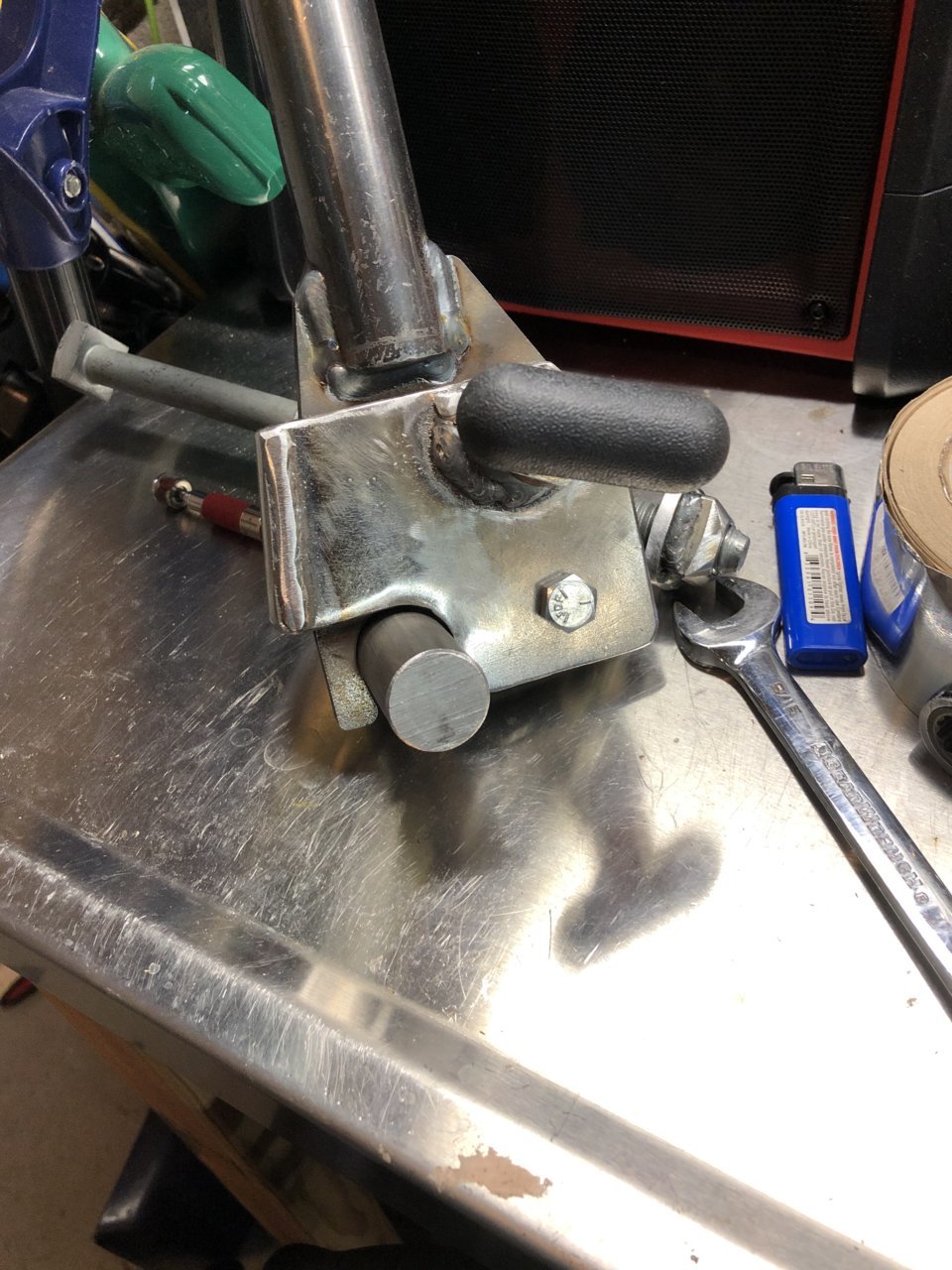

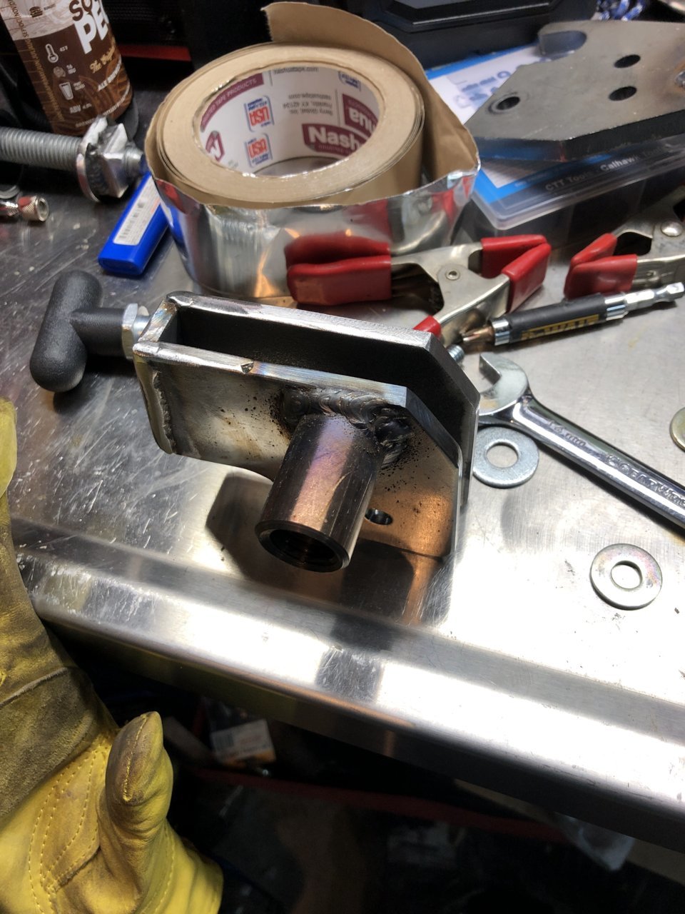

    Ive also been working on a 4x innovations latch for my swingout. There was no way to use it the way it came, but after some modifications, it’s getting there.

    Thanks. My CBI rear bumper has a big hand screw to hold the swing out closed. I’ve never been a fan of it, so now 6 years after buying the bumper, I’m finally doing something about it.

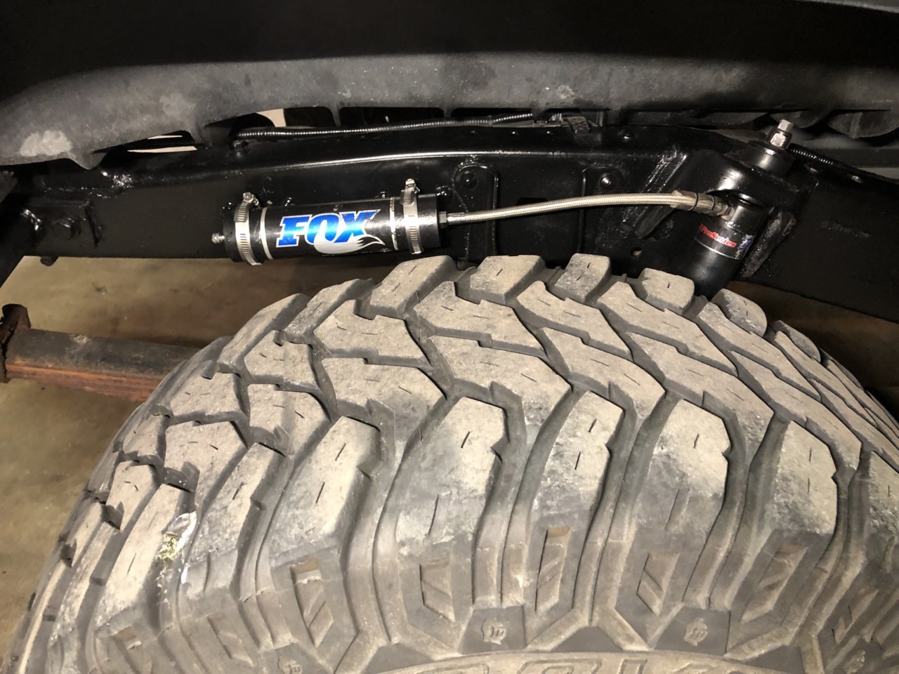

    I swapped out my rear shocks today and welded on the ruff stuff resi mounts. Didn’t take any pictures during the process, but here is the finished product. ED14F767-363E-4170-A861-9822AC7FF32D.jpg

    Looks good! You like those resi mounts? Was looking at them when I redo the rear.

    I’ve always thought they looked a lot more professional than the clamps and self tapping screws that came with my shocks originally. For anyone that can weld halfway decently, I think they’re great.
