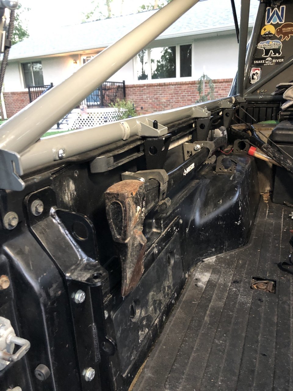

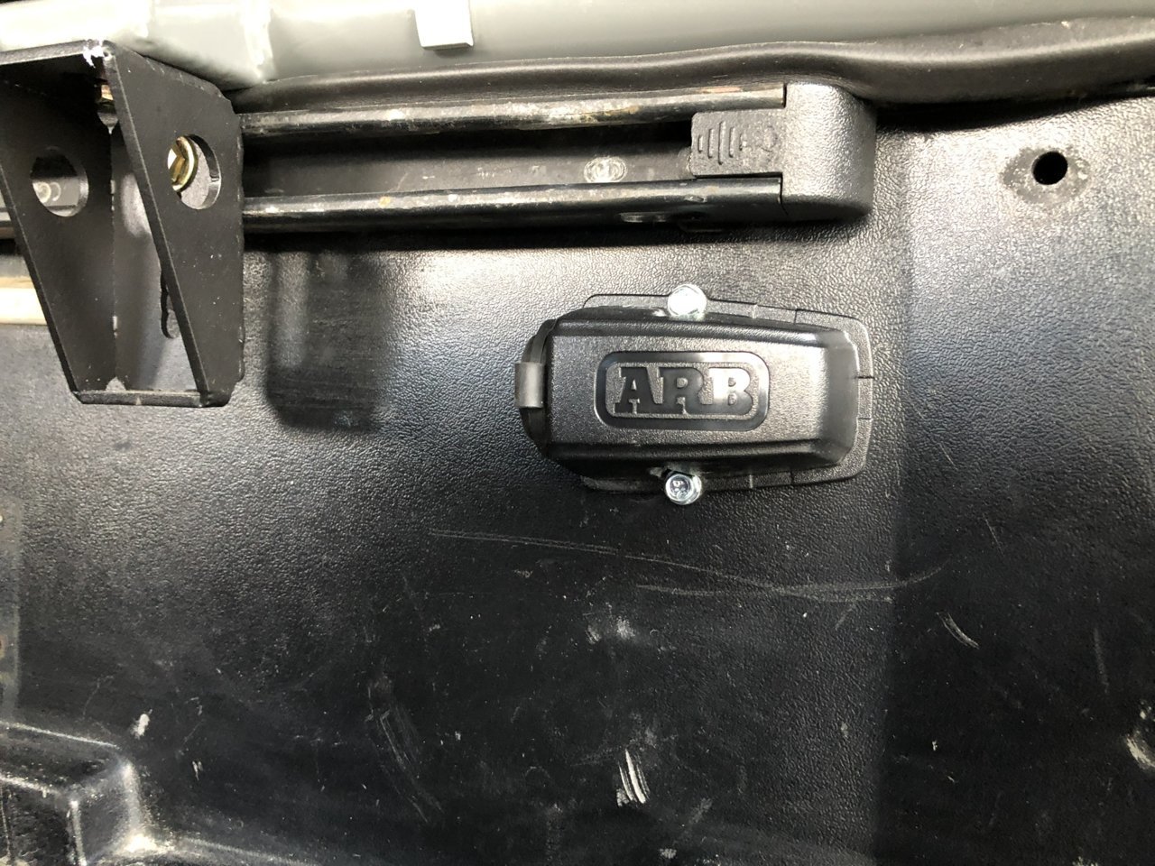

    I’ve been working on a blue sea 6 circuit fuse box sub panel mounted in the bed. I ran 8 gauge wire from the battery, hit a blue sea 40 amp circuit breaker, then all the way back to the bed where one of the useless cubbies used to be.
    So far I have
    -1 circuit for the fridge with the arb screw type plug.
    -1 circuit for area lighting ( 3 Baja designs dome light with switch in amber, 1 mounted on each panel of the gfc)
    -1 circuit for a Baja designs s2 sport mounted on a telescopic mount on my rear bumper
    -Planning on a circuit for “upstairs” lighting in the gfc, maybe power too. Phone chargers or a fan could be nice.
    -Probably going to add a blue sea USB port in the bed eventually.

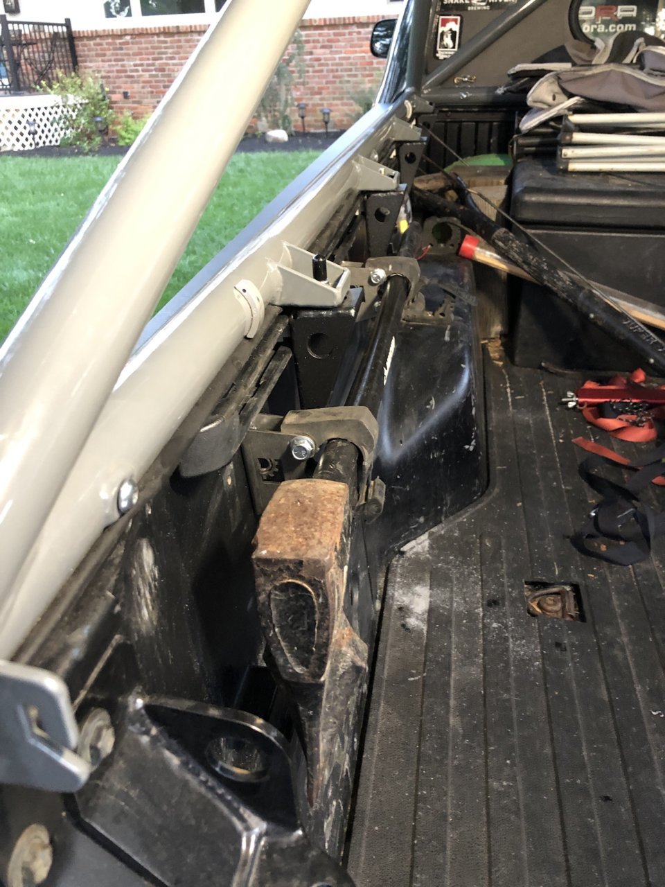

    I also added some quick fist mounts from built right fab. They hold the quick fist so much better than the single hole that comes with the quick fist.
    Before:
    After:

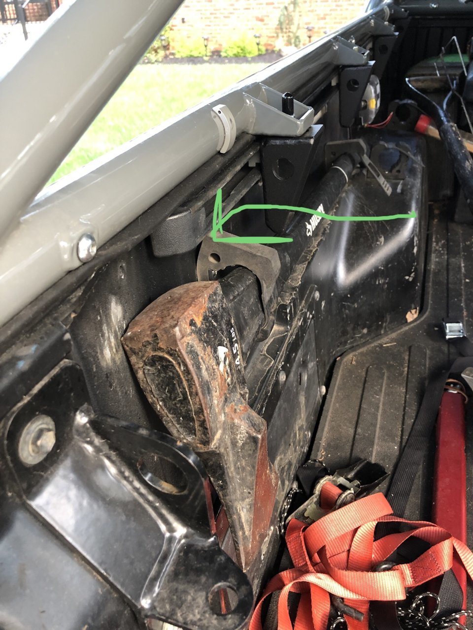

    F.U> GUYZ
    broken mods
    ALL I WILL SAY IS THE RIGGING IS STRONG IN ONE OF THEM PICS....
    CAN YOU EVEN SWING THE HUSKY BRO

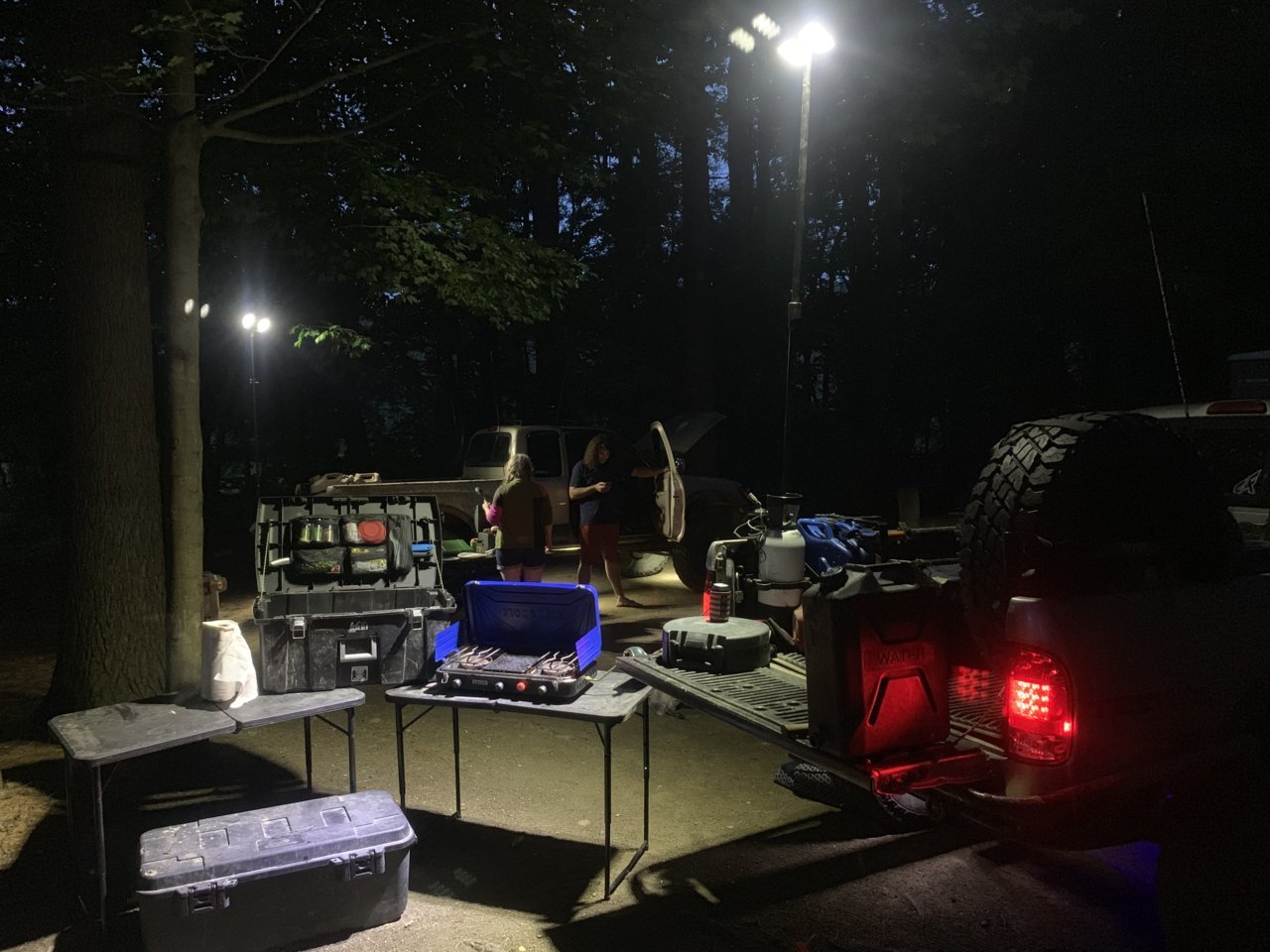

    Who is this guy? :brianr:
    I’m guessing Chux was talking shit about camp lights or something? :p
    Same mount I’ve had forever but I finally got sick of replacing Amazon cheapies and got some real lights.

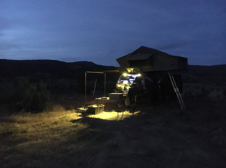

    All the light:
