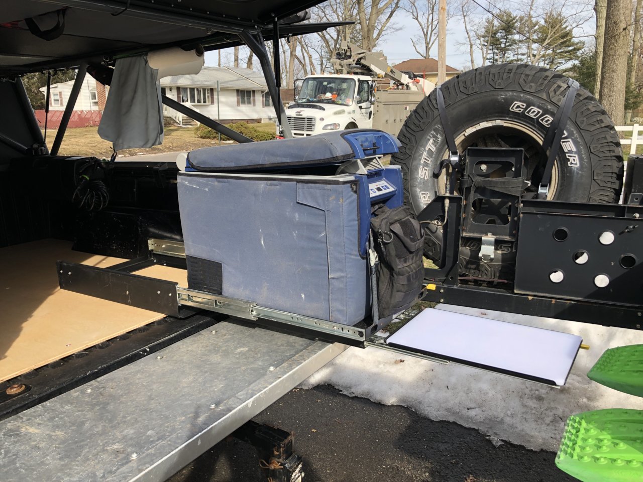

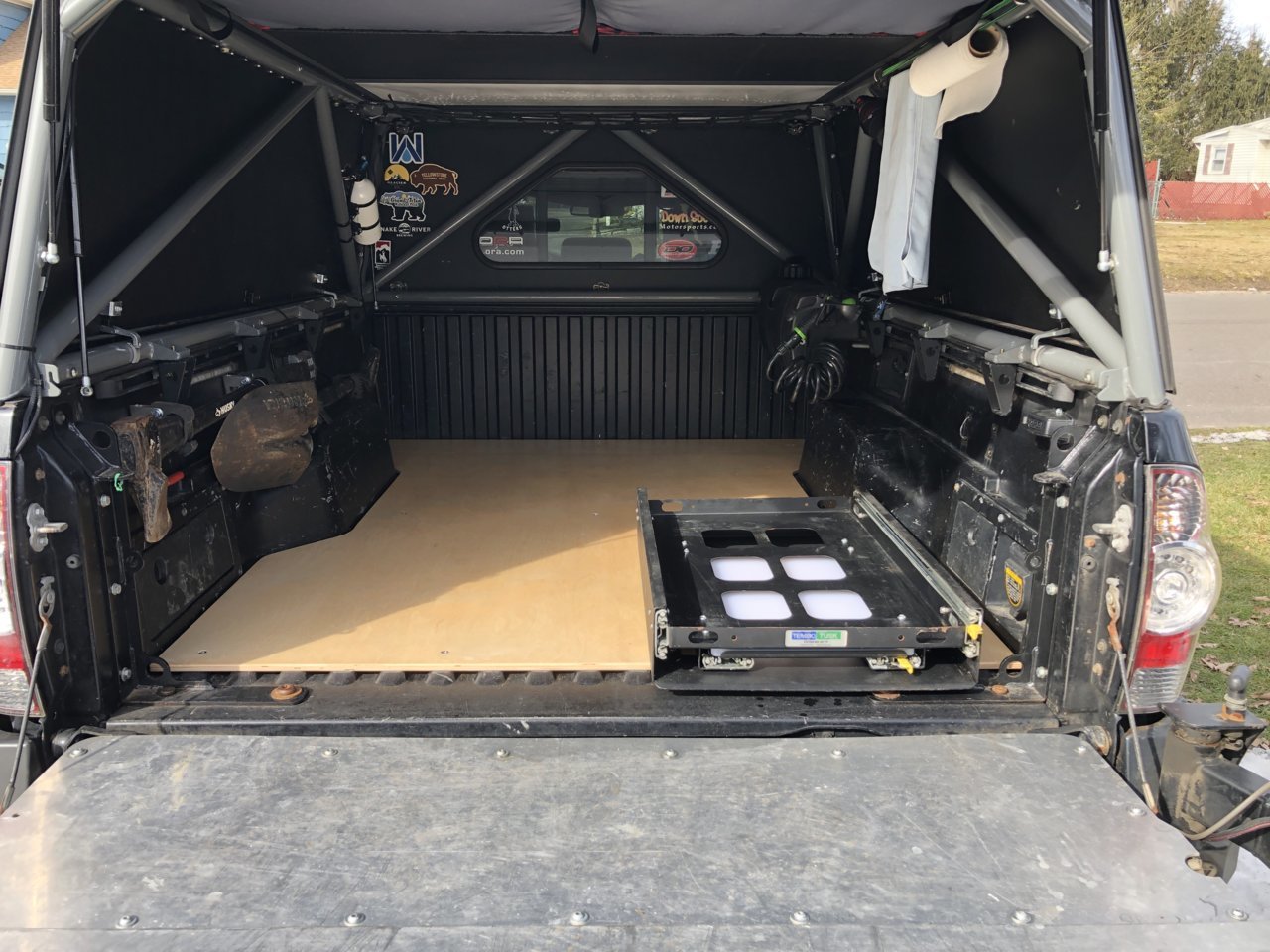

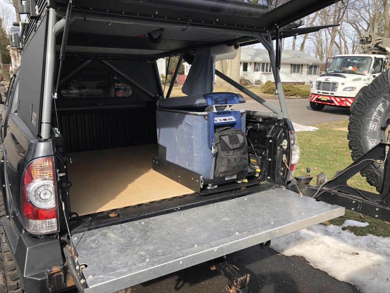

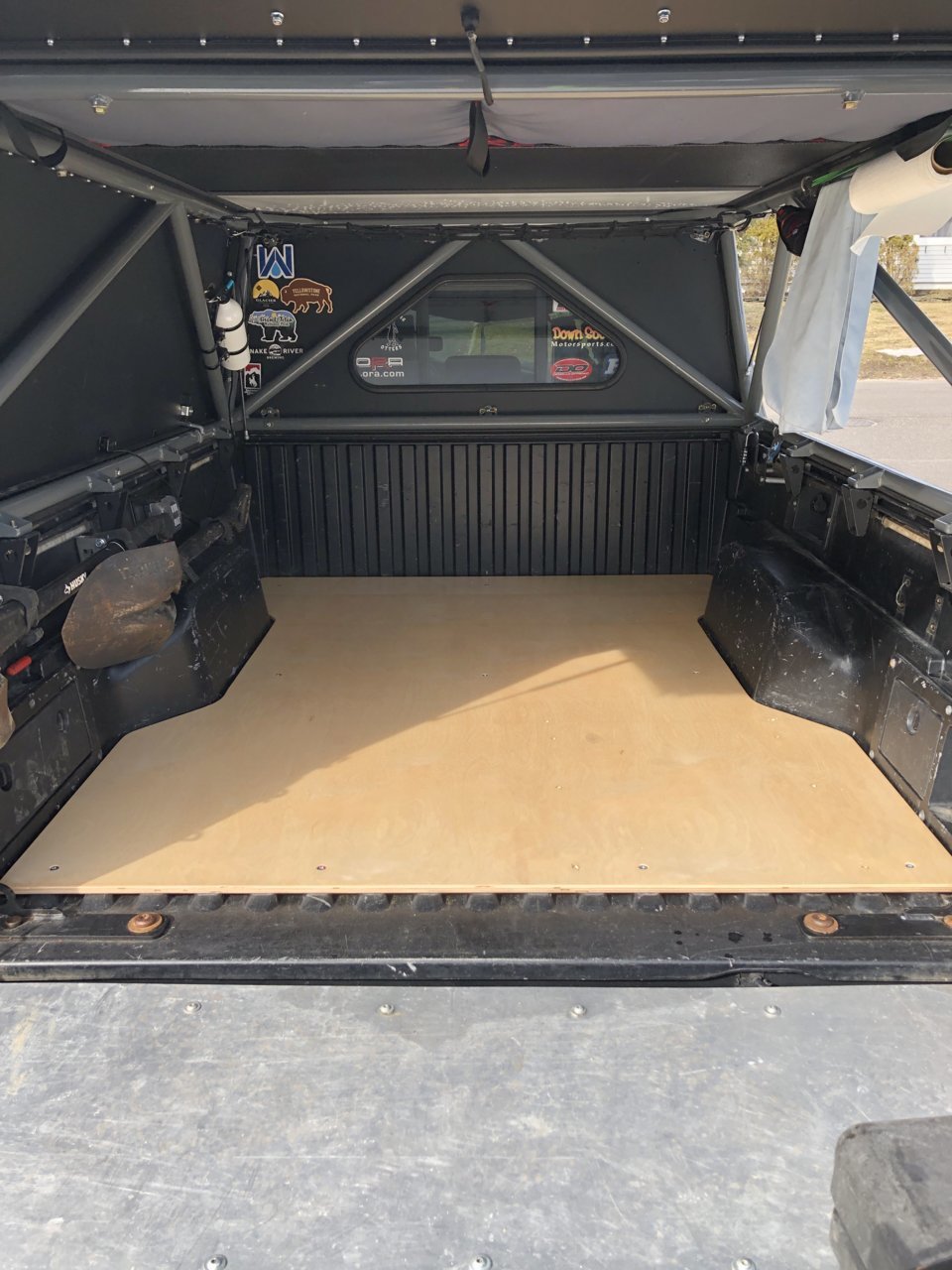

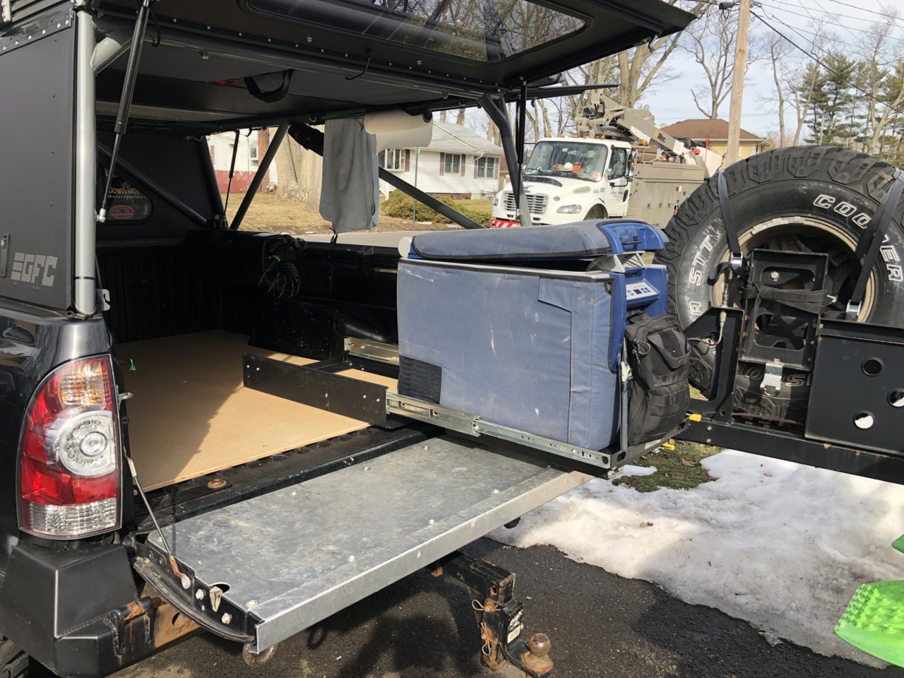

    Working on building out the bed a little bit. Cut a baseplate out of 1/2” Baltic birch plywood. It got 4 coats of total boat halcyon marine varnish. It’s attached to nutserts in the bed. The fridge slide is attached with threaded inserts.
    Next is the drawer.

    Im planning on using some L-track to attach my fridge slide. I have a piece of 1/2" wood on the passenger side now, but still looking to decrease weight. The L-track will provide tie down options, and ability to remove the slide and other storage stuff that I have on the passenger side.
    Im also planning on making an aluminum panel for the front of the bed, where Ill build out my second battery and bed electronics. Nothing fancy, just a DC-DC charger and some bed lighting. But my fridge will plug into that battery.

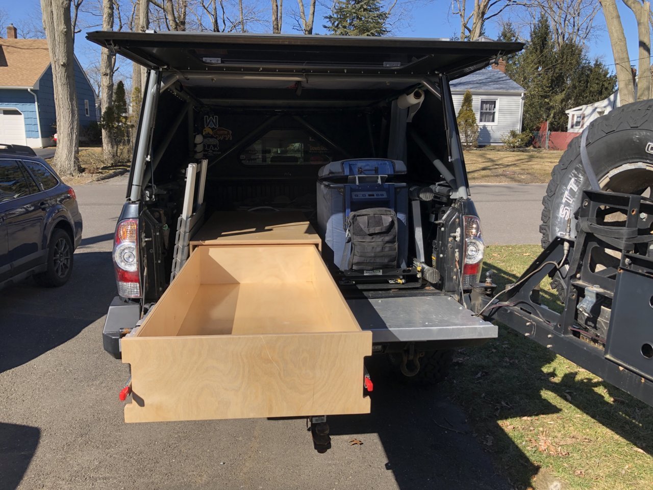

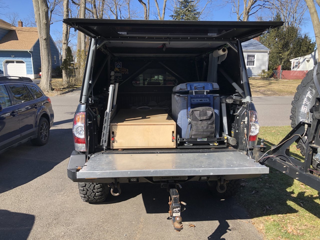

    here’s my progress on the drawer. Still waiting on L track for the top. Went with flanged (recessed) from macs tie downs. I’ll need to remove the drawer box from the truck and route grooves for the L track to fit into.
    I’m thinking I’ll layout what I plan on keeping in the drawer, then screw in some dividers. Thought about routing slots every 6” for easily adjustable dividers, but I don’t think that will be necessary.
