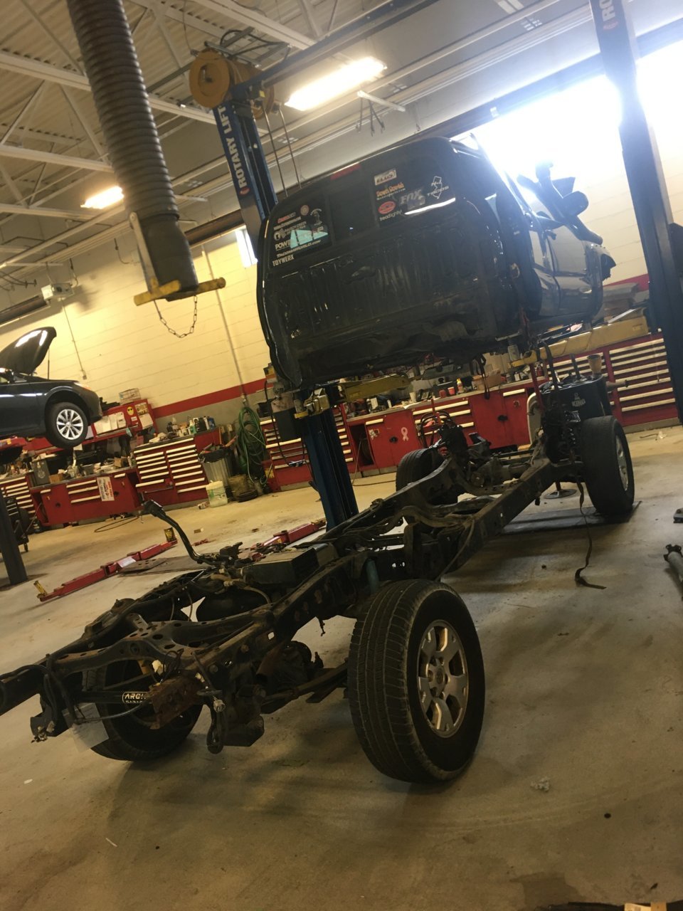

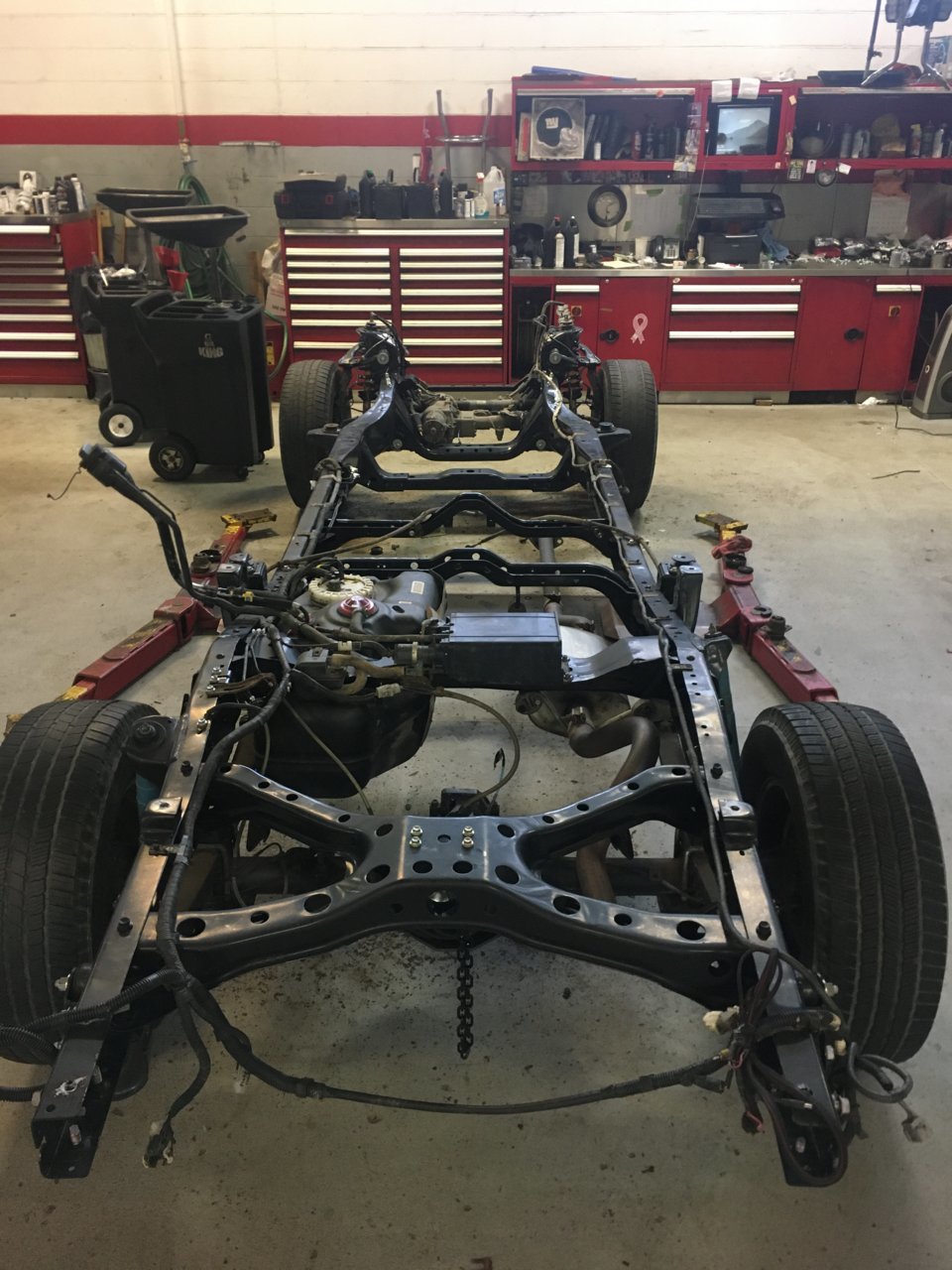

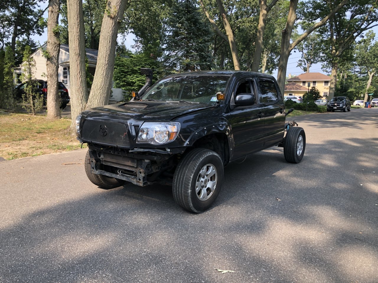

    Well the Tacoma is supposed to start it’s frame swap today.

    I wish I had gotten updates like that.. or gone to watch

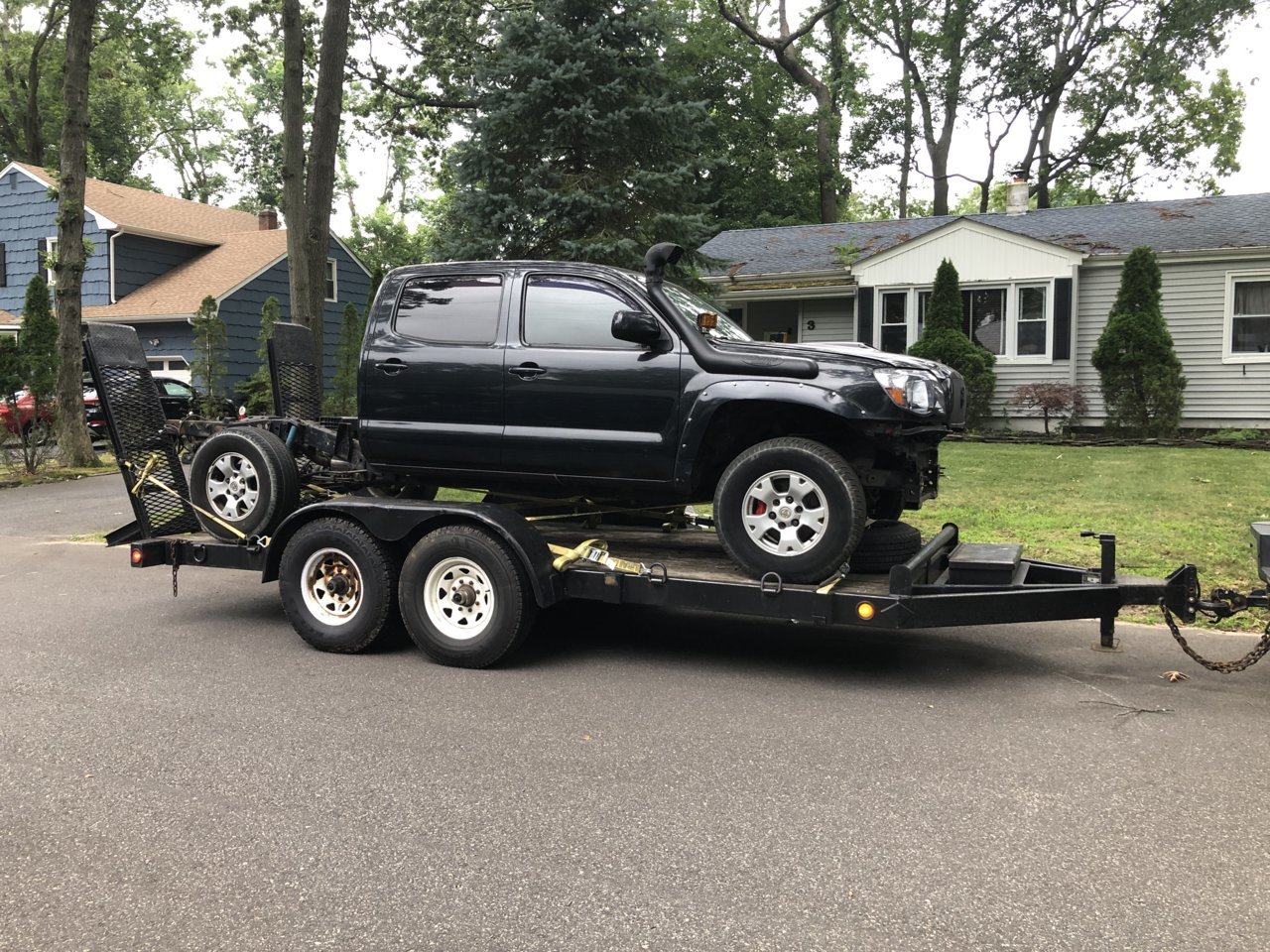

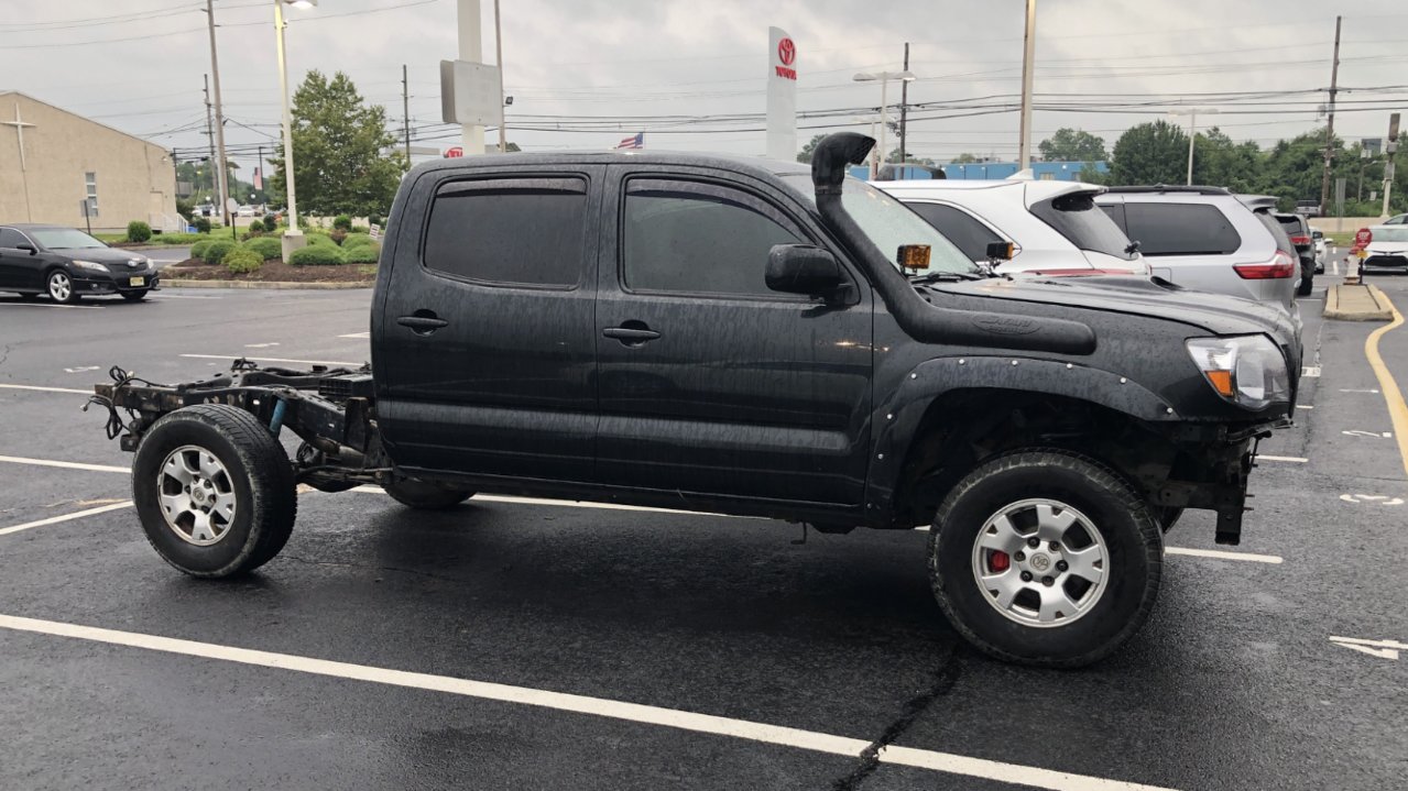

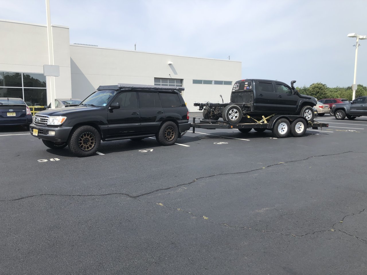

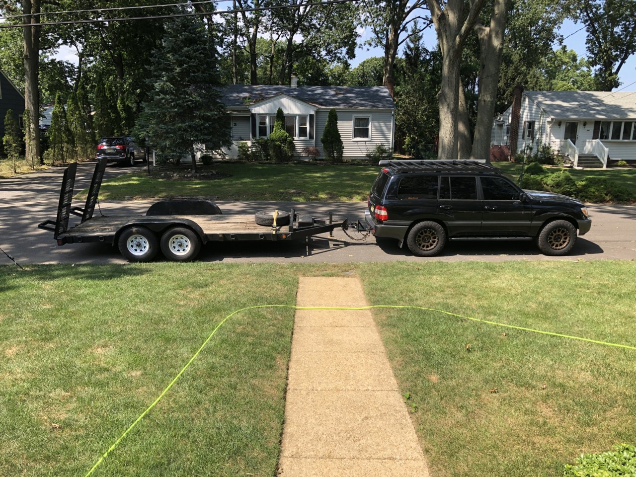

    The updates are coming from my brother in law who is a salesman there. I just finally “talked” to the tech for the first time today when he texted me saying the truck is done.
    my father in law (who owns the truck and trailer I used to drop off the Tacoma) can’t help me pick up the Tacoma till Thursday, so I’m going to try towing it with the land cruiser tomorrow.
  10. Aug 7, 2021 at 1:13 PM
    #1690
    JLink
    JLink [OP] Well-Known Member
    May 9, 2010
    #36795
    12,582
    Josh
    Ocean, NJ
    Lifted, Locked, Armored. Ready To Wheel.
    Got it home!

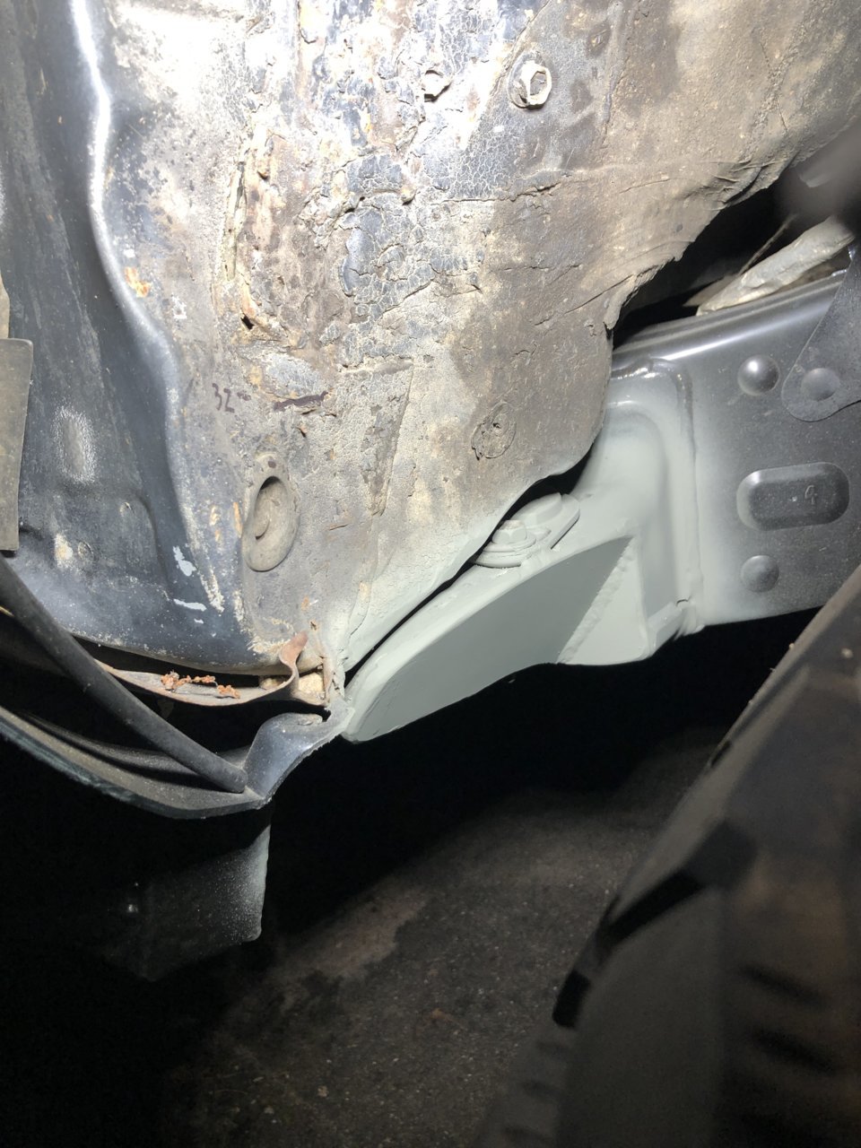

    Got the shackle hangers off yesterday. Air hammer with a rivet cutter chisel took the rivet heads off, then a pencil point punch to push them through the frame. Way easier than grinding or drilling. It was raining so I didn’t do anything else.
    Today I cleaned up the frame where the old hangers were. Sprayed a coat of self etching primer, then wool wax, then mounted the hammer hangers. It was humid as shit so that’s all I got done. Oh I also cleaned up the u bolt flip plates and shot a coat of primer and paint on those and the new u bolts.
    hopefully the weather will be good for the rest of the week so I can make some progress.

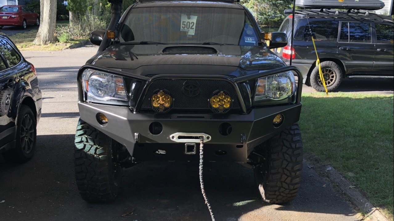

    Haven’t updated in a while.. it’s been taking a while to get anything done.
    bumpers got sand blasted, primer, paint. They both needed some work. Rear needed some plates added where rust had eaten away at it. Front got a 2” receiver hitch and some grille/headlight protection. Also just did the cab mount chop and plated it.
    Still have a few things left to do, but it’s almost done.

    Full hoops came out awesome dude.

    hoops turned out tits!
