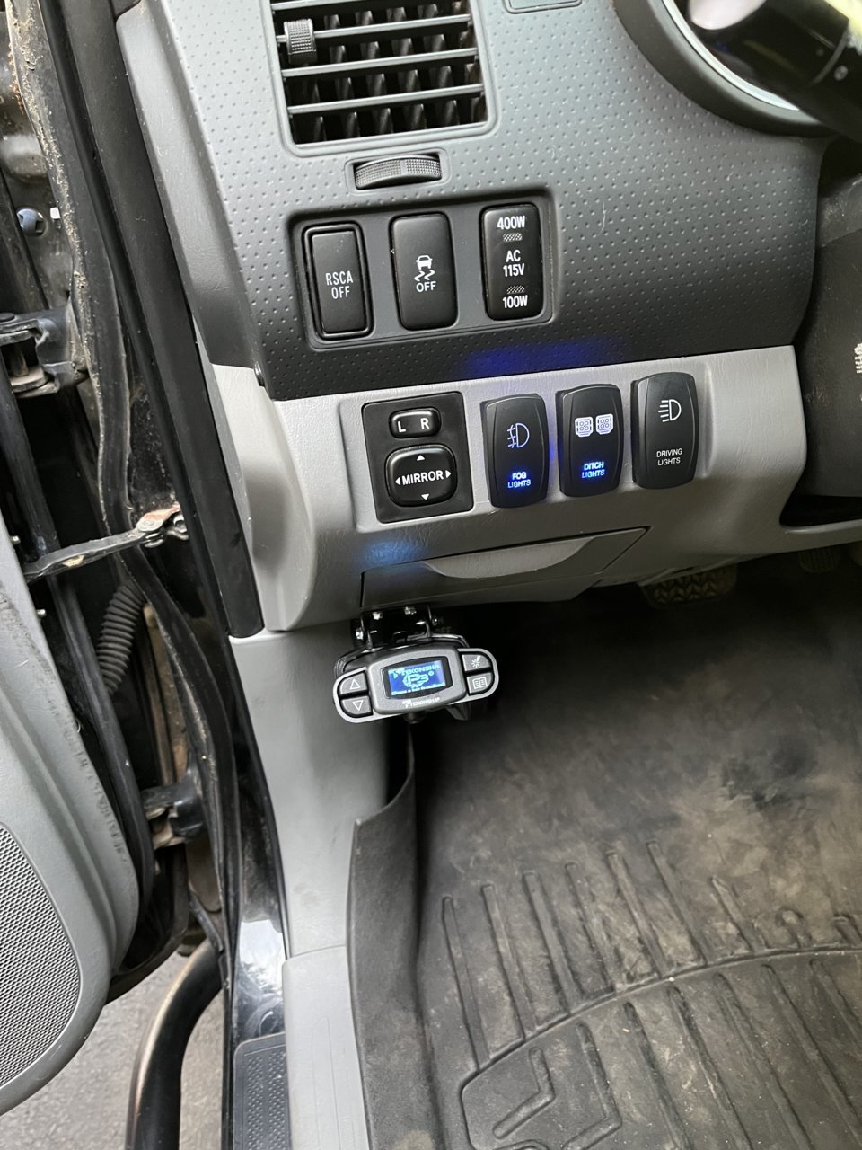

    Added a trailer brake controller. The Tacoma and the land cruiser both have a factory connector behind the dash. I ordered 2 of these adapters https://www.amazon.com/gp/aw/d/B004WLL0OI?ref=ppx_pop_mob_b_asin_title
    and the tekonsha prodigy p3 https://www.amazon.com/gp/aw/d/B000P17NXQ?ref=ppx_pop_mob_b_asin_title
    And a spare mount https://www.amazon.com/gp/aw/d/B016MXD9TM?ref=ppx_pop_mob_b_asin_title
    so now I can swap the controller between vehicles just by unplugging the wire harness from the back of it and unclipping it from the mount.
    my plan is to add trailer brakes to my aluma a888 atv trailer because the Tacoma is scary to try to make an emergency stop if someone slams on their brakes in front of me. Too many close calls already. Plus, we’re looking at getting a camping trailer and I would feel a lot better if that has trailer brakes too.
    Also, I have had an intermittent P0420 check engine light. I had my mechanic at work hook up a computer and read the o2 sensors. The bank 1 sensor 2 was not following the correct wave form, so I replaced that. Since it was intermittent, it will take a while to know if it did anything, so I need to get him to read it again and see if it looks better. I ordered an o2 sensor socket, but didn’t feel like waiting for it to get here. I found that the plug end of the o2 sensor fits through the box end of a wrench, so that made it pretty easy. Had to drop the transmission skid plate though.
