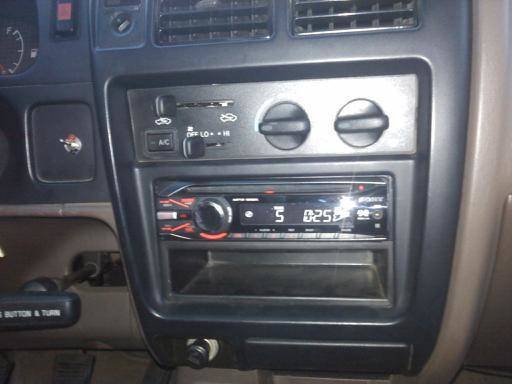

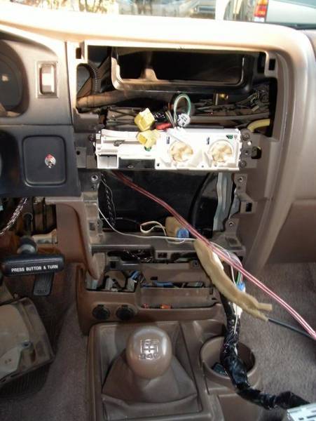

    first mods i did was the sound system

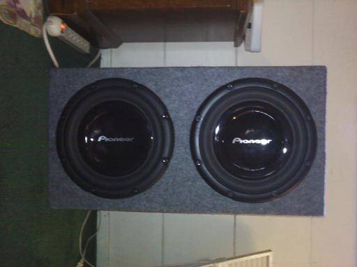

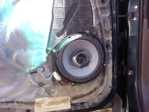

    parts installed were:
    sony head unit
    pioneer 6.5's all around
    rca level control knob
    efx amp for subs
    remote toggle switch
    pioneer 12" subs in custom box i made
    heres some pics :)

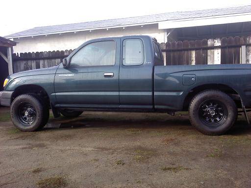

    next mod was rims and tires and soon after was the lift because of major clearance issues due to my mistake :eek:
    rims are pro comp steelies series 52 with bfg radials(got them for free) :D

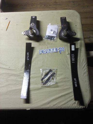

    fabtech spindles and aal by pro comp
    daystar polyurethane coil spacers
    more pics :rolleyes:

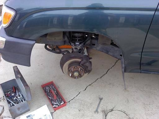

    juset had gotten back from 4wheel parts :cool:
    ready to tear everything down for spacers and spindles

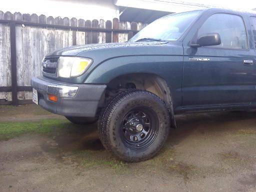

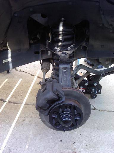

    here it is with everything installed. sanded down and painted the hubs because the were rusty and the center caps held in moisture
    rocked it with the bro lean for about a week because of the rain. looked pretty sick :D

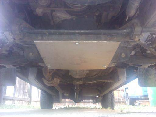

    next was a stainess steel skidplate to protect oil pan when wheeling

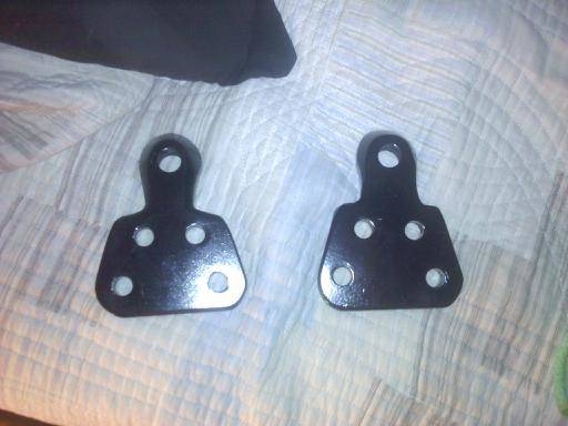

    after seeing lots of reports on here and customtacos of broken lower ball joint brackets i decided to fab up some beefy replacements. thanks to chris(Tacorunner87) for the colled rolled steel he got for me :D
    i cut everything up with a grand total of 8 cutting wheels for my grinder and drilled it out on my drill press with a stock one as a template. here they are all finished up.
    next mods are moog ball joints up front to go with the brackets and stock replacement chromoly uca cross shafts. new set of coils. then ill install my icon aal pack and install my all pro brake line :D stay tuned lots more mods to come :cool:

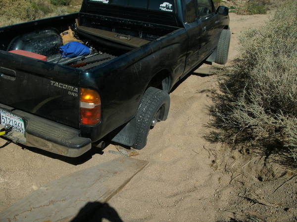

    next pics are from my first true off roading trip where i actually used it to where i knew i wouldnt break something but still ended up with bent uca cross shafts :(
    after we got stuck we decided to shoot a little while with the 22s and shotguns :D

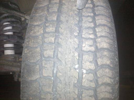

    aftermath of the bent uca cross shafts all 4 tires are wearing like this because i have to rotate them so much :(

    Looks good man! I like your sound system set up.... Rotate those tires ASAP lol...what do you have in mind for your next tire set

    haha i already did rotate them :eek: all 4 are like that tho lol. im still not sure either general grabber at2's or bfg all terrains.

    Did you make that skid plate?....how did you cut it?

    yeah just cut it 16x16 with a grinder and a few cutting wheels lol then drilled it out and bolted the plate to the 2 cross members :D

    That bass knob location is tight lol

    lol yeah it fit in there perfectly too all i had to do was clearance out the brace behind the dash :D
