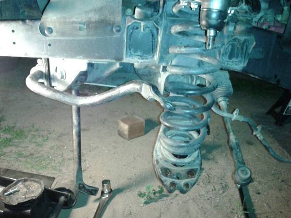

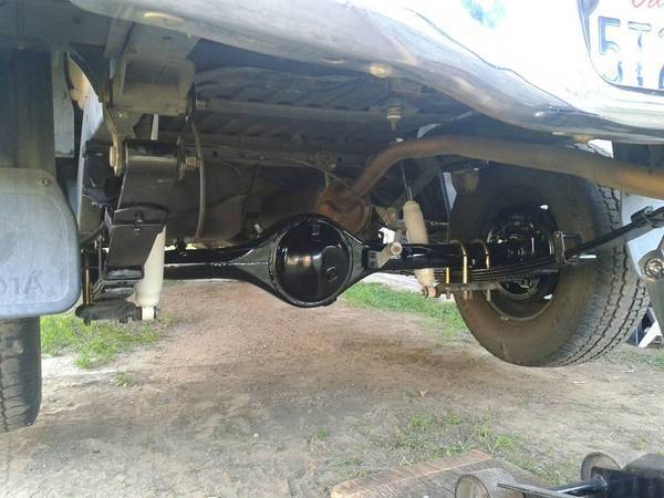

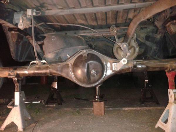

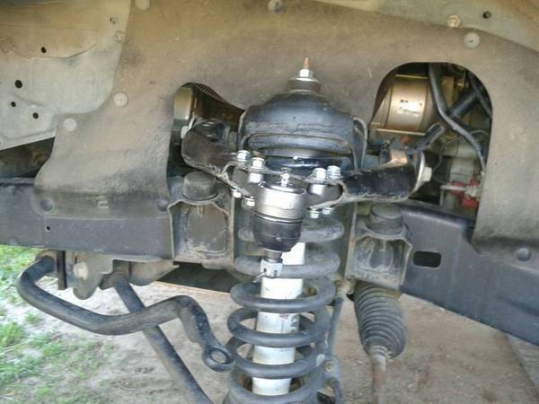

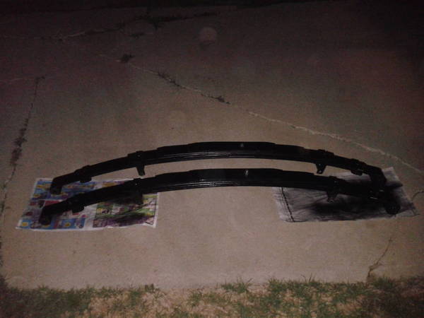

  17. Mar 5, 2012 at 12:11 AM
    #57
    Joels98taco
    Joels98taco [OP] Well-Known Member
    Mar 10, 2011
    #52782
    2,220
    joel
    chino hills
    98 5 lug tacoma
    fabtech 3" spindles, icon aal, 10" bilstein 7100 rear shocks, daystar coil spacers, AFE Pro Dry-s drop in filter, sony head unit, 2 12" pioneer subs, pioneer 6.5s all around, custom 1.25 lift shackles, custom lower ball joint brackets fabbed by me
    heres what ive been up to this weekend :cool:
    got the axle ground down and prepped for paint
    my icon aal pack and stock leafs painted and ready to go
    got everything back on and together
    got my moog ball joints on
    took the weak lower ball joint brackets off and drilled out the srut rods for the bigger bolts
    there they are ready to roll :D
    took the truck out for a ride. hit a fairly big speed bump at 45 and didnt feel it with the front or rear gotta say im happy with how it turned out :) more pics in the daylight tomorrow
