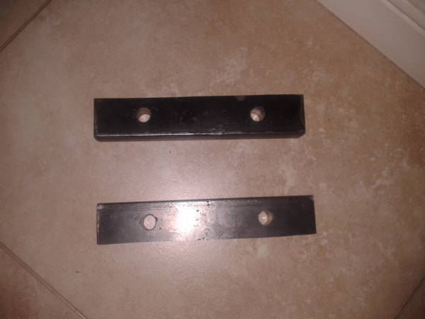

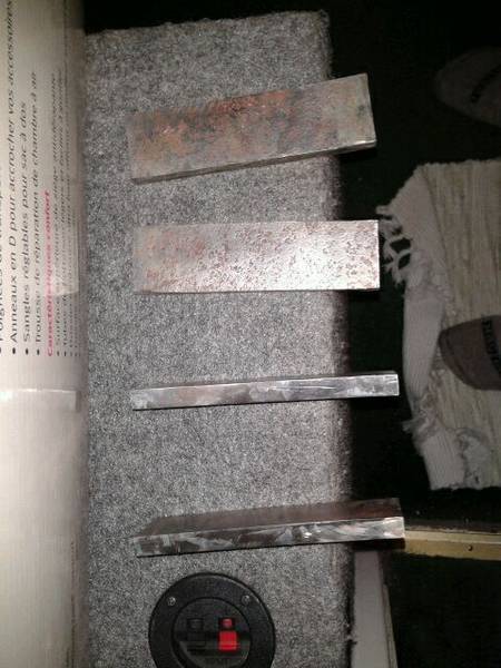

    beefy ass shackles in progress :D

    Folsom
    98 5lug 2rz
    downey mid travel 2wd set up
    sum 12"ers over the frame?

    fabtech 3" spindles, icon aal, 10" bilstein 7100 rear shocks, daystar coil spacers, AFE Pro Dry-s drop in filter, sony head unit, 2 12" pioneer subs, pioneer 6.5s all around, custom 1.25 lift shackles, custom lower ball joint brackets fabbed by me
    no but probably as strong haha 7/16 plate :cool: stock location

    waiting to get my drill bit back from my neigbor then i can drill them out and paint them :D

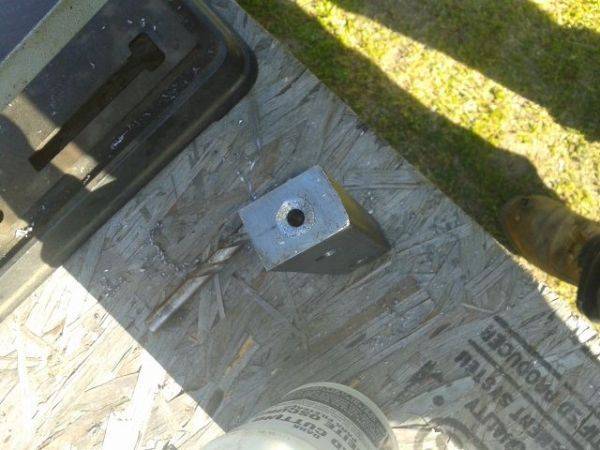

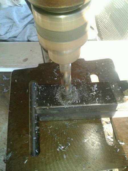

    started my custom cross shafts today
    ordered all the hardware for the cross shafts and shackles. also waiting on the drill bit and tap to finish them off and try them out hopefully soon.

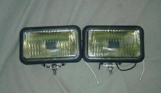

    also went down to hf to get my dust lights

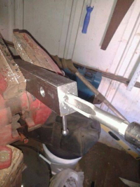

    ok so got all my hardware in the mail today. 5/8 F911 for the cross shafts and 3/4 grade 8s for the shackles. also got the tap to thread the 5/8 into the steel. just need my 17/32 bit and i can start working on my shafts :D

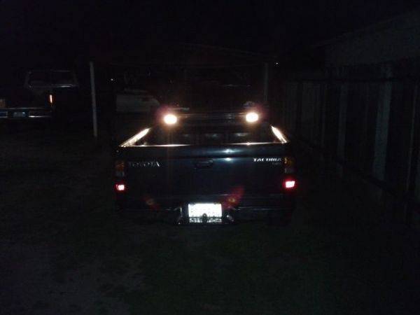

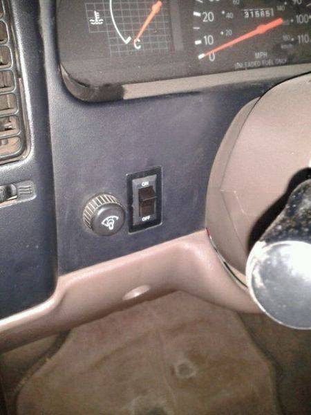

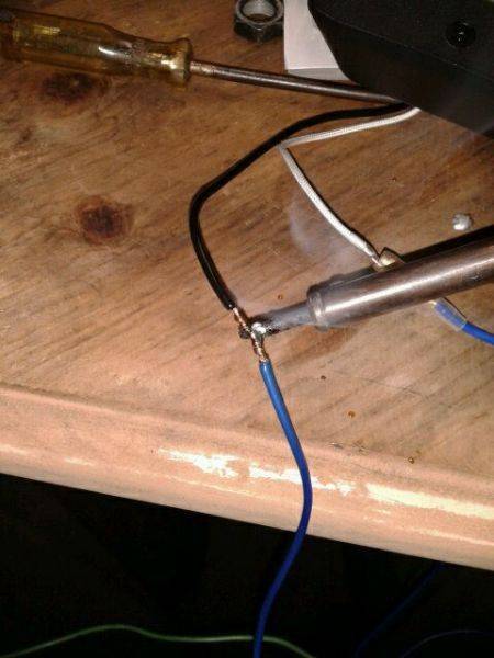

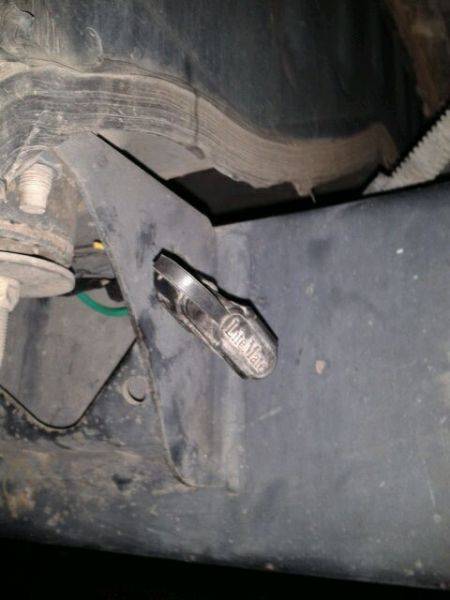

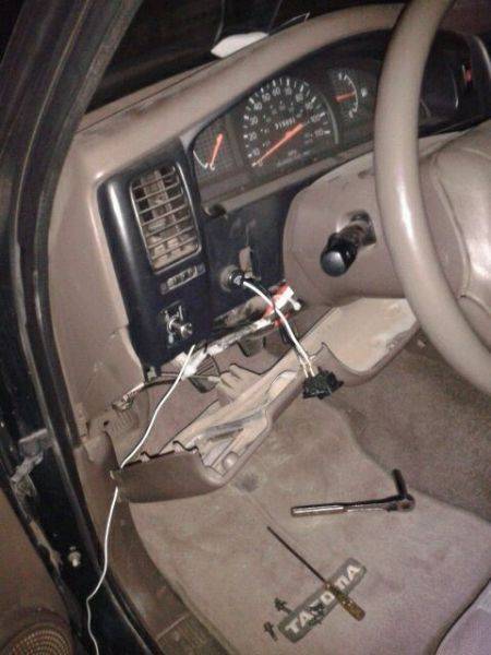

    also got my dust lights wired up
    soldered everything together
    put my power switch next to the dimmer
    used a 4 pin trailer wiring harness so i can remove them whenever i need to. put it right at the body mount

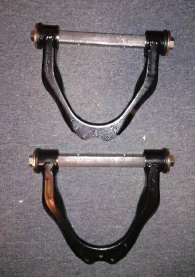

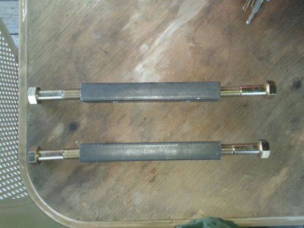

    so finally got my cross shafts done :)

    is there no inner washer? pics of it installed? sup with them shackles? Don't you need an offset shackle plate to cover the widened stock frame pivot width? or are you changing that to? Why not go over the frame? I dig your cross shaft idea man, super simple and beef. Let me know when you start your fab shop, i'll be your fist custi.
