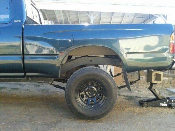

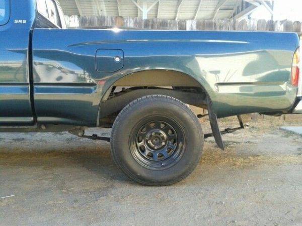

    few more pics for you guys :D
    heres the ride height for the new shackles and the leafs
    the droop
    had to throw some 90s on the 7100s to clear the bed

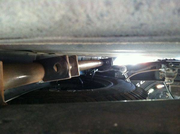

    and my upper tabs. a little rusty lol. still need to fully weld them and round the corners on the tabs to clear the shock body. have the axle tabs in my room just need to go to my buddies when its not raining and i have a day off of work

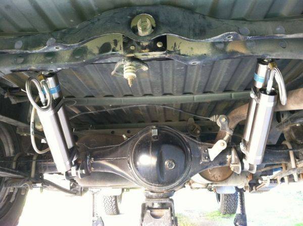

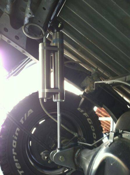

    ok guys finally got the shocks mounted and cycled :cool: heres a few pics. just need to get the shocks recharged get the shackles on and shes ready to roll.
    full droop
    full bump

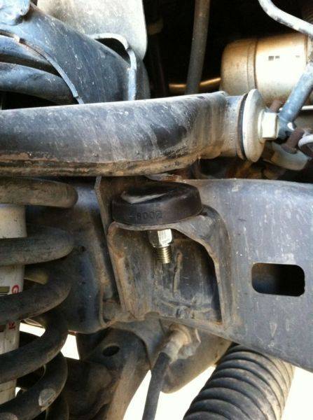

    shocks are charged and are valved pretty damn close. rides 10x better than it did before. hit a small trail by my gfs house and man it eats up those bumps real smooth now :D doing a few small things to the truck that bug me and swapping some much needed things :spy: might need a hand if someone local can swing by :) getting torn down the first sunday of march to do what i need to do and get it back on the ground and aligned and prepped for my next wheeling trip. heres a pic of the latest thing ive done
    put new droop stops on the ucas and got about another inch of droop :D
