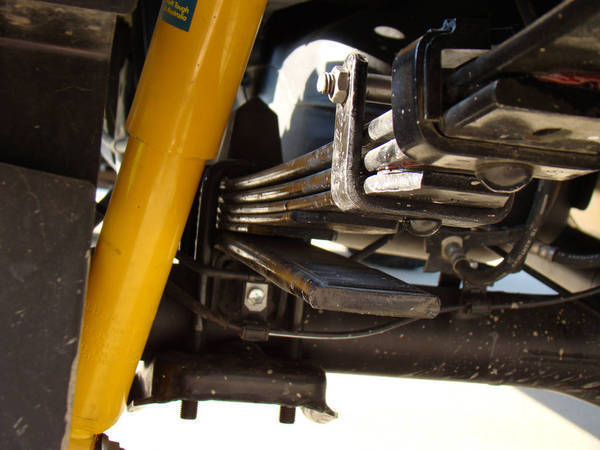

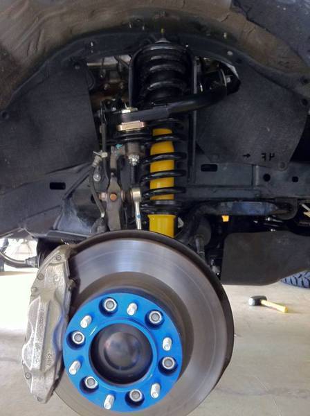

    Work in progress, but installed so far; 265/70/17 Duratracs, Spidertrax, OME885X coils with OME lean spacer, OME N140S and N182 shocks, Wheeler's 1.5" 3 Leaf Progressive AAL (kept the overload), LR UCAs. TP14 spacers

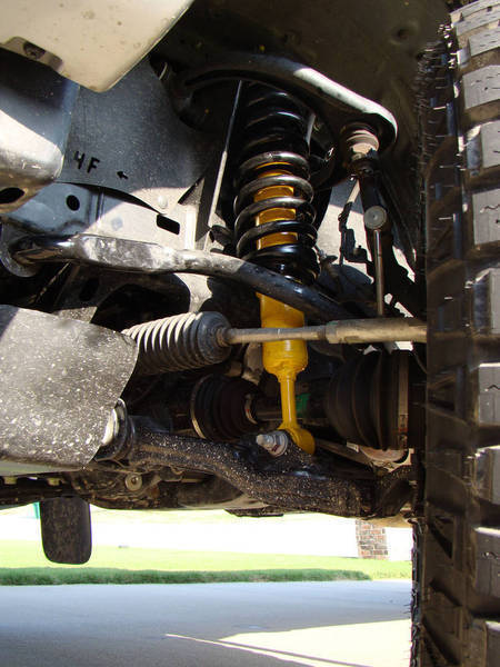

    On the front - OME 885xs with OME N140S (I got a great price on an 'old' OME lift kit that came with the older model of front shocks). OME Trim packer installed for Taco lean.
    On the back - Stock non-TSB leaf with Wheeler Offroad's 1.5" 3-leaf progressive AAL and OME N182 Nitrochargers shocks. For anyone interested, that 3-leaf AAL handles (and looks) great. Well worth the extra money.

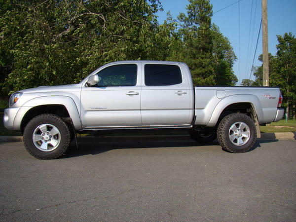

    On the ground - TRD Sport Alloy Wheels with 265/70/17 Duratracs and Spidertrax 1.25" wheel spacers.
    Front height from center of hub:22-1/2"
    Rear height from center of hub:23-3/4"
    So far, no shudders and the CV angles look good. I'm getting it aligned tomorrow, so hopefully that goes just as well.

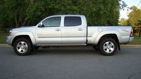

    Stock
    5/9/11 - ~9000 miles

    Installed LR UCAs to correct alignment issues on 11/6/11
