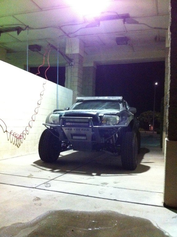

    #102

    ill update this more this week iv been lazy…but dropped the truck off with DTF today for awhile so some changes will be going down soon :cool: in the meantime here is this :p

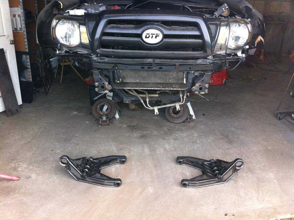

    longggggg over due update! :)
    so got the truck back from Anthony over at DTF last week and i got to say the new LT kit is amazing can't wait to test it out! Who else is ready to join the DTF team with this bad ass kit :cool: aside from other misc. fixes like lights and such. For the front end we did his new kit thats 6" over and used 2.5x10" Sway Away coil overs with dual rate springs (500x10 over 600x12) in the stock coil bucket, fox 2.0 hydro bumps bumping off the lowers, SAW piggybacks, dual straps, full heimed steering, heimmed uppers, solid mounted lowers and of course a fresh powder coat :D kit uses a 1.5" vertical uniballs all grade 8 hardware and nylon nuts and i believe it will cycle up to 19" (8" up travel and 8" down) although i think mines bumped short at 17ish because of the fender well...anyway look at the pictures and wait for the man at DTFtacoma to chime in to correct anything i said wrong :p or to explain it more! who's next on the list for this kit!?
    Next on the list is the new DTF rear kit so i can finally get off the damn Defined kit...then i think maybe a cage is in order :roll eyes: and sorry for the amount of photos i got excited
