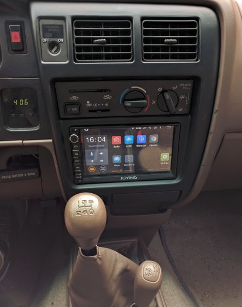

    So, I just got a new head unit that got a bit of discussion in a thread a few days ago - an Android (v5.1.1) based unit by JOYING (JOYING JY-UL135N2). I got it to replace an already after-market Pioneer that I wasn't a huge fan of due to the obnoxious background graphics that I couldn't get rid of.
    Install notes (on a 1st gen - 2000 XtraCab SR5 V6 4WD TRD):
    • The harness available from JOYING makes the head unit plug and play electrically
    • While the head unit body fits just fine, the bezel is about 2mm too wide and 2mm too tall for the opening in the dash; had to carefully enlarge the opening with sandpaper
    • The GPS unit is magnetic; I placed it on the round bar between the firewall and passenger air bag, which seemed like a place that would get relatively good reception
    • It supports two cameras, but I didn't install any
    • The password for the "Settings > Factory Settings" (where a lot of the useful settings are) is "126"
    Overall, I definitely like this unit better than my pioneer, and of course better than the OE CD/Tape player. If you don't mind the minor mod (above), I totally recommend this for a great experience in a 1st gen.
    Things I like:

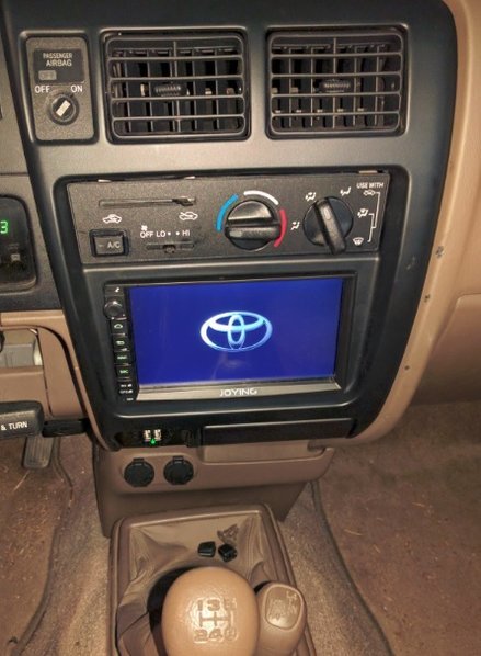

    • Boot screen is configurable. And it comes with a Toyota logo, which makes it look OEM
    • Easy to configure the wallpaper. I'm basically using "black" and it's nice to have it be so clean looking
    • The built-in apps seem to work relatively well for basics (radio, pairing with phone for podcasts and phone calls)
    • The microphone on the head unit works well (there's an external mic too, which I tested, but ultimately didn't install after testing sound quality of both)
    • It's Android, and so it's configurable (including the hard buttons on the device)
    • I can install apps from the Play Store. Waze, etc.
    Things I don't like:
    • The built-in app names are lame. The app used to make calls is "Bluetooth" (should be "Phone) and the app used to stream audio from my phone is "A2DP" (should be "Bluetooth")
    • The bezel is a bit deep for my tastes - nearly a half inch. That makes seeing the top of the screen tough, because of the bezel overhang
    • While the "hard" buttons are configurable, they seem to only be able to launch built-in apps (so the Nav button can't launch Waze)
    • The "hard" buttons work fine, but they feel cheap
    • The Bluetooth stack is pretty lame. It's probably fine for most things, but it won't connect to my Kiwi3 OBDII device; thus, no DashCommand
    Stock pics of the head unit and harness from amazon:
    (no install pics yet, but will update with pics when it's light tomorrow)
    Ask away if you have questions.

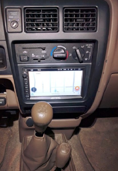

    Installed pics:

    OK yep, I got the NAVI configured to launch Waze so it sounds like we're on the same page. I really wish I could get the SRC button to cycle a different set of apps. I don't need the AVIN for sure, and I'd love A2DP and Bluetooth to be in the rotation. Not that big a deal really, when you think about the tradeoff of running something like my old Pioneer :)
