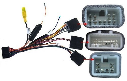

    Its got to be related to your amplifier (JBL).
    Ok, here's a psychotic engineer's trick to try to kill the noise;
    You've heard of aluminum foil deflector beanies? http://zapatopi.net/afdb/
    Kinda like this;
    The problem is with the MLB satellites;
    What we are going to try, is building an aluminum foil deflector beanie for your wiring.
    So what you're going to do, is get some aluminum foil, and wrap all of the wires individually. Don't make it thick or bunchy, just once or twice around. Don't use any tape, because you need these foil shields to be electrically common.
    Once you have all the different wires and components individually wrapped, then wrap the ENTIRE BUNDLE with its own layer. EVERYTHING, including the JBL adapter box.
    Now take a piece of stranded wire, and strip about 6 inches of insulation off of one end, and wrap that around the outer foil.
    Connect the other end of the wire to chassis or other solid point of good negative voltage.
    And throw some tape on it to hold it all together nicely.
    Basically what this does, is it will capture all the stray RF noise and shunt it into the negative terminal of the battery. Not only will it be able to capture external RF, but it will also (since you are wrapping each wire individually) catch any RF that is being created by self.
    I'll tell you a story about how this little trick helped me.
