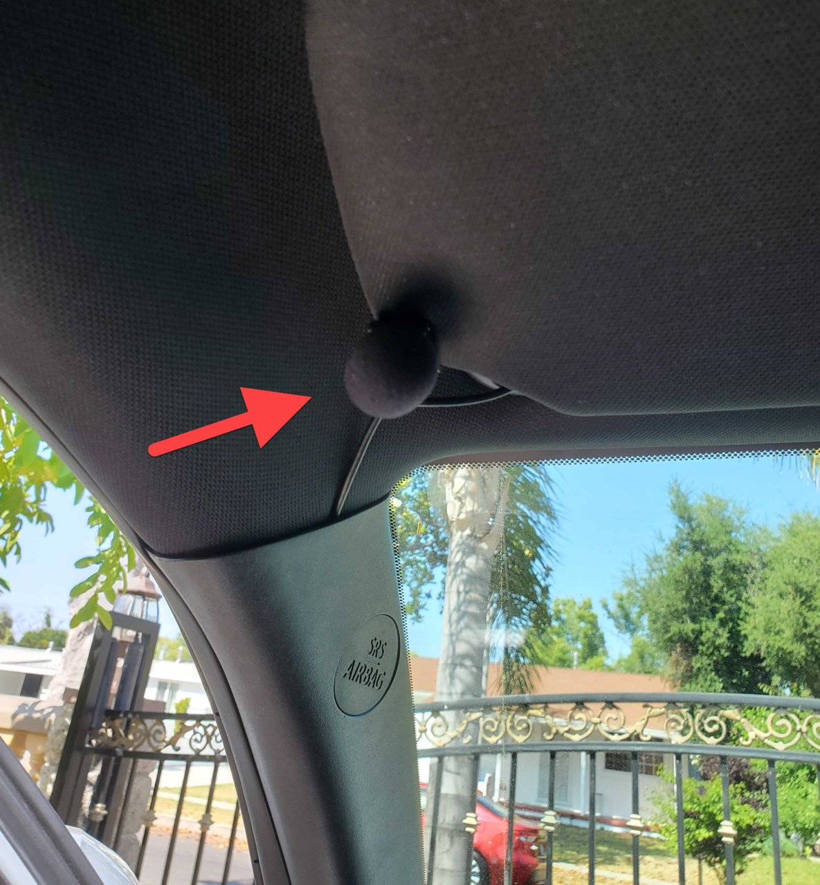

    Fitment/Installation: As mentioned earlier, the fit for this thing is perfect. It looks OEM, doesn't require aftermarket brackets (but it's usually recommended), and the installation is plug and play. I'm not including installation steps because it's really that simple if it fits, it clips, can't really mess anything up. I've also used the provided Mic that came with the unit and can confirm the quality is great. I'd recommend using the provided mic since your voice commands will be accurate.
    Here's the mic:
