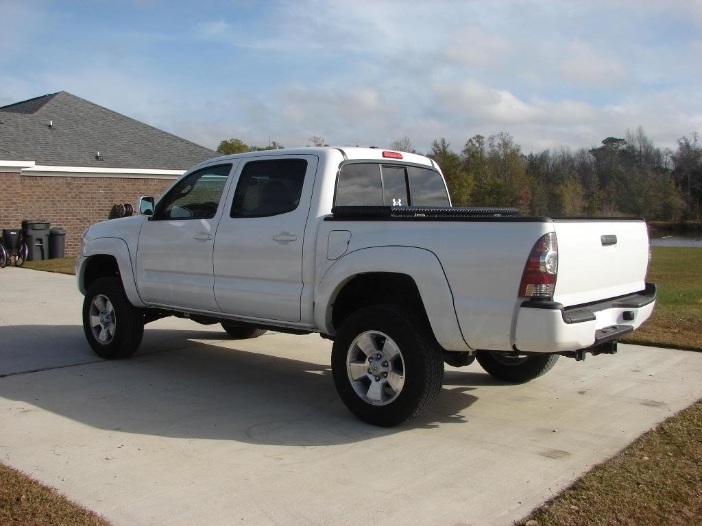

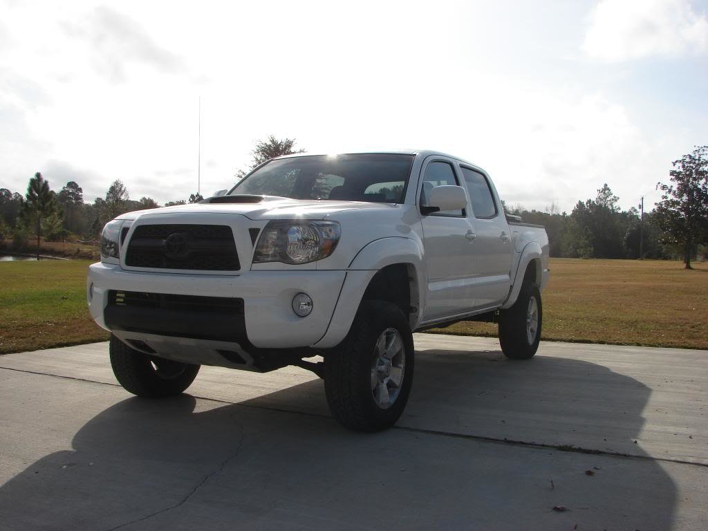

    Bought the truck from Estabrook Toyota. Don't have but one picture, but I'm sure y'all have seen a stock Tacoma before :rolleyes:
    -2011 Toyota Tacoma TRD Sport 4x4 DCSB

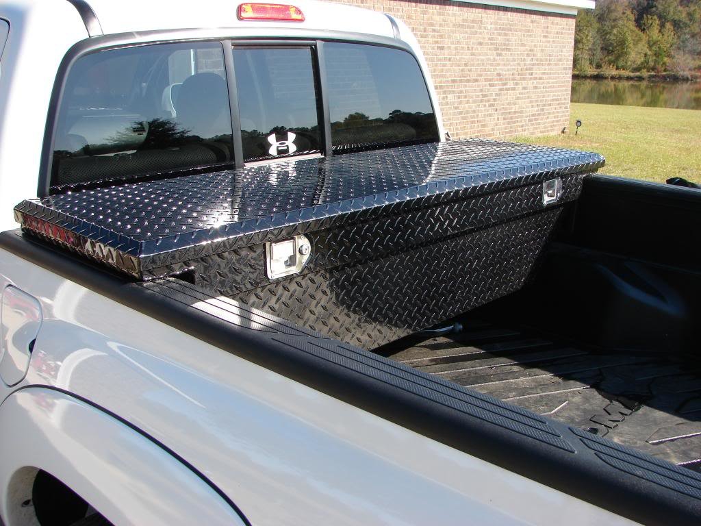

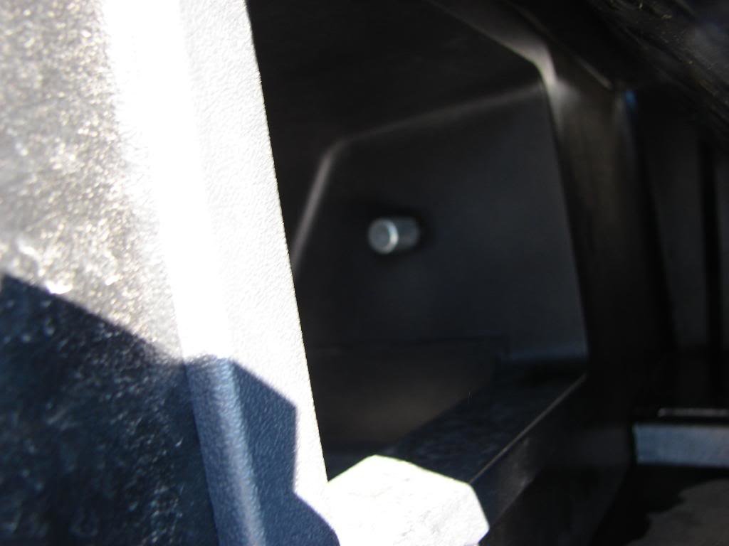

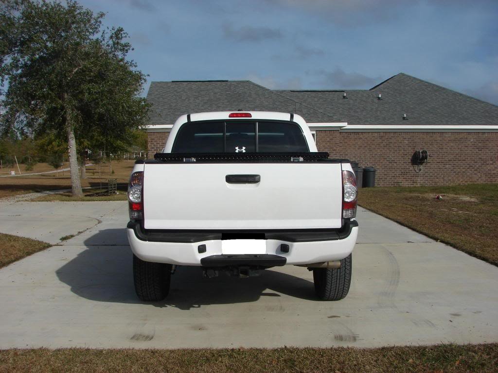

    Needed a place to store stuff in the bed, and couldn't take the stuff sliding around in the bed anymore, so I picked up the following:
    -Black Low Profile UWS Tool Box (TBS-63-A-LP-BLK)
    -OEM Bed Mat (PT580-35050-SB)
    -BlackHawk Holster for Glock.

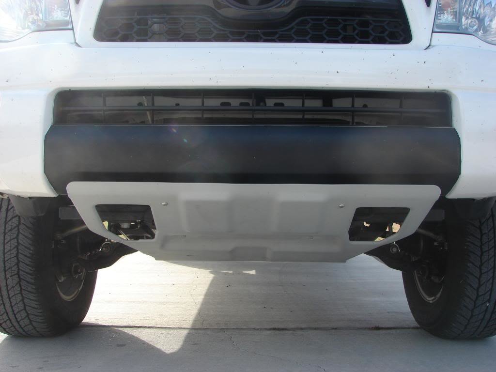

    Took the day to make a couple of changes since my factory skid came in.
    -TRD Skid Plate

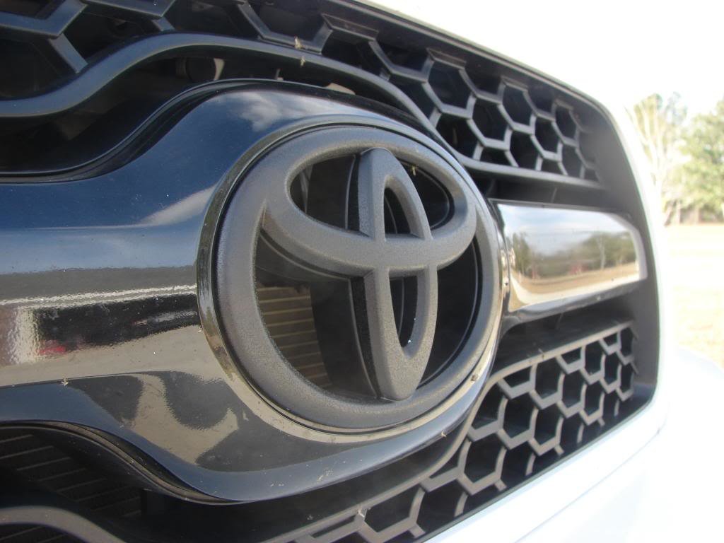

    -Painted Factory Grille Emblem (Rustoleum Truck Bed Liner)
    -Painted Lower Bumper Valance (Rustoleum Truck Bed Liner)

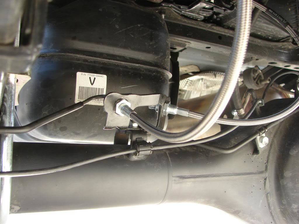

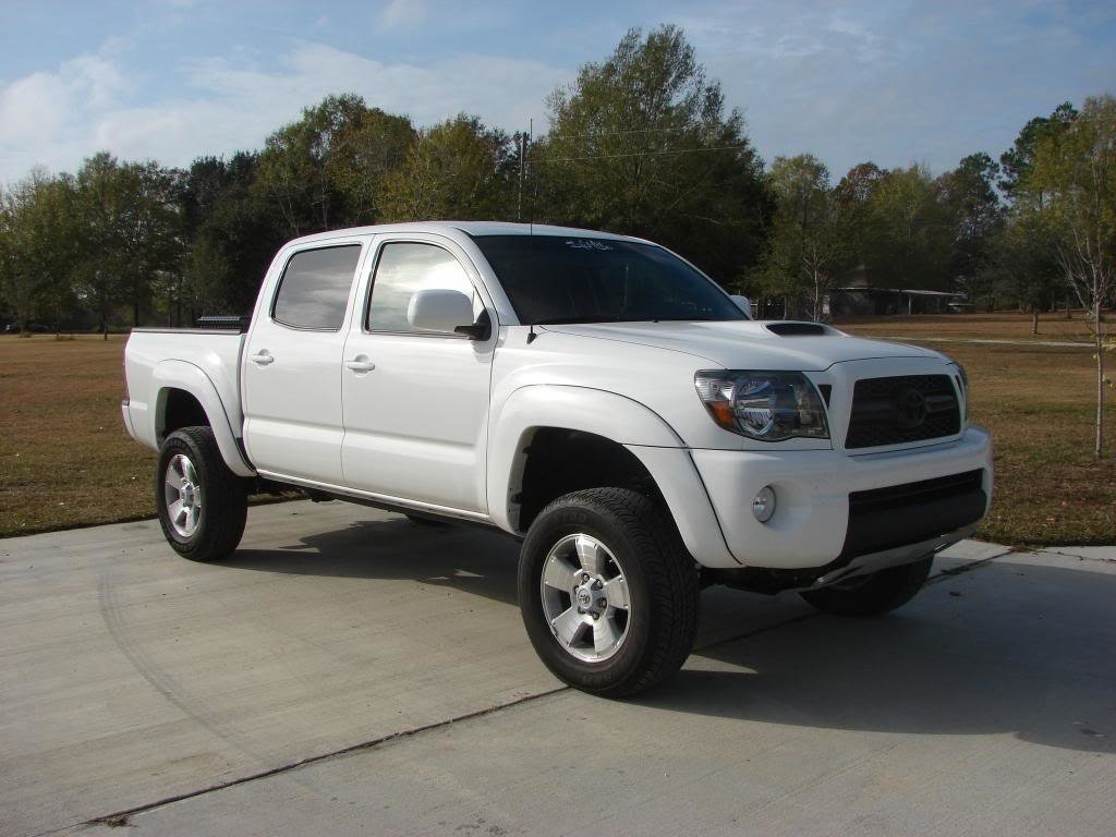

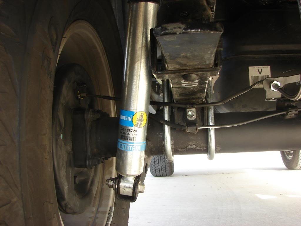

    All the parts of my lift finally arrived, and I had a local shop put it on for me after my failed attempt :eek:
    Measurements came to 24" exactly on all four corners :D
    -Bilstein Adjustable 5100's set at "0" (Front/Rear)

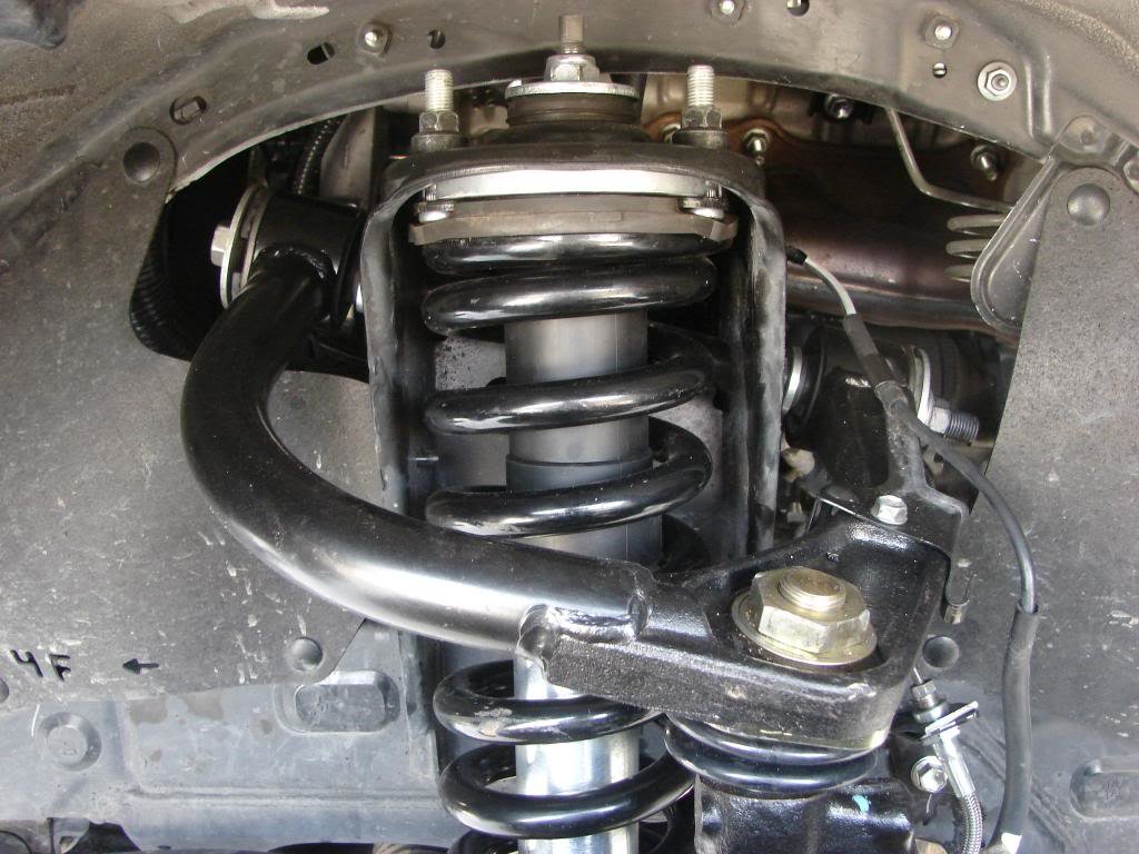

    -OME 885x Coil Springs
    -ToyTec 1/4" Top Plate Spacers
    -Light Racing Upper Control Arms
    -All-Pro U-Bolt Flip
    -All-Pro Extended Brake Lines (Front/Rear)
    -ToyTec/Deaver 2" Add-A-Leaf
    -ToyTec Carrier Bearing Drop
    -SpiderTrax 1.25" Wheel Spacers (Front/Rear)
    -ToyTec Axle Shims (Not Installed)

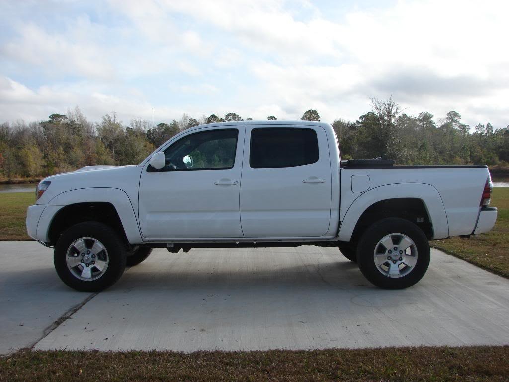

    392625_10150458593585935_618265934_10659_3312d5d6e46630641c3a04b1d8546fe15ad9d112.jpg

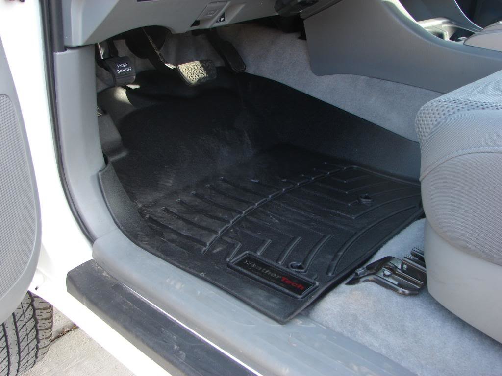

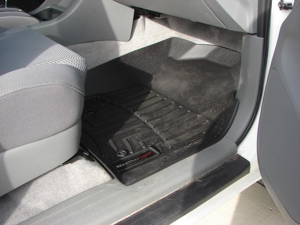

    Finally was able to get rid of those cheap factory floor mats :D
    -WeatherTech Digital Fit Floor Mats (Front/Rear)
  2. Dec 4, 2011 at 1:47 PM
    705 Taco
    705 Taco Zombie Killer!
    Jan 9, 2011
    #48958
    531
    Dean
    Barrie ON / St. Petersburg FL
    2016 TRD OR AC
    --Stock 2016. --------------------------------------------------------------------------------------------- 2011 had 6 inch ProComp lift, Eibach coils on 5100 Bilsteins at zero, 1/4 inch Toytec spacer on drivers side, rear TSB, 1.5 inch Deaver AAL, ProComp blocks and rear shocks, 8000 lb Warn winch on a Trans4mer grill guard, 33 inch BFG AT's, 18x9 XD Monsters, PIAA headlights, PIAA driving lights, Pyro's blue LED gauges, LED strip below tailgate, Armor Lid hard tonno, Hidden Hitch, Dee Zee bed mat, Tint, XM, Garmin GPS, Ultra Gauge

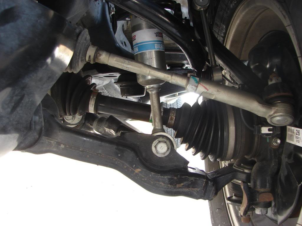

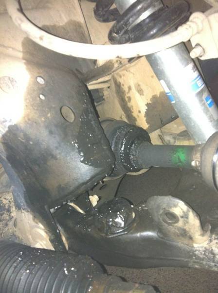

    Looks aesome but I think you have too much front lift to keep your cv's happy.
  3. Dec 4, 2011 at 2:34 PM

    Too much? I thought it was safe to run the 885's with top plate spacer? I'm at 24" from the center of the wheel to the bottom of the fender, but I don't have any measurements from stock.

    From everything I've read, I thought diff drops did more bad than good on 2nd Gens? Also, what's the "boot slide mod"? I thought I had read just about everything before posting, lol.

    I'm not sure about 885's but I run top plate spacers with Eibach coils with my 5100's set at .85 and I'm just under 23 inches in front with 200 lbs on the bumper. I have a diff drop and I wouldn't lift my front anymore. Stock is around 20 inches so you have around 4 inches of front lift. Any more than 3 is a no go. Toytec recommends no more than 23 inches from hub centre to front fender lift.

    I don't really understand where my extra lift is coming from. ToyTec's site says to use the top plate spacers in order to achieve a full 3" of lift in the front. So how is it that 885's, top plate spacers, and 5100's set at "0" provided me with 4" of lift? The truck is mostly level with the 2" AAL, and the ride is amazing. I'm not exactly sure what else could be messed up? :confused:
