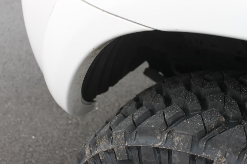

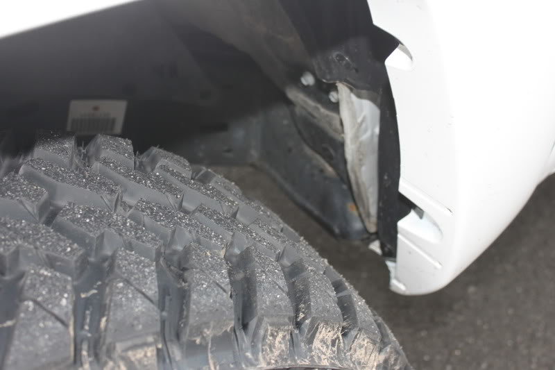

    Trimmed up my fenders last night, now I just need to do the cab mount chop and possibly bend over the pinch weld.

    Here is what i had to trim:
    Front driver:
    trimmed a little too much on the driver front behind the wheel, i'm going to get another splash guard and match up my trim to the pinch weld like i did on the other side
    Front passenger:
    Next week i'm going to do the cab mount chop, then i won't have to be scared of bumps at full lock. I set my coilovrs to 2.25" on the driver side and 2" on the passenger side. I'm still getting 2" of downtravel which is what icon recommends so it's all good.

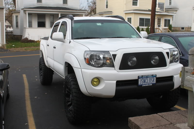

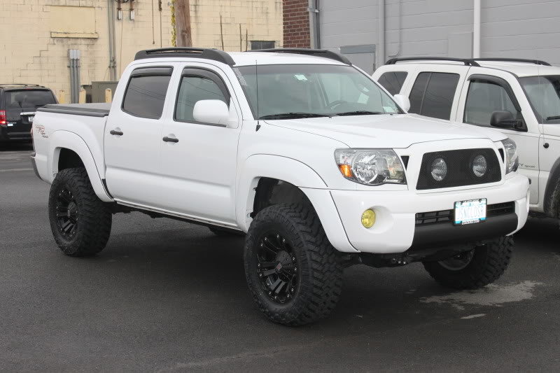

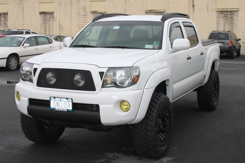

    Real clean, nice work!

    One of the best white on black tacoma's ive ever seen.
    NICE
