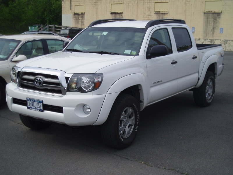

    Here is how it all got started:
    stock pictures:

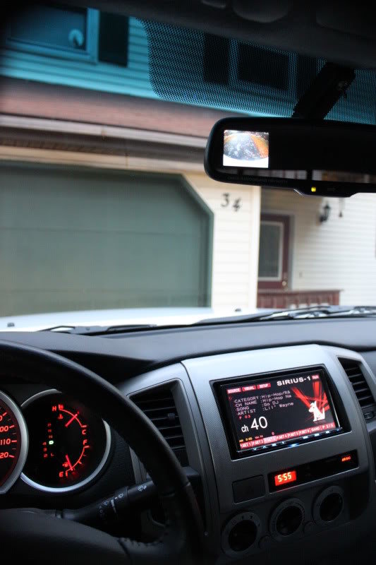

    Added the Alpine IVA-W505, Valentine 1, and did the reverse camera switch mod:

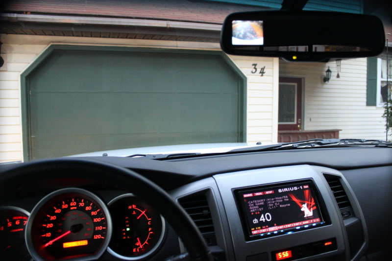

    Here is my back-up camera switch mod. Take note that my rear camera is on and the truck is in drive.
    Valentine 1 Radar detector and mute switch

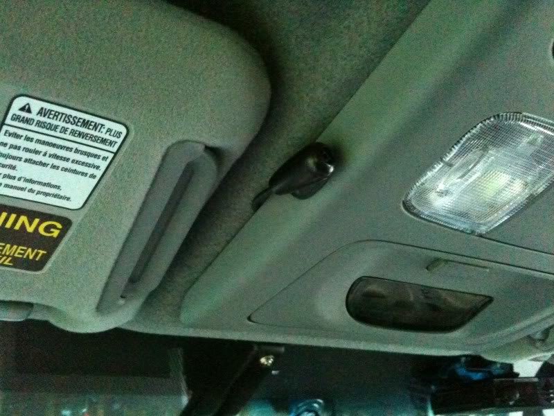

    Mic for my Alpine Blu-tooth

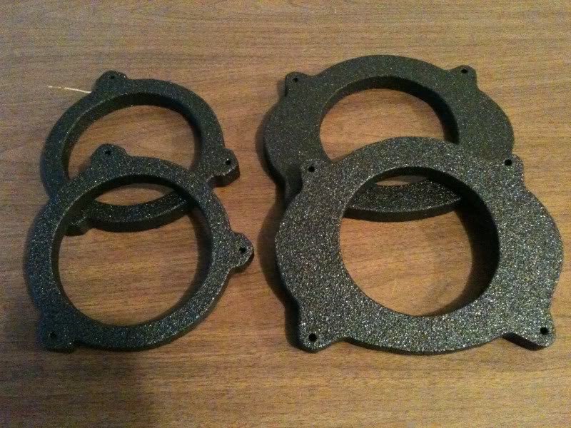

    Speaker rings made by me and then Line-x'd

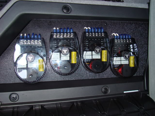

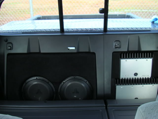

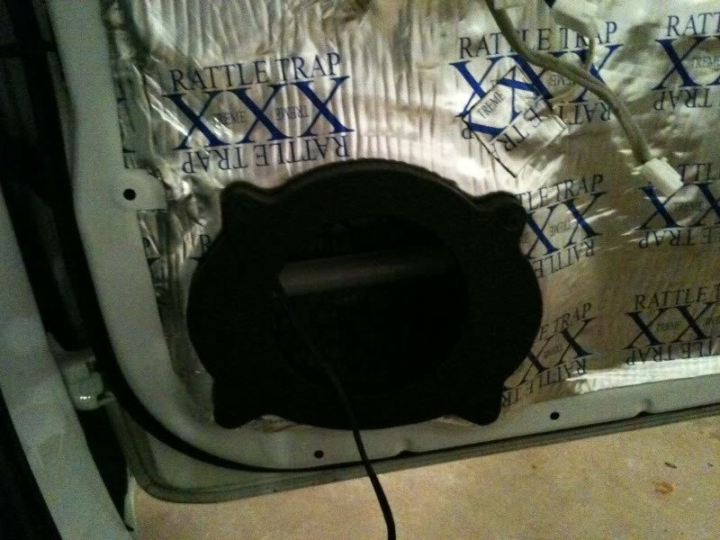

    JL Stealthbox and JL Audio Amps. X-overs mounted under the drivers side storage bin.

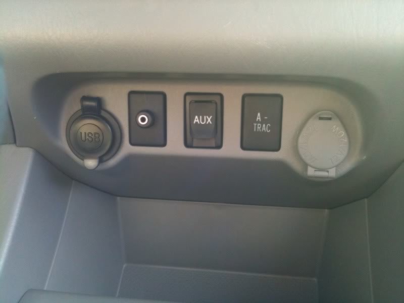

    A Small little touch of detail that really stands out...
    L to R: USB plug, iPod video plug, AUX plug modified and wired to W505, A-Track, 12v plug

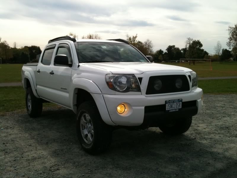

    Finally installed my lamin-x fogs, homelink garage door opener and valentine 1 mute button

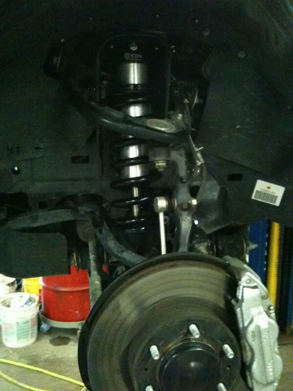

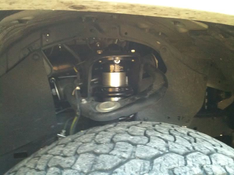

    Installed My Lift Saturday!!! 9-25-2010

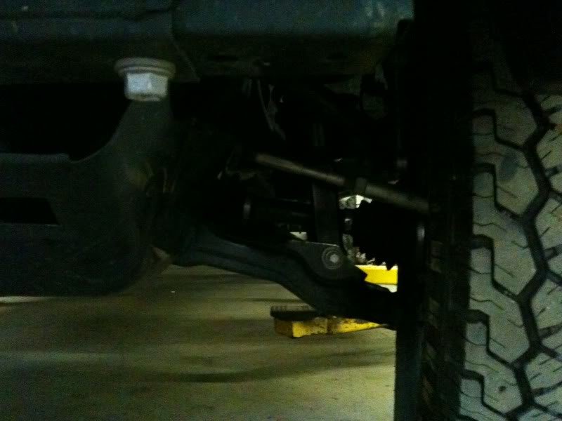

    Icon extended travel coilovers set to 3" (1.75" thread on the drivers side and 1.5" thread on the pass side)

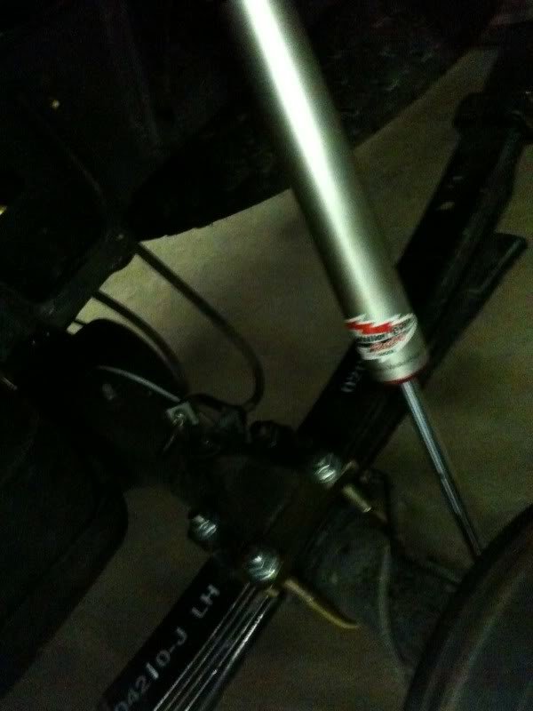

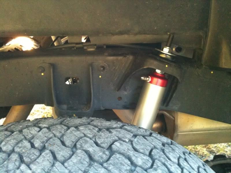

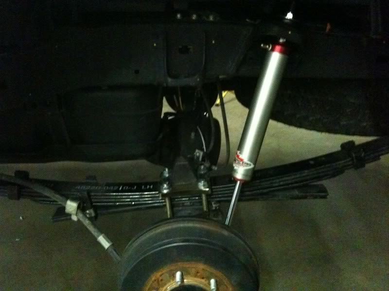

    TSB leaf springs, Wheelers 1.5" AAL, All Pro U-bolt flip kit, Walker Evans 2.0 rear shocks. Gives 4" of rear lift
    CV Angles after the Diff drop kit installed
    And all finished up!

    whats the switch on the camera do?
  4. May 14, 2010 at 8:48 AM
    hookedontronics
    hookedontronics [OP] Well-Known Member
    Jan 6, 2010
    #28863
    2,780
    Jake
    Glenville, NY
    2010 DC Off Road 4x4
    Icon extended travel 3.5" front coilovers, DSM UCAs, TSB leaf pack w/ wheelers AAL, All Pro U-bolt flip kit, Walker Evans 2.0 rear shocks, 18" XD Monster rims, Nitto trail grappler 285/65R18 Tires, Color matched grill, Grillcraft, Kragen HIDs, Carling switches, my bed light mod, diff drop, Alpine IVA-W505, JL Audio C5 componets and coaxials, JL 300/4 and 250/1 amps and JL stealthbox, wheathertechs, avs vent visors, toyota bed x-tender, alcantara center console cover and door pocket covers, console vault, color matched mirrors, heated mirrors, etc etc etc
    The switch taps 12v power to the camera. When the switch is up, your camera acts normal and only turns on when you are in reverse. When the switch is turned down, the camera is on no matter what.

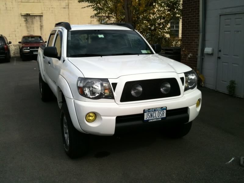

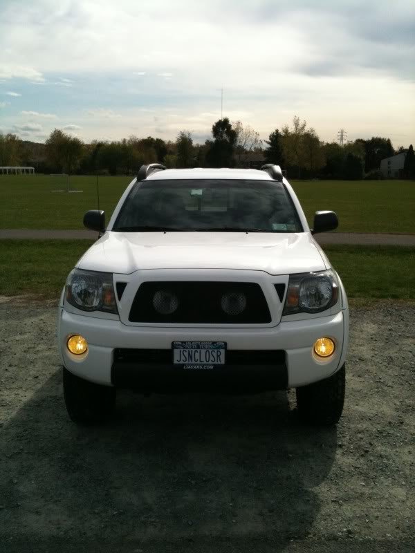

    just ordered some carling switches! My color matched grill and grillcraft with kragen hids comes in today also!!! WooHoo
  20. Oct 14, 2010 at 10:19 AM
    #20
    hookedontronics
    Jan 6, 2010
    #28863
    2,780
    Jake
    Glenville, NY

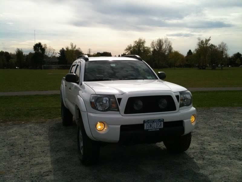

    just installed my grillcraft, color matched grill and kragen hids. still need to wire the hids tho
