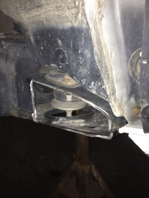

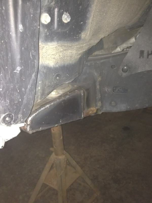

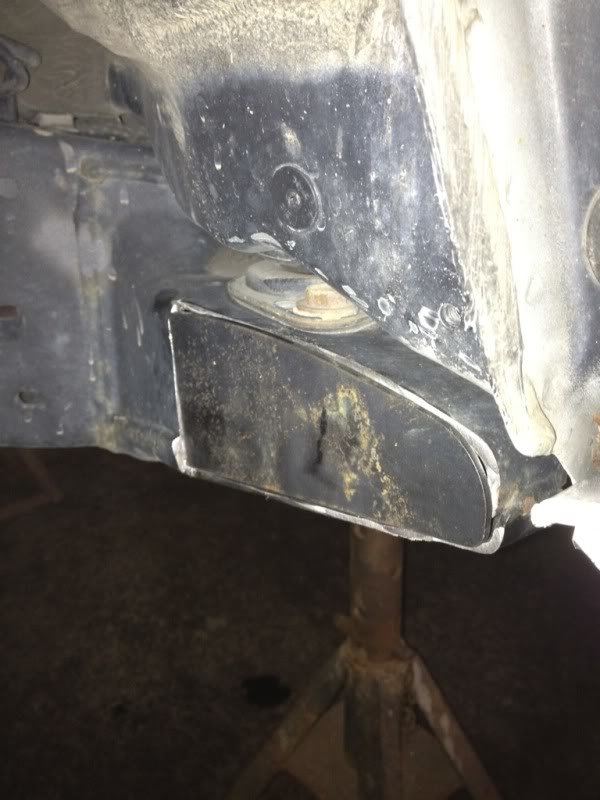

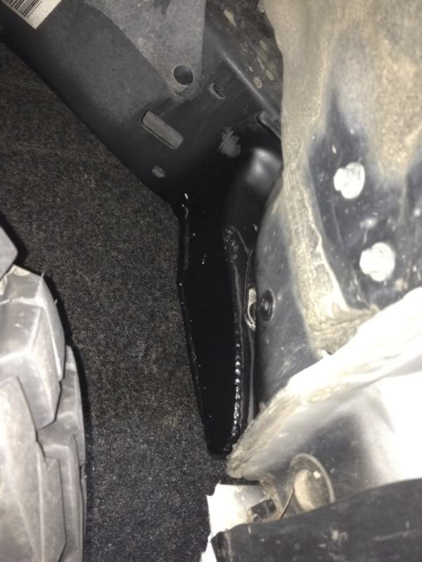

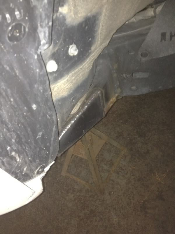

    Did the CMC today. It is sooo nice finally being able to turn at full lock.

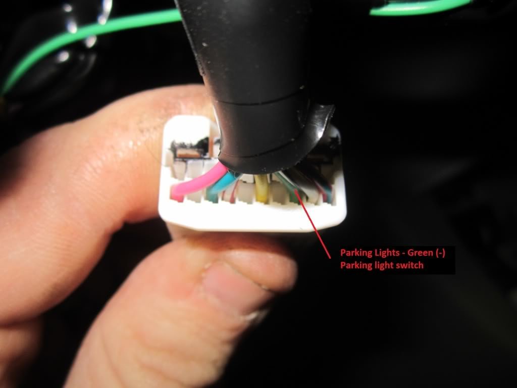

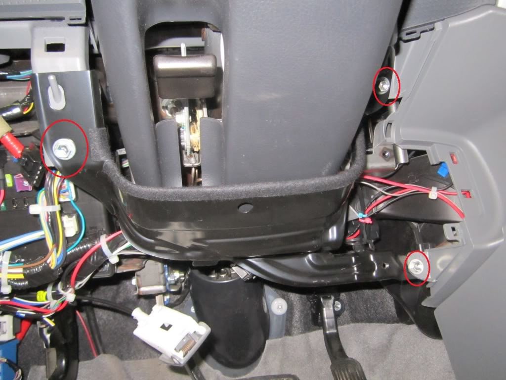

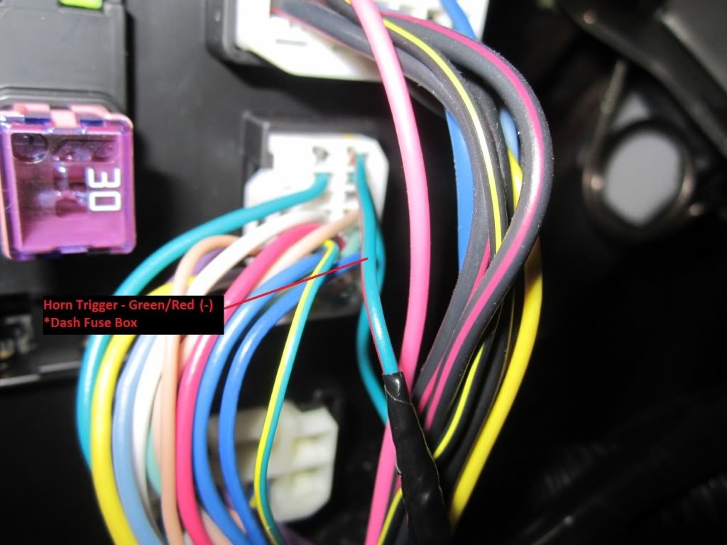

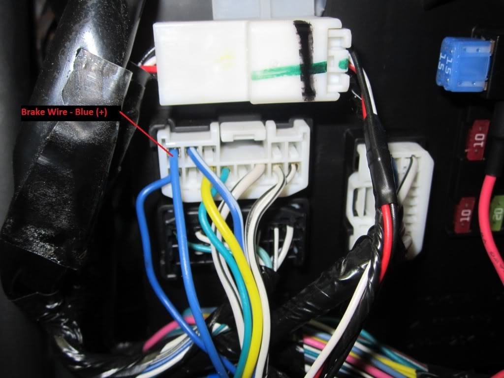

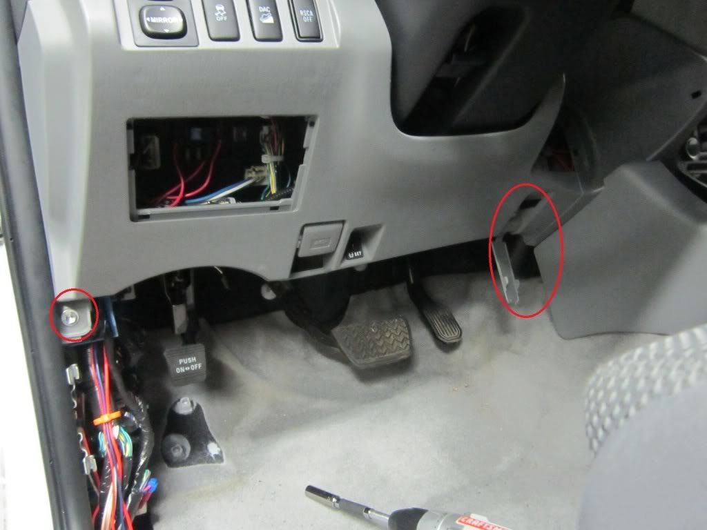

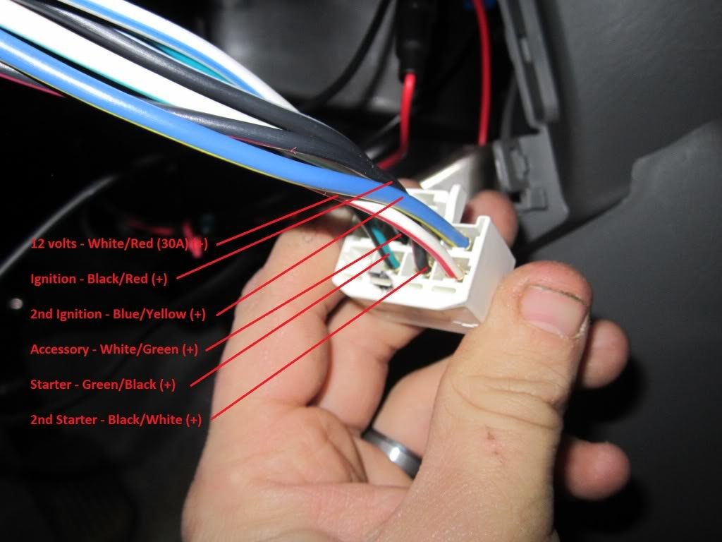

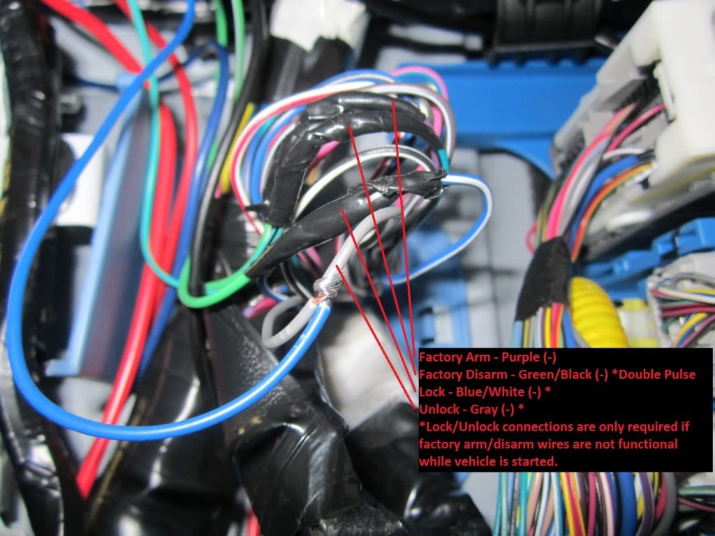

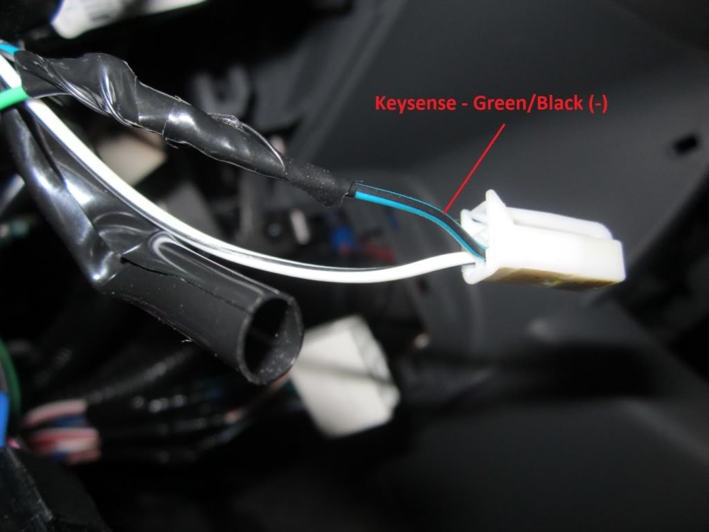

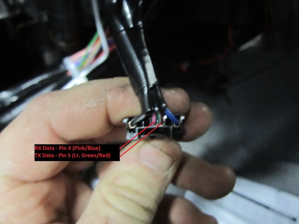

    **Guy who installed my unit put this pictorial together on the12volt.com. here it is copied, hopefully it can help someone
    Vehicle: 2010 Toyota Tacoma Automatic
    Starter: Python 580
    Bypass: Key-Override-All (Fortin)
    Disassembly:
    - Remove Door sill panel and driver kick panel
    - Pop off small plastic "door" on right side of knee bolster and remove (2) 10mm bolts on either side of bolster
    - Remove (3) 10mm bolts on metal support bracket. Lift up and out to remove bracket.
    - Remove (2) Phillips head screws behind steering wheel and remove lower steering column plastic.
    Installation:
    - Main ignition harness at ignition switch
    - Parking lights (-) at light switch
    - Brake switch and horn at front of fuse panel
    - Door locks found in Driver Kick panel coming from driver door.
    - Keysense at ignition switch
    - Data wires found at ignition switch
    No pictured:
    - Tach signal found at OBD connector
    - Hood pin was added for installation.
