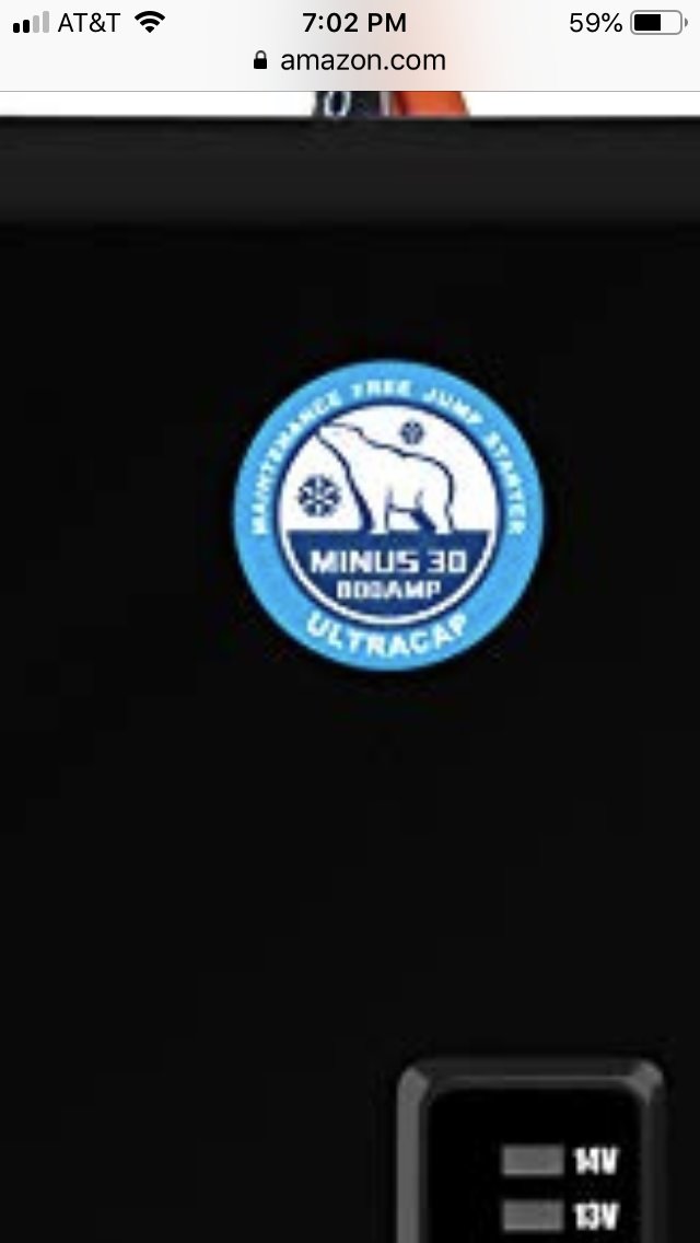

    Mine is supposed to!
    See post #11 it has a link!

    I didn't see anything in the description about extreme temperatures.

    It has no batteries!
