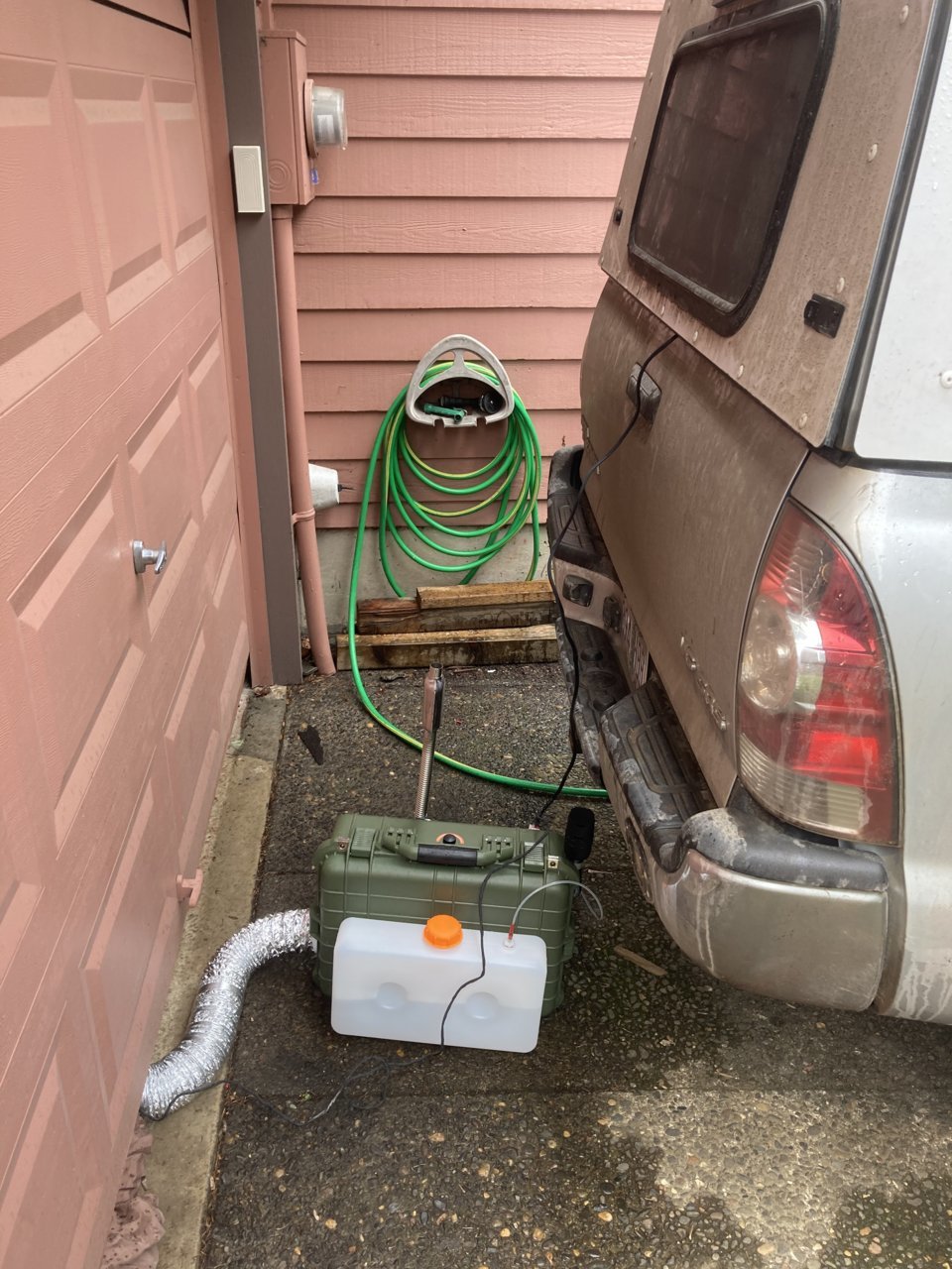

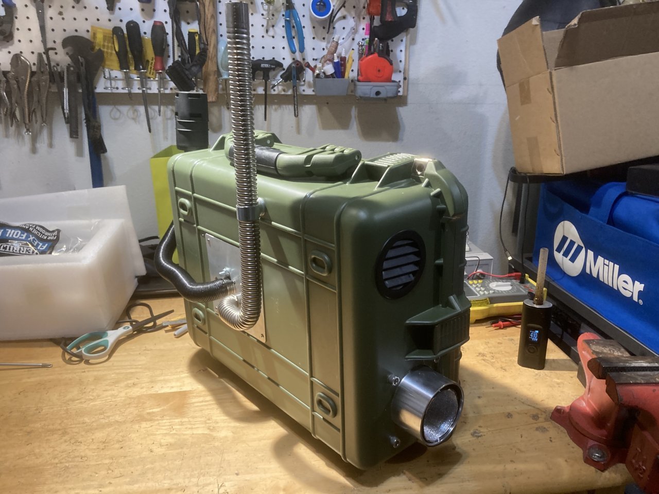

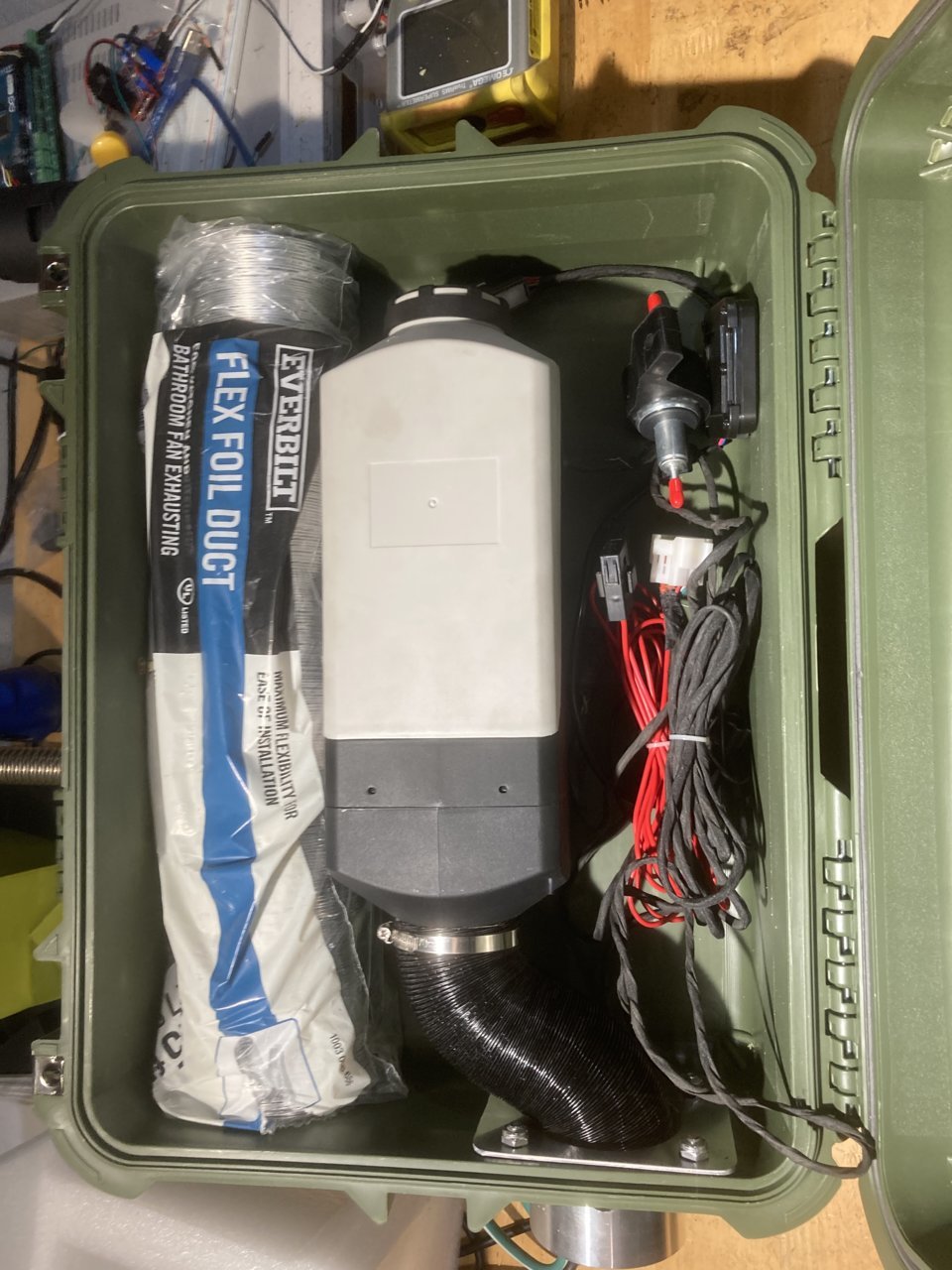

    Here is my heater setup for my wedge camper. It’s just a Chinese diesel heater mounted inside a harbor freight pelican case. With the duct I’m able to move the heater away from the camper and noise isn’t an issue. Honestly it’s pretty quiet anyway. The loudest part is the fuel pump ticking. Another perk of the box mounting is when I don’t need it I can just leave it in the garage.
    last pic is using it to heat my garage while working out there.

    As for the fuel pump it helps alot to use a rubber mount. Mine came with a molded rubber one that works pretty well but I've also seen some Van builds online mount it using a small quick fist. They're way louder if they're hard mounted since it resonates through the structure. It's especially a problem mounted in Vans.
    Other than the fuel pump clicking it's practically silent.

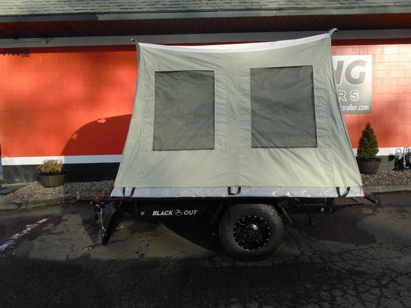

    A couple "boredom" mods to get me through the dead of winter. 2-1/2" square tube axle lift, vision steel wheels and the leftover 265/75/16 ATs from my xterra.
