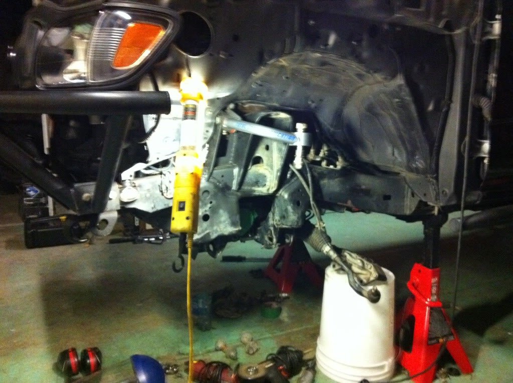

    You'll need more than a grinder. This is the best pic I could find. After I grinded off everything that was in the way, I beat the shit out of the pinchweld with a 5 lb sledge. Litterally folded the sheetmetal back an inch....and that was just to clear 11" wide tires. Hell full compression/lock I still rub sometimes.
    Here's a snippit from JLee's build:

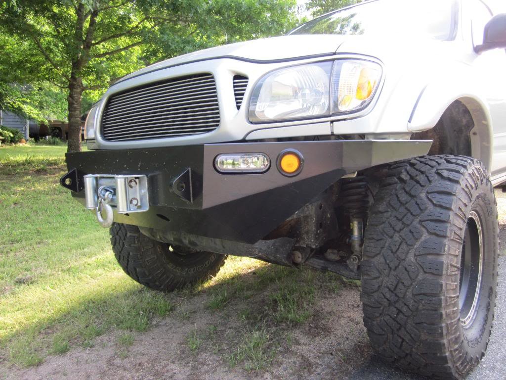

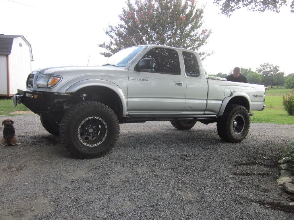

    You will love them, that's the same set up I am running. Great tires for a great price!

    What kind of bumper is that?

    MOBS Fab out of Concord, NC
