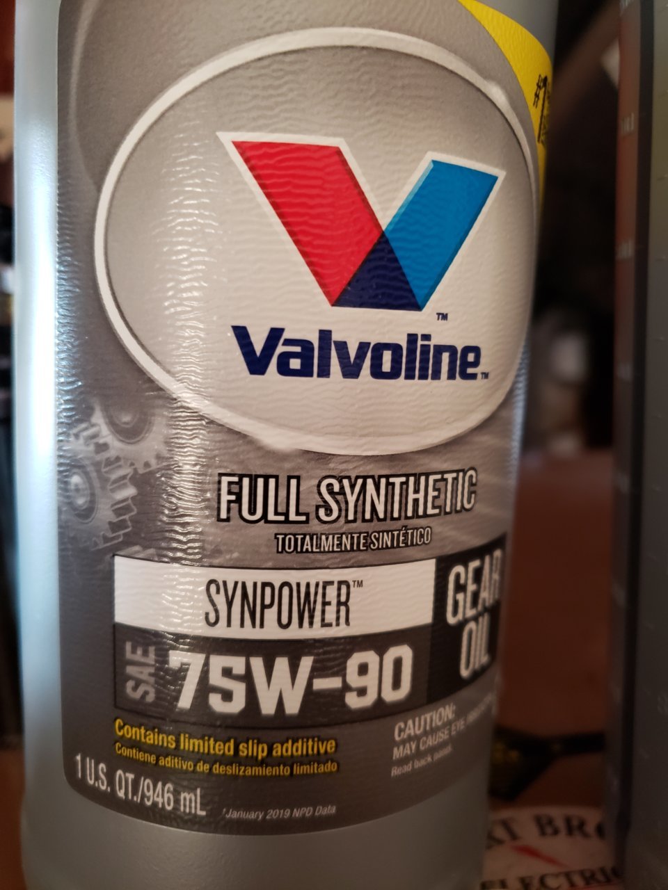

    Yes I believe my lsd is mechanical limited slip differential for all sport models(2wd 05-08). I should've bought conventional. I feel the synthetic is too thin of an oil. My old fluid didn't look too bad(it actually looks pretty good with no metal shavings) and it was pretty thick. I'll look that red and tacky Lucas oil stuff up and probably pick a bottle up to zirc it. Sounds like that stuff works good. Is it available at stores like autozone, o'reilly or Napa?

    You'll be fine with the oil you got in there, just go get the 4oz bottle add that and find a parking lot to do about 5 or 6 figure eights to work the add. into the clutch pack.

    Don't rely on the quarts that say LSD additive use the little 4oz additive.
    I don't know why they even say that on the bottle I've never seen it work, with or without the saying on the bottle always use the additive.
    Syn or dino makes no difference both are formulated to work.

    I used synthetic 75w-90w from O’Reillys. My truck doesn’t call for the friction modifier.

    Well the chirping/squealing noise went away. I checked it up right now. I'm still going to buy lubegard tomorrow when napa opens up. Is it possible to go over 3 qts on refill and it still not dribble out of the fill plug?

    Yeah at first I freaking out and thought maybe I shouldn't have used sythentic. But guys on /r/toyotatacoma told me it's hit or miss and that I should add friction modifier. I don't know if any of you gents were the ones telling me on reddit. But yeah I got worried because maybe synthetic is too thin. But the noise(made only in reverse) stopped and I'm still not going to drive it til lubegard and top off is done. I did buy a grease gun from harbor freight because in a couple days or so I will be getting JBA uca's and want to service them so getting the grease gun made sense to pick up so I can grease the u joint. You said your truck doesn't require friction modifier? Cuz you have open diff huh

    Yes, it’s possible to add more Fluid than the books calls for.
    The important part is the truck needs to be fairly level. Too much angle form left to right wheel and the fluid could run down the axle tube and cause an over fill. Too much angle front to back, could cause and over fill as well, or even an under fill.
    The rear is easy enough, you could probably do it in a parking lot.
    I wouldn’t worry too much about it unless you start getting closer to a full qt over.

    Well i just got some ramps to make it level and top it off(also to work on my Corolla in the driveway). I used 3 of the valvoline bottle. I thought I was going to need a pump but I was actually able to squeeze directly into the full hole with the nozzle on the bottle. I emptied all three bottles (til they made the sounds like when you get mudbutt after eating taco bell) and after went in my Corolla to buy a 4th bottle. But tomorrow Im gonna add the 4 oz of lubegard and then fill the rear up til the fluid dribbles out(with that 4th bottle) . And I'll make sure the truck will be somewhat level on front back and side to side. It stopped making the chirping noise in reverse. I checked 4 times in the past 2 hrs. If it's is not squealing the I won't be either lol. 1st night I parked the Tacoma after fluid change and the noise with it in the driveway with the rear up (driveway slopes down and truck was backed in) then last night I left it parked on the street (so the front was pointing upwards) so idk if that had anything to do with the fluid setting in the right places. But i did notice the sounds went away and tried every way to enact the noise going in reverse and it didn't make the noise. But I will fill it up(rear diff on level ground or ramps) tomorrow even if it means I use half a quart extra. It shoukd stray to dribble out as soon as I start to fill it cuz I used 3 qts and like a 10th of the 4th bottle
