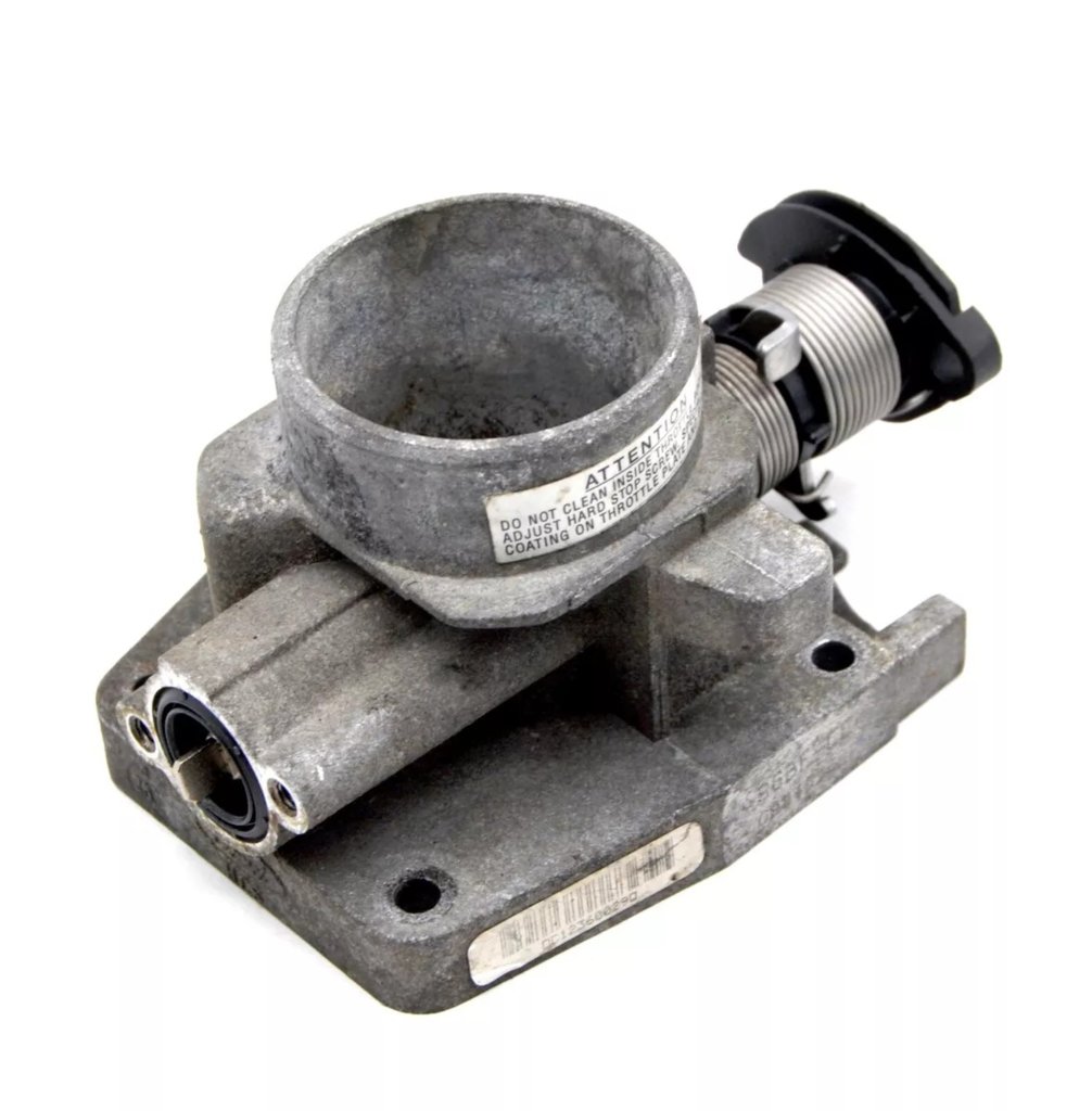

    Maybe Toyotas don't have it, but I'm pretty sure most do. My old 90s fords even had a sticker on them warning you not to clean with carb/brake cleaner and to use throttle body cleaner to not take the coating off.

  12. Aug 21, 2024 at 7:14 PM
    Speedytech7
    Feb 20, 2014
    #123587
    57,554
    FCQM+VG Cheney, Washington
    It's less Tacoma and more mod
    Had to check to make sure I wasn't misremembering. It definitely is there although I couldn't find a picture of the whole sticker but you can read the gist of it
