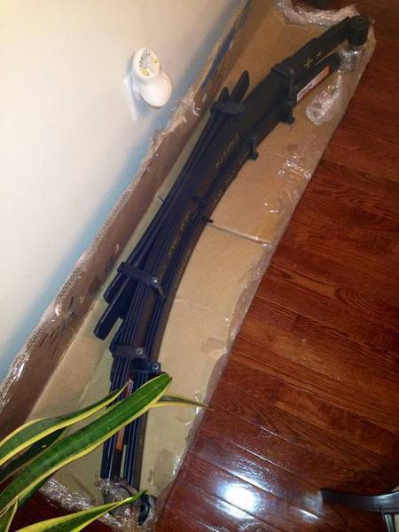

    Dakars, fully assembled from toytec, with front and rear bushings already pressed in

    + on one and - on the other? Or is the other not marked?

    They have a + on one, and a negative - on the other, but, ome says they are not side specific. ???
