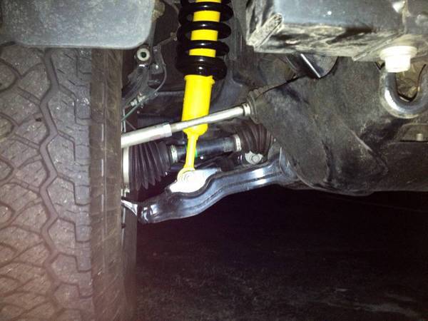

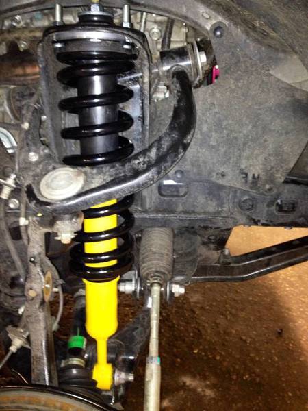

    fronts are done. lower control arms did not swing down easily... they stayed there like a diving board.. i had to wedge a small jack between the lower control arm and the bump stop to push it down enough to take out the stock coil and put the new shocks in. but its done. oh and i removed the front sway bar, it was rubbing on the lower perch/coil mount on the shocks. i know my alignment is all out of whack, but driving home i got it up to 65mph, let my hands off the wheel and it went straight, the steering wheel is turned to the right just a little bit maybe 2-3 degrees.
    the front leveled it out pretty well with the rear dakars i did yesterday

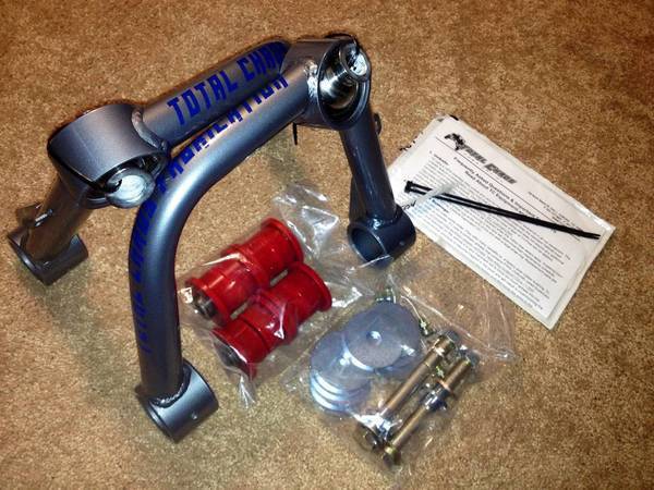

    the total chaos UCA came in the mail with my 285-70-17 Goodyear Wrangler Duratrac's as well today. cant wait for the rims to come so i can mount them and slap it on the truck
    ill snap a pic of the TC UCA after finish making my dinner and eating

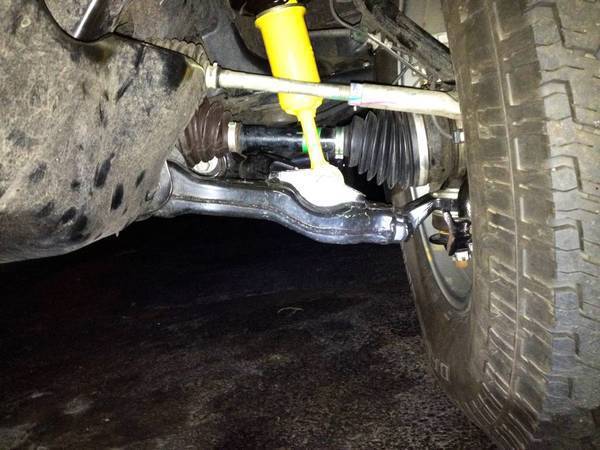

    Looks good! Be sure to post up your hub to fender measurements and some pics of your cv angles if you get a chance.

    Driver Side CV angle
    Passenger Side, i dont know why this angle appears to be so much more than the driver side... could be why the steering wheel is turned right a little bit, or my driveway

    or.. taco lean!?

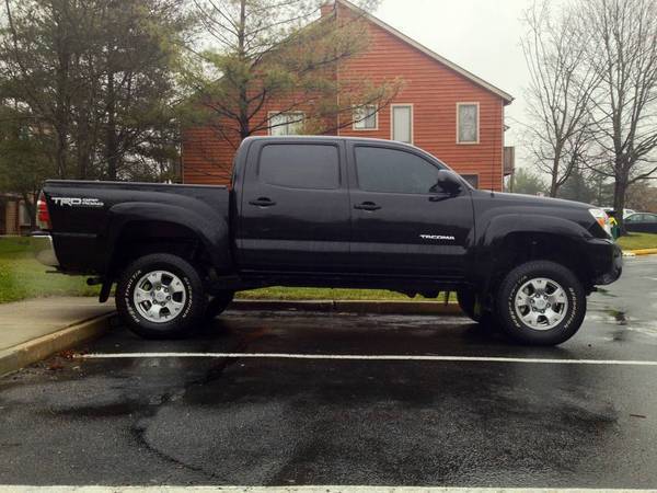

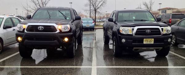

    parking spot has a little grade to it... but the finished lift is pretty level.[​IMG]
    my dbl ca OR pkg with ome 885 spacer 3" lift dakar rear on left
    access cab OR pkg stock suspension

    connecticut
    09 trd off road
    Satoshi'd grill. blacked out badges. aftermarket sound system. De-chromed and color matched. OME 885s + Dakars with 3rd leaf removed. LR UCAs. Scs stealth 6 with 285 duratracs. BAMF sliders
    Looks awesome nick, time for some wheels and tires!
