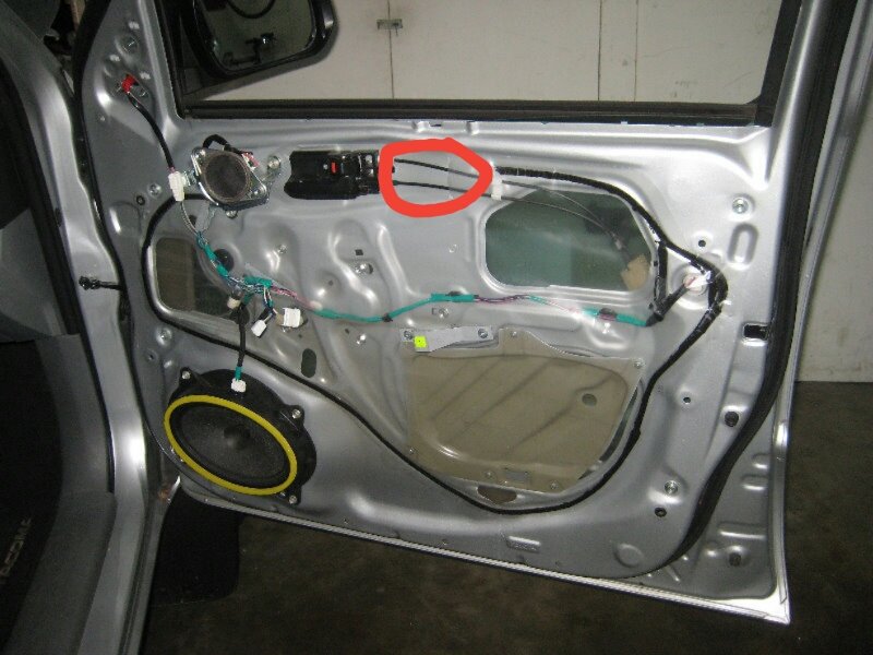

    Ooooh I just figured out what the OP meant. Mine was doing the same thing. My issue was when I reinstalled the door the actuator arms werr binding and cycling the locks. I reinstalled the door panel and made sure nothing was pinched and I was good to go.

    What do you mean the actuator arms? The cable that goes from the lock to the actuator? Thank you for you help.

    The orange circled cables. Mine were jammed up so it would cycle the locks. I uninstalled the panel making sure it was perfectly installed and never had the problem again.

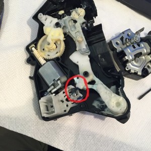

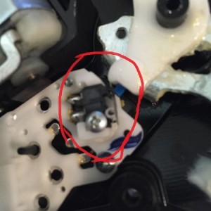

    OK the problem was in the actuator, there is a very small metal plate that pushes down a very skinny black switch to tell your protection that the door is locked or unlocked. I have attached pictures and circled the area that needs to be fixed.

    Hey Mike. Did the switch need to be pressed in by the plate with the actuators unlocked before reassembly? I replaced both motors inside the actuators and did notice the switch and my locks unlock twice when I close the doors.
