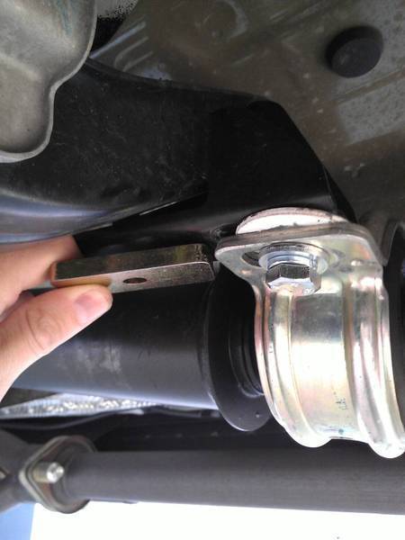

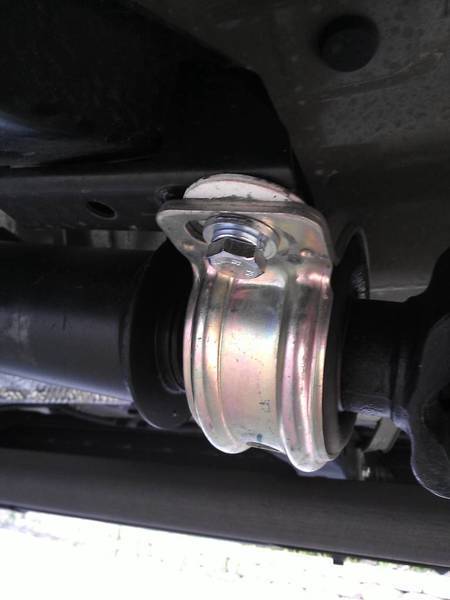

    Well, I got my OME CB kit from 4WheelParts.com today (they have a local store so the shipping was free) . As you guys know, this is a cake thing to do so I tried a few options.
    1st... I added the 3/4 plate and bolts. Ran it up to 60 and it was worse :mad:
    2nd.. I added a fat washer I had in the garage and it was worse again. :mad:
    3rd... I removed the 3/4 plate and left the washer and it was about the same as when I started.
    Fuuuuuuuuuuuuuu!
    With just the washer...
    Just a shot of the 3/4 plate for scale...
    I could try an run up to 1" but given it got worse at 3/4 + a washer... I doubt this will help. Eyeballing it, the shaft looks pretty damn straight through the CB.
    Ideas?

    The OME CB drop is only 3/8" thick , is that what you are reffering to when you say 3/4" plate ? or did you try a thicker spacer ?

    You're right... its 3/8". So that says... i need a bit more to match what is working for the other guys. Grr.. I didnt even check that (obviously).

    Head over to the hardware store and get some metal bar to the thickness you need. Cut it and drill it, presto. Might work, might not.
