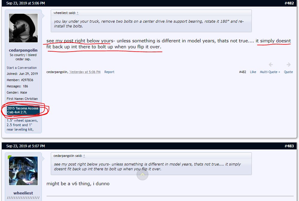

    great question because when i flipped mine for kicks and giggles, i just unbolted the two bolts, turned the whole clamped carrier bearing casing around and tried to bolt it up, but it cant because the bottom half is thicker than the top half and it wont fit between the crossbar that it bolts to. that donut around the carrier bearing only fits up in there to bolt on one way, its too thick the other way.

    see my post right below yours- unless something is different in model years, thats not true.... it simply doesnt fit back up int there to bolt up when you flip it over.

    might be a v6 thing, i dunno

    That was what I was thinking too when I've tried to mess with the shims and such. I'll take a look again, but I think I'm in the same boat.

    2.7?

    Nope, I had no trouble flipping the center bearing on my 2007, V6. Maybe he has an aftermarket center bearing? Hoping someone can post some pics to show what prevents it from flipping.

    no, 4.0
