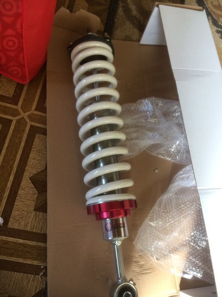

Just got my coil overs today from freedom off-road

    These coil overs go from 2.5-5" inches never seen one that high before it also came wit 3" rear block an extended rear shocks an extended stabilizer links just waiting on my upper control arm so I can install it

    #74319

    Are you 4x4?

    Man your gonna have to lift that front to the point of no return to match them 3" blocks, unless you want 2" of forward rake. Sounds like a maintenance nightmare to me man.

    don't go over 3" on a 4x4

    what coilover did you get that goes from 2.5 to 5"?

    From Freedom off-road

    i hope you can make it work but they clearly are not a design any of the top manufacturers has used as the adjustment threads go way lower than most and the shock body is way longer than most. basically they just put more collar and took out travel in the shock. i dont think they will ride good at all unless the lift you want can be achieved at that collar setting. the further up you go i am afraid it doesnt look like the spring could move very far before running into itself (coil slap). i have never heard of these myself a quick google shows no confirmed reviews.
    do you see how much space my springs have between each rung...and that is with it halfway up the shock body. your springs are closer together and you gotta crank that collar at least 2 inches which is where im concerned. unless those are like 800 pound springs and give 2-3 inches of lift at that setting. granted my 6112 were like $620

    I'm not trying to be "that asshole" but the lower section of the Coilovers looks like a weak link if you were to do any mild off-roading with them. The location of the adjustment colors is going to make it difficult to adjust the ride height. Did they provide you with an specs for the spring rate used? Is it safe to assume that this will be a pavement princess?
