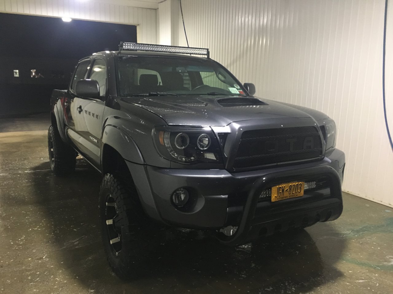

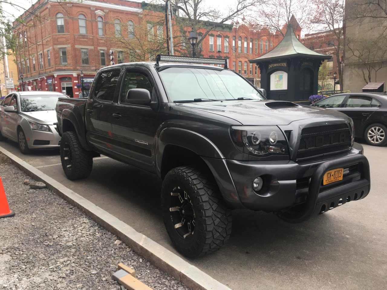

    Just purchases a 2010 Metallic grey Tacoma TRD Sport, Double Cab 145K miles. It has 33's. In 2018 the frame was replaced by recall. also so was the leaf springs, brake lines and front lower control arms. all fluids and belts. Plus front Passenger axle.
    Got it for $11,500 in Upstate Ny. I was looking for a stock one pretty much. But this one caught my eye. Lost of parts on it. Some of it isn't my flavor but really liking this thing so far. Three are some things to fix and address, but in really good shape. Bought it from a 23 year old and I'm 43 so, it was treated like a 23 year old owned it. He was a Dirt Bike kids and it shows. Dents and scratches allover but at least I don't have to baby it.Dents in the roof and burn holes in the seats drive me nuts. But I own a Tacoma and its pretty awesome.

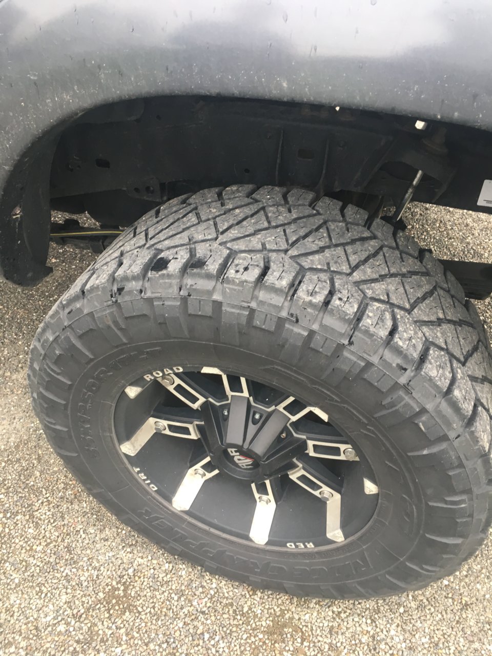

    Suspention and wheels
    Rough Country 2-3 inch lift leveling kit

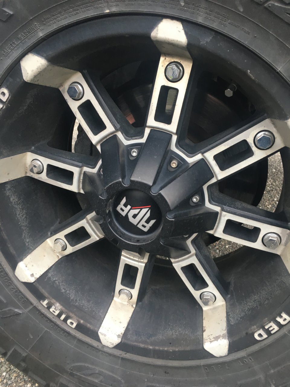

    Red Dirt Road 17x9 rims
    33x12.5 x 17 Nitto Ridge Grapplers
    Spider trex 1.25 spacers
    rear 5100 Bilstein shocks
    Stock Bilsteins up front
    Motor
    MBRP stainless cat back exhaust
    K&N cold air intake
    Looks
    Bageless grill, made by him says "Yota"
    Spyder Halo Projector Headlights
    led light bar in bumper
    led roof mount Led light bar-Roof mounted "ouch"
    Black Bull bar
    Led under dash lights
    Pioneer Double din CD player w/ Bluetooth
    Rockford 6x9 Front Speakers
    Pioneer 6.5 resr speakers
    Has some issues, Tires are on their way out. Rims went through 4 years of Upstate Ny winters so showing signs of wear.

    Getting an NY Inspection on Wed and tires rotated and balanced to sort out the wobble at 50 mph. Planning on gettign new tires before winter thinking 33's but might even go down to 16's with 285/76/16's

    Before you spend money on tires or even an alignment, check the wear of your ball joints and steering components. Very good chance they're worn - wide tires and spacers are hell on that stuff.
    Other than that, I really don't like bull bars.
    EDIT: PS. Looks like a good truck to start with though - nothing that can't be fixed.

    I'd suggest putting fluid film or similar rust inhibitor on the frame. Also, nerf bars tend to enhance low speed damage because they easily will roll in and hit the grill.
