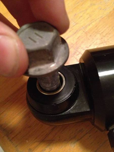

    I have run into a problem with the bushing sleeves they give you.

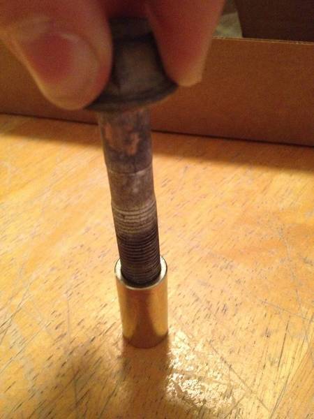

    This is the smallest sleeve and is a tad to small to fit the stock bolt.
    and this is the bigger sleeve and it is a bit to big.
    I think I came up with a solution but it is going to require drilling out the mounting holes to a 1/2 in. I went to Lowe's and picked up a grade 8, 1/2 in bolt that is almost identical to the stock bolt and it fits the bigger sleeve like a glove. So I guess I need to know if this will be a good idea or a bad one?

    I got the shocks from Luis at paradise racing so they should be the exact ones for the Tacoma. We tried to get the old bushing out of the old shocks but no luck. I think,( and I could be wrong), that maybe there are two types of bushing sleeves, SAE and metric sleeves that come with the shocks. I think what I have is SAE bushings because the 1/2 inch bolt I got from Lowe's fits it perfectly, so with that said, I am assuming that the Stock bolt is metric and maybe they sent the wrong sleeves? :notsure:

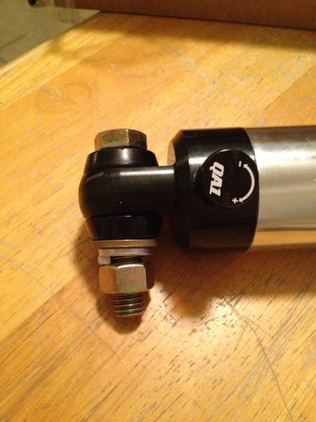

    It's a common issue of Standard vs Metric. The sleeves are made in America the stock Tacoma bolts are made in Japan. Easiest fix is to drill the mounts on the truck to fit the fatter sleeves the QA1's came with. Think of it as an upgrade. Get some 5/8" grade 8 bolts. QA1's come with 1/2" gold sleeves and 5/8" gold sleeves. On my rear 4 link kits, I toss the smaller sleeves and use the 5/8" ones.
    Seems you have it handled. I just re read your original post. I know the shocks that I use for the rear on my 4 link kit, come with 1/2" & 5/8" sleeves in a bag. Pictured are the 5/8" next to the shocks, and the 1/2" ones in the bag that I won't be using.

    Lowered: 3 inch drop blocks (Beefed Taco),Satoshi Grill, Morimoto bi-xenon H1 Retrofitted headlights, Flowmaster exhaust, Blue LED interior and exterior, blue LED dome light, Anzo black LED taillights, Hifonics Brutus 1100w Mono Block, Bazooka 300w Amp, LED license plate lights. Lifited: Fat Bob's rear shocks, Fat Bob's 3" spacer and rear AAL, Nitto Terragrapplers

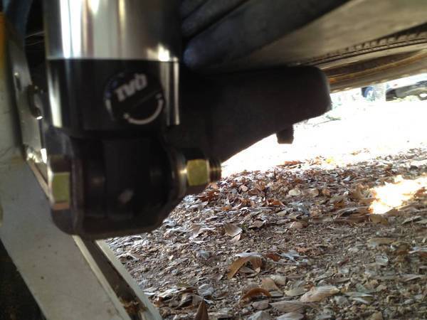

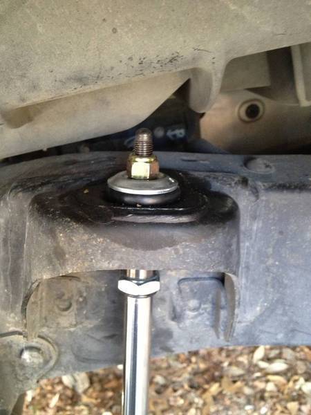

    I just drilled out the holes so I could make the bigger sleeves fit as of right now the driver side shock is on and adjusted, but now the passenger side ones is giving me problems, the lil nub at the top of the stock shock actually broke off as I was trying to undo the nut :mad: I would think the stock Toyota shocks would hold up better after only 70,xxx miles of use.

    It put up a damn fight but I got the passenger side shock off.

    All done, took it for a test drive and everything feels alright. :woot:

    That style shock setup always does that. It's a pain in the ass. I hate that style and wish they could just put a round eye on each end, would make life easier. I use vise grips, but there's technically a special tool used to hold that square top piece, it's so damn small. 4 runner rear shocks are like that and the top piece is buried between the body and the frame and you can barely get to them. REAL stupid! I'd love to have the guy that designed them try to remove a shock after 10 years.
