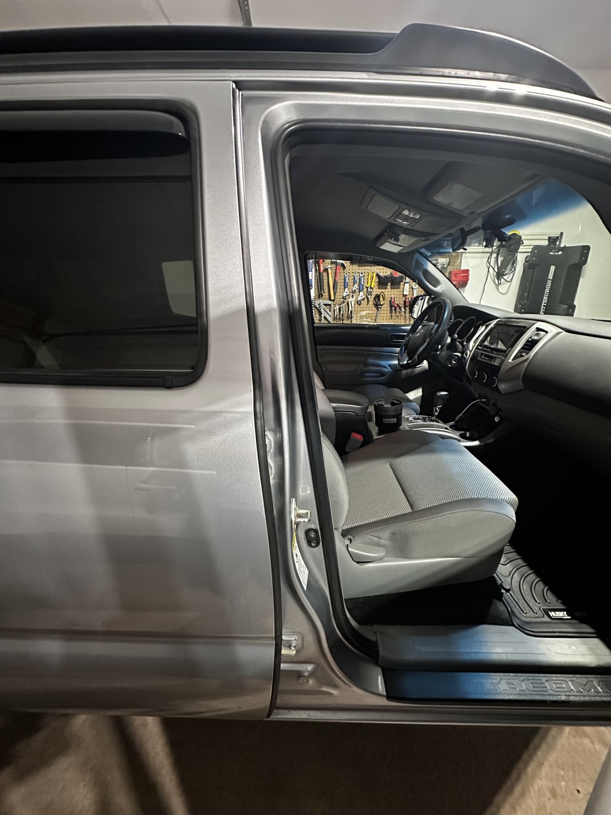

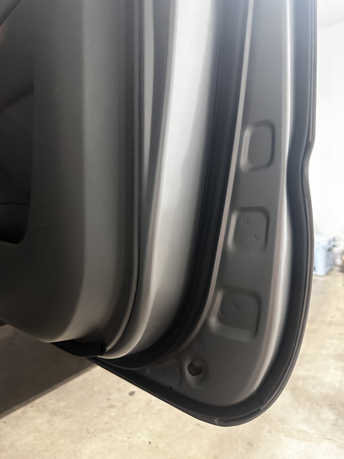

    I added extra weather sealing around the doors and it lowered the wind noise by 10db. Totally worth it if you’re a high mileage daily driver.

    Do you happen to have any info/pics on the extra weather sealing?

    I used this: Trim-Lok D-Shaped Rubber Seal –... https://www.amazon.com/dp/B00NL4AA5W?ref=ppx_pop_mob_ap_share
    I followed this:
