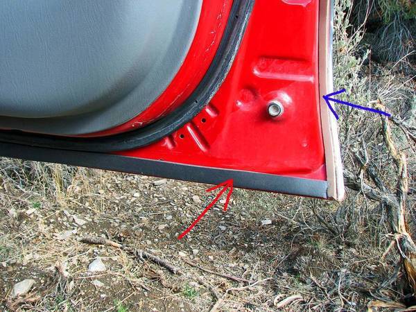

    I have done this mod on several F-150s and recently did it to my 06 DC Tacoma. I use my Taco to do geologic field work in NE Nevada where summers are very dusty. I needed a way to seal out the dust from getting in the door hinges and latches behind the external rubber door molding. I used simple weatherstrip available for any hardware store. With the weatherstrip, I effectively sealed out the dust, but when I got on the highway I became alarmed.:eek: I was hearing sounds I had never heard before... like the engine, drive train, my radio to name a few:D. Sealing out dust also effectively sealed out wind noise on the highway. I am amazed even after a week since doing mod this just how quiet my cab is driving at highway speeds!!!
    Our Tacomas are made very well, with good fit and finish to the body parts. However, the Tacoma is still a production vehicle. Any bit of TLC the owner puts into their Tacoma will only make it better.
    This mod seals off air gaps in the door and prevents air from swirling in them. Your doors will close easily with not much additional push (well, mine close nicely!!).
    Needed for this mod is the following;
    30 ft. of 1/4 X1/2 in. weatherstrip, adhesive on one side
    15 ft. of 3/4 X 7/16 in weatherstrip, adhesive on one side
    15 ft. of 1/4 in diameter caulk prep foam rope (I could only find it in 100' rolls)
    Optional 00 steel wool for surface prep
    Adhesive glue
    This mod is very simple. It calls for applying the weatherstrip on the door jam and doors so that when the doors are closed, all wind gaps are sealed off. The key to longevity of weatherstrip is cleaning the surface where the strip will be applied to. I used window cleaner and followed up with roughing up the surface with 00 steel wool. The steel wool increases the surface area for the weatherstrip adhesive.

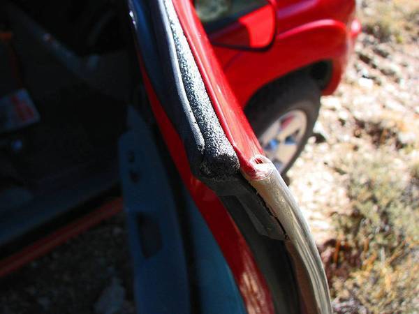

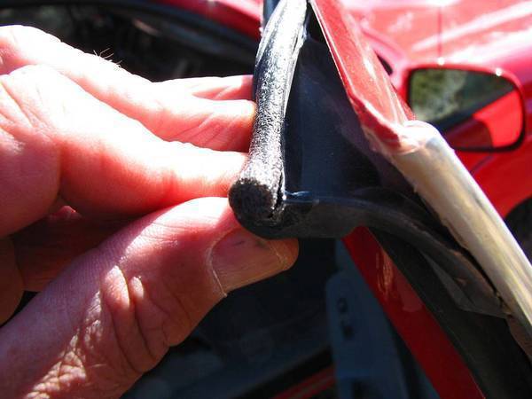

    Step One:
    As seen in the photo, blue arrows point to 1/4 X1/2 in. weatherstrip mounted on the door jam, rear drivers side. The strip is mounted in the recess where the flange of the door seats into. Both the threshold and rear of the door frame on all doors need this stripping.

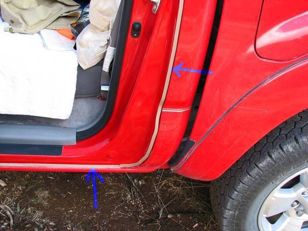

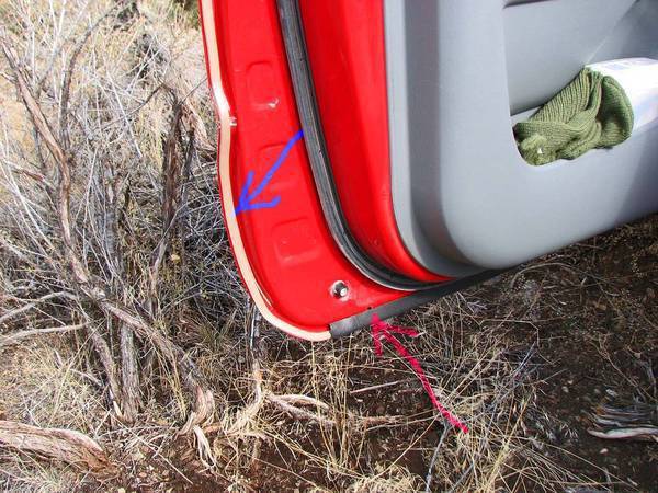

    Step two:

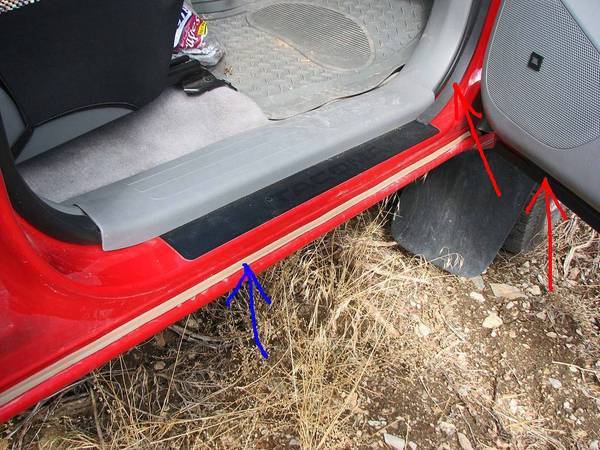

    Same 1/4 X1/2 in. weatherstrip is applied to the door flange which fits in to the doorjam recess. This should be applied so with the door closed, it is flush with the like stripping on the doorjam, forming a good seal. The blue arrow shows this stripping only on the rear of the door. All four doors need to be dressed in this manner. The base of the door is dressed with the 3/4 X 7/16 in weatherstrip, shown by the red arrow in the following photos.

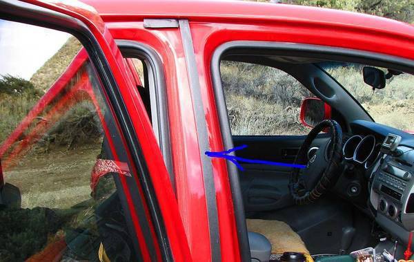

    Step Three:
    Using the thicker 3/4 X 7/16 in weatherstrip, dress the center pillars on each side where both doors join together. This seals out the gap in the pillar from swirling air at highway speeds. The blue arrow in the following photo shows location. I put a small piece top rear as well.

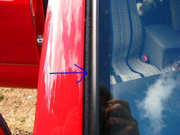

    Step Four:
    Using the 1/4 foam rope and adhesive, fill in the gap on the rubber molding around the windshield. This gap is enough to make air swirl and cause noise at faster speeds. The blue arrow in the following photo shows where I placed the rope. I used adhesive on the ends only to keep it from coming out. Adhesive is always optional, but necessary.
    Step 5:
    I used the 1/4 foam rope to also fill in the gap along the external door molding where it seats with with the door frame. I used adhesive glue in the molding. This gap may also cause swirling of the air. I found sealing the gap with the rope will not effect the tightness of the seal, but simply seals the gap from wind, like the windshield.
    That is it! You will have left over stripping. I used it on the front of the door jams, along the top of the doors. Be creative. Your doors should now be sealed and still close with the quality Tacoma "thud" we have grown to admire.

    The bottom weather strip looks like it would block the drain holes on the bottom of the door...
    Alot of water goes down into the door and drains out...block it up and its going to ruin your speakers and rust the door out eventually I would imagine.
    Also did this actually do anything? When I was hunting down the wind noise to solve mine none of the noise was coming from those areas.
    One problem was the door handle which has gaps into the door all the way around it and a big opening right into the door between the handle and lock.
    Most of the wind noise at highway speed was coming from the bottom of the side view mirrors, the screw holes and the tiniest gaps in the cover for a couple seperate screws, eventhough it sounded like it was coming from in the door, it was just echoing, which was obvious when driving with the door panel off.

    The bottom weatherstrip comes close, but does not block the drain. If this is an issue with some weatherstipping, it can be modified with a knife.

    IDK man, I just looked at my truck and your stripping at the red arrow in the second pic in step two is right over all the drain holes, you're gonna have water pooling in the bottom even with the tiny almost microscopic gaps at the top, and in a harder rain those tiny tiny gaps where you can see your drains at the top of the stripping arent gonna let the water drain fast enough imo, because there are channels that send a good amount of water right down into the door.
    If you were getting wind noise from those areas something like RAAM mat or Dynamat would block it better and make your radio sound better at the same time and block out alot of road noise, but I know thats more expensive.

    Living in Northeastern Nevada, rain is not a major concern. You bring up a good point. Cutting the stripping around the drains would alleviate any water drainage problem.
