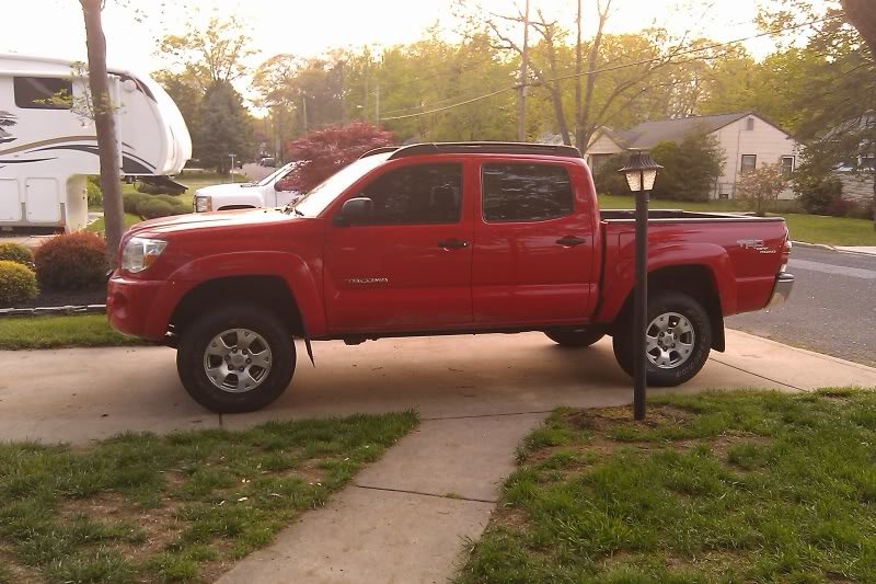

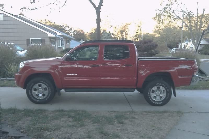

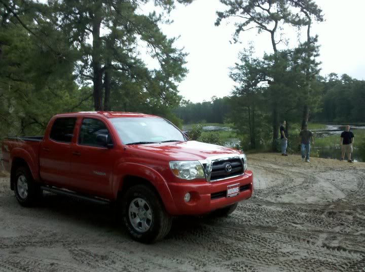

    Hey guys, just thought i'd post up some before and after pics of my truck.
    Unfortunately I didnt think about taking before and after measurements. So what you see is what you get, haha.
    Stock, the day after i bought it:
    Toytec AAL only:
    885s and Bilstein 5100s up front:
    I also replaced the rear shocks with Bilstein 5100s

    how much of a lift with the 885's and bilsteins

    He just said he didn't take measurements.. Looks like a little over 2" or so.

    Yea sorry. No measurements. Easily 2 inches. It was probably almost 3 right after the install. By now it has settled a little. Probably sittin around 2.5 higher than stock. Perfect for me.
    I did not use any additional spacers anywhere. I do have the slight "taco lean" I think. It may have just been my driveway.
    I love the ride. And I love bein up a little higher :)

    Looks to be about 3" or so. Measure teh center of the axel to the bottom of the fender.

    The 885s have settled some. I think Theyre right about where theyre going to be now. Its looks level, but if anything, it might still be a bit higher in the rear.
    I'll go take measurements right now...
