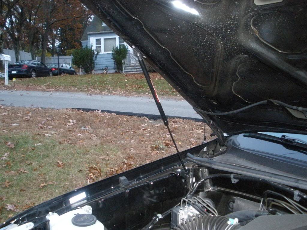

    I Just installed the Redline Tuning Quick Lift, what a great mod this is!
    Easy to do and inexpensive!

    so u have to drill in he hood..??

    You have to drill the hood and the inner fender the hood is attached with rivets and the fender has self taping screws.
    They have them for 1st and 2nd gens!

    I have this on my truck and I absolutely LOVE them. I've had them on for over a year now and they still work perfect... It's a good buy.
    You will need a rivet gun, rivets, metal punch/tap, hammer, tape measure, tape, red touchup paint, and the product itself.
    I picked mine up here: http://www.hooddampers.com/QL-TOY-TACOMA-95+.html

    I got mine a few months ago and love them! And by the way we didnt hav a rivet gun, so we just bought some sheet metal screws and they work great! :D

    Just put mine on today. Very nice and so glad to have no more hood prop! Took about an hour to put on.
