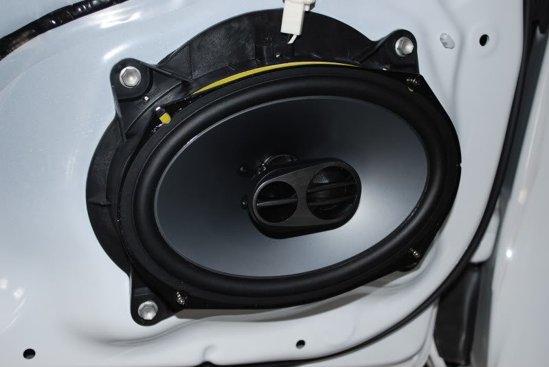

    OK, this has basically turned into a budget build. Someone gave me a template (awesome) but there's some PDF issue that keeps me from printing at 100%. So...I did what everyone says not to do and used the old speakers as my spacers. I bought some rubber weatherstripping, which worked great to make a seal between the speaker and door.
    I was really annoyed half way through when I compared one I had installed to the other I hadn't removed yet. The factory 6x9 speaker has more bass! Once I got them all bottled up and panels back on though, it sounded way better. No mushiness and you can crank them up without distortion. I also realized they like to be run hard (makes sense) and sound way better with bass cranked to 5 and treble to about 4.
    So, I'm done and happy. There's nothing keeping me from taking them out and making some proper baffles if I get around to it, but at this point I have no plans. These things won't win any volume contests, but they do exactly what I wanted, which is clearer sound and add the ability to crank them up some.
    Only hiccup was that I either lost or ws sent one less bolt than I needed. The speakers are a perfect slip-fit for the factory spacers though, so there's no rattle even with 3 bolts in one side. Not too shabby for <$130 all in.

    They had 1/4" spacers in the box, but they didn't seem deep enough. The factory "spacers" are about 1", so they give plenty of clearance. The old speaker cones and magnets were cut out; the cones with a utility knife and the magents/brackets with a dremel.
