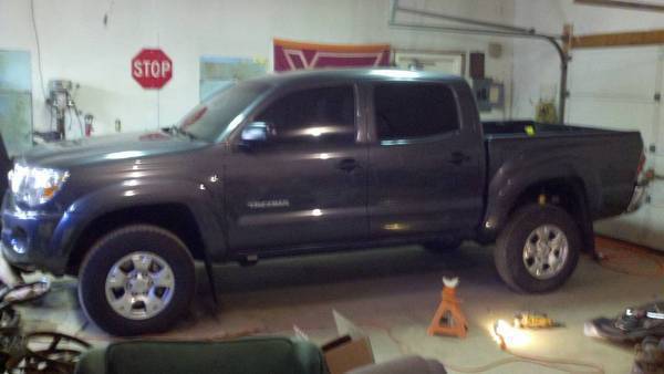

    It's been a while, but finally have all the parts for the lift. Putting 'er on today.
    Pics and pre/post-lift height measurements to follow....Stay tuned...

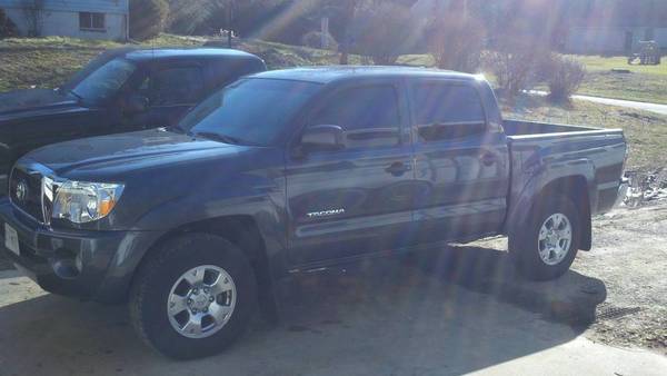

    Before lift pics (pardon my cell phone pics):

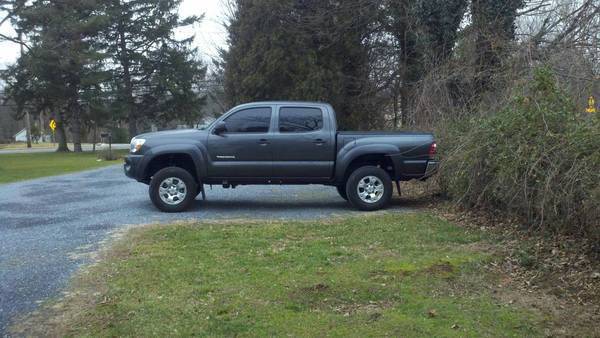

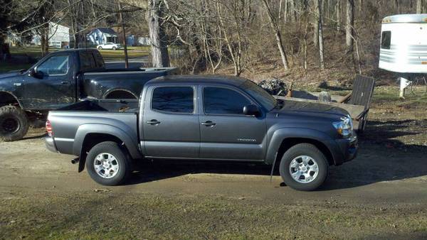

    Rear 2"AAL complete:
    Truck complete:

    How much lift did you end up with in the front with 885 and top plate spacer?? looks 3" or more and is yours 2wd?
  17. Feb 4, 2012 at 12:13 PM
    #17
    98regstick
    98regstick [OP] Well-Known Member
    Mar 3, 2010
    #32463
    244
    Maryland
    '11 DCSB SR5
    OME 90021 with 885s and top plate spacer, 2" AAL, OME rear shocks, Camburg Uniball UCAs, OME CB Drop, 285/75/16 BFG AT's on Level 8 Guardian wheels
    Pre-lift height measurements (center hub to fender):
    Front driver: 19 3/4 in.
    Front passenger: 20 1/4 in.
    Rear driver: 21 3/4 in.
    Rear passenger: 21 3/4 in.
    Post-lift height measurements (center hub to fender)
    Front driver: 24 1/2 in.
    Front passenger: 24 1/2 in.
    Rear driver: 24 1/4 in.
    Rear passenger: 24 1/4 in.
    It is 4 wheel drive. It does look a little nose high at the moment. I am hoping it settles a fair amount. CV's aren't looking too bad. I did not install the front diff. drop included in the kit. I also have the OME CB drop, but didn't install it. I wanted to see if there were any vibes without the drop, which there are, right around 55-65 mph. I'll be installing the CB drop soon, but the vibes really aren't that bad.
    Front lift numbers seem high, but I did buy the shocks/springs/top plate spacer/lean spacer (driver's side) pre-assembled from Toytec, so I am confident they are situated correctly.
