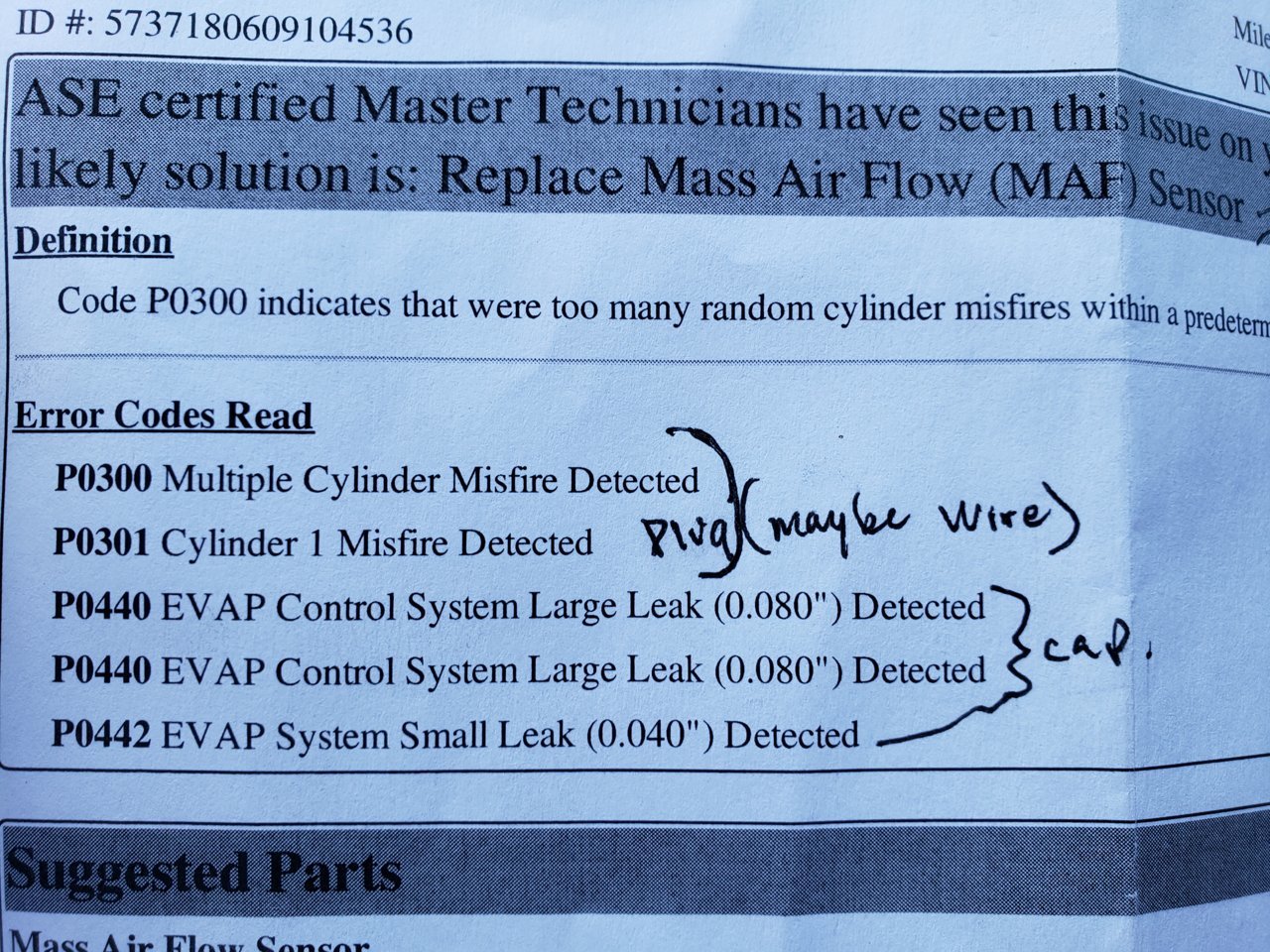

    Here's my codes
    Already replaced the gas cap.. still getting the codes so trying MAF today

    misfires can also be caused by bad sparkplugs coil packs or wires but I'd only replace the sparkplugs and clean the MAF for now to see if that was the cause of the problem. If still misfiring, replace the packs (or wires, depending on which setup you have)
    as for the EVAP system malfunctions, did replacing the cap solve it? If not, then you have a problem or a leak somewhere in your EVAP system

    Well. Looks like I have packs on the left, wires on the right.. idk. The spark plugs have big squareson the left. And almost nothing but the wires on the right side.
    And yeah. I'm doing MAF today and plugs tomorrow... Not sure on the EVAP. I replaced the cap months ago, those codes we're yesterday.
    So the MAF won't get rid of EVAP codes? where should I look first for that.

    Replaced the gas cap, MAF, Spark plugs, packs, wires and I still got a CEL and a code. Only one code this time.
    P0440 is now what I got. Looks like the new spark plugs fixed the misfire.
