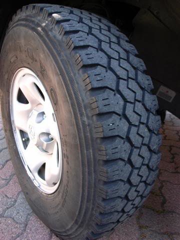

    I found a really good deal on craigslist for 235/85/16's.. set of 4 for $150. They came off a Ford f250 powerstroke, still plenty of tread left.
    $50 to mount & balance = $200 total said and done
    These are Toyo M-55, an industrial/commercial 10ply E rated tire. There's a bit of a hum, but that's common with most aggressive tread tires (so I read).
    These are also my first time driving with E rated tires, but it's too soon to have any opinions yet.
    On to the pictures!
    Solution to Taco-lean - 32" tires on the driver side, stock 30.5's on the passenger
    At first, I thought I had a bit of rubbing at full lock, but after looking at the tire, there is plenty of clearance.

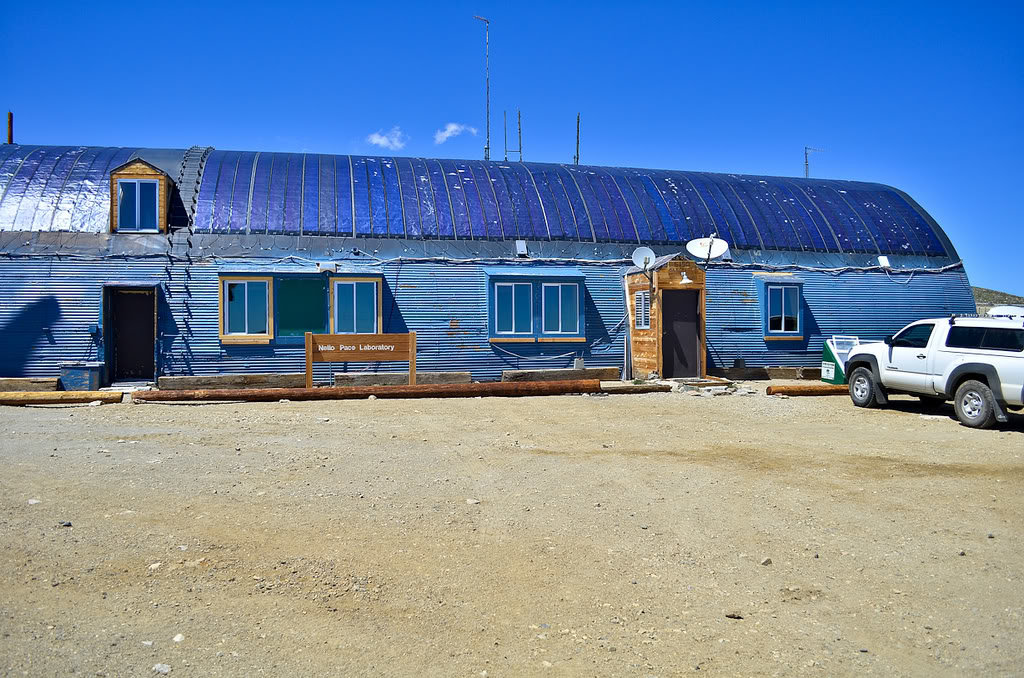

    Stock tacoma performed well going up to 12,500 ft for a research project. Tires (Toyo M55) were amazing; never lost traction.
    View going up:
    At the station:
    One thing I did notice was that lack of power at altitude with the 4cyl. I spent 40 miles in 4lo 1st or 2nd gear

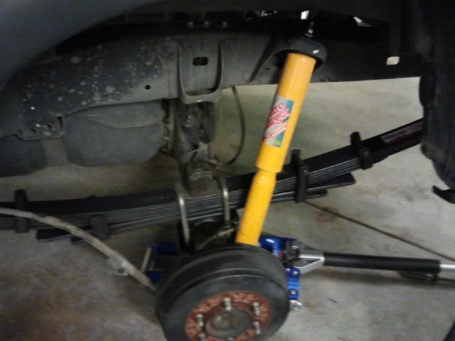

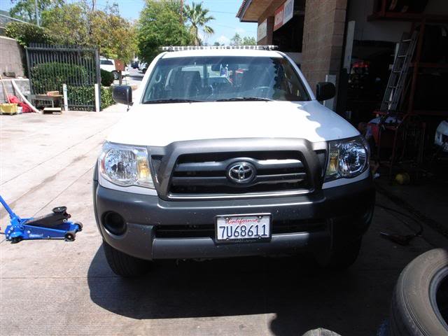

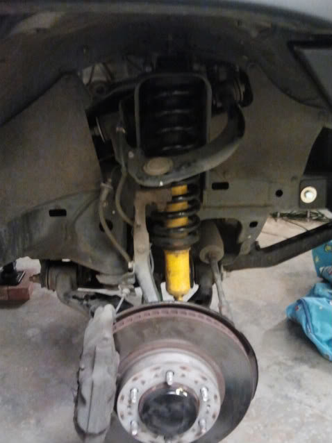

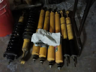

    So after a year or so of CL/forums I finally pieced together a full OME kit and ARB bumper. I actually ended up with 2 OME sets; one with 885 springs and another with 884's. I decided to try 885's first since they already were on the strut.

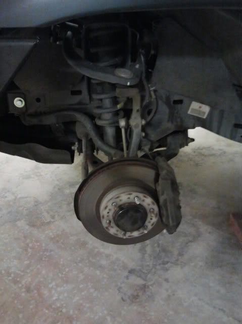

    FRONT INSTALL
    Front install was very straightforward - much easier than I was expecting it to be from reading up online. I did not need to disconnect the steering arm. I had to remove the swaybar to allow room to remove the strut, and then remove 2 bolts that connect the lower control arm to the spindle (on either side of the lower ball joint). Once disconnected it allows that lower control arm to swing down independently. The reason people step/pry/force it down is because the attachment to the frame is on rubber mounts on bolts that are used for alignment; if you loosen them up it swings down easily (you'd have to re-align afterwards anyways). Luckily just putting my weight on the lower control arm afforded enough room to maneuver the strut into place.
    Old suspension:
    New Suspension:

    I have a camper & sleeping platform which together weigh in at about 300lbs. Jason at Demello Offroad suggested I install the Dakars without a shim. I read up on drivetrain geometry as well; I think shims would offset the normal angular velocity canceling designed into the stock U joints. My main concern would then be increased driveshaft operating angle - my hope is that my increased everyday load will keep the angle down compared to guys running open beds.
    Installation was also straightforward; I unbolted the old leafs, moved the shackle to the Dakars, made sure everything was given a healthy coat of lithium grease, and installed. I ran into problems centering the axle and getting the front/rear eyelets in place - I had to place a jack under the axle as well as a bottle jack between the top of the leafs and the frame in order to get the springs into place. A few taps with a hammer and use of a screwdriver to pry into position were useful as well. I was able to maneuver the springs in place without having to drop the axle beyond the brake lines.

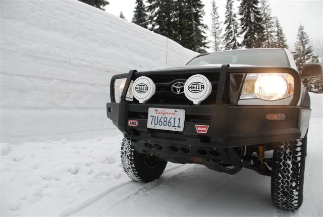

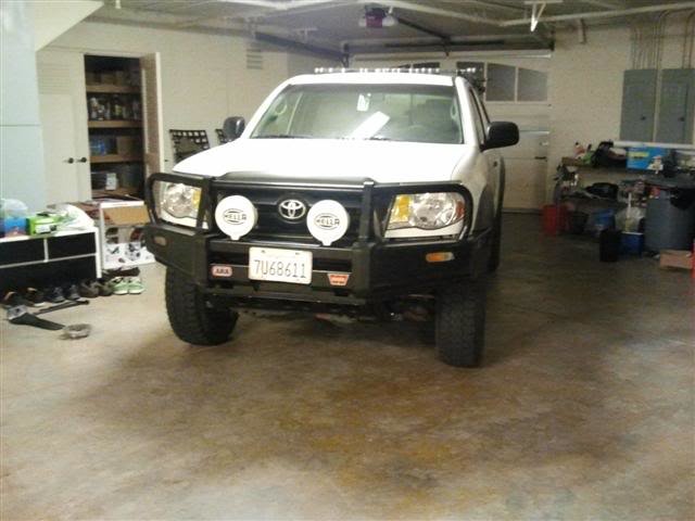

    I found a great deal on an ARB bumper and purchased it sight unseen (lesson learned - don't do that!). Reason being is that the bumper was bent inward slightly on the passenger side. Structurally it is still solid, but some creative grinding had to be done in order to get it to clear the body. Also, the seller did not include the stone guard or tension brackets. Luckily, Mitch at ARB was amazing and through some sort of wonderful coincidence he shipped me the parts I needed for free (left overs from another install they did). Those guys at ARB are really stand up folks and definitely made my day!
    I did drive it with the stock suspension before installing the OME; the ARB (no winch) dropped the suspension about 0.5" in the front, which is not as much as I expected after reading online. However in driving around I did notice the weight and did not want to drive with it like that for an extended period of time.

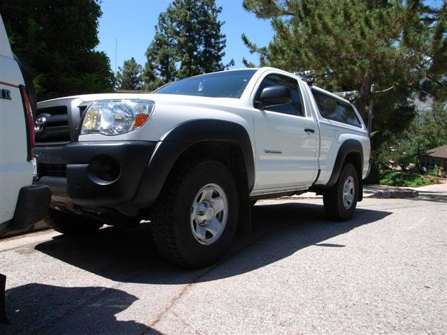

    Lift Amounts
    The front was lifted 2", rears 4". My concern installing 885's was CV angles, but they don't look extreme:
    I realize it's hard to see the fins on top but they still have clearance.
    The rear was lifted much higher than I expected, and higher than what I would like. Hopefully with settling they both will come down.
    All said and done:
    Driving Impressions
    This suspension is much more firm, and is a pleasure to drive. I did not reinstall the sway bar as the springs had paint rubbed off from sway bar contact (previous owner) and I did not want to run into that problem again. I took a trip up north to Lassen National Park during which a piece of sheet metal flew into the middle of the highway; I was happy to find out that it still handles well without excessive sway in an emergency-maneuver environment.
    However, one thing I did notice is a grinding/dry bearing sound when I let off the gas over 60 mph. I grease the U joints every oil change but I still think it may be related to the increased driveshaft operating angle.

    that bearing sound is your drivers side needle bearing in the front differential common problem with lifting 2nd gen 4x4s.
    East coast Gear supply is wiring on a fix for the problem should be out in a few weeks.
