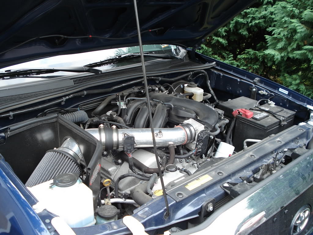

    Here's my AEM cold air intake. I love this thing (great sound) and never had a problem with the computer. Go ahead and get some kind of intake. A lot of Tacoma owners have them.

    i was just taking a straight air filter. They told me the oil in the K+N filters causes problems with the sensors. Does the cold intake use that kind of system?

    The AEM is a dry filter unlike the K&N POS.
