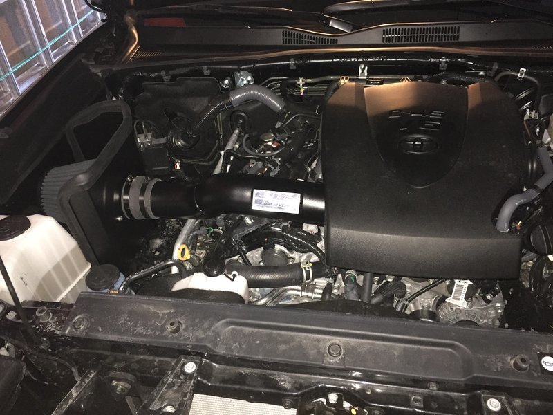

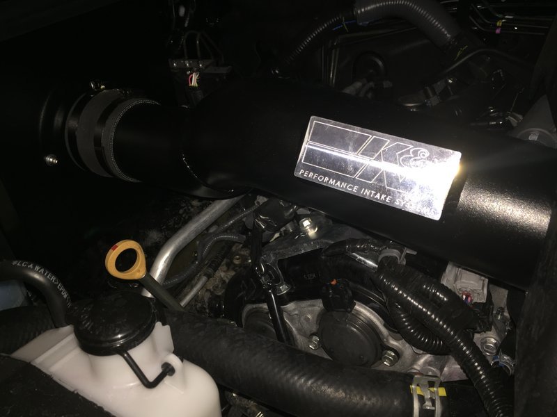

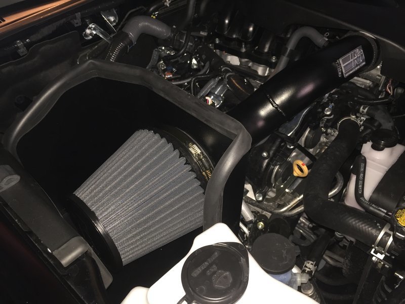

    just returned my black hawk intake, made my throttle response terrible. had to put 3x more force on my gas pedal to make it go, I checked my throttle body for seal leaks or if it was dirty. It was great at first but over time it just felt like the truck was dragging. Shipped it back and ordered the trd air intake instead. I think the truck will like oem better and adjust according to it.

    Does that filter have the K&N oil on it? That stuff coats MAF sensors...did it twice to my taco...

    On my old Jetta i had a CAI and the oil would cause the MAF to fail. car still ran fine.
