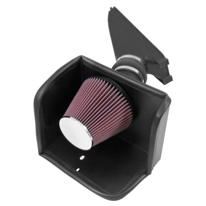

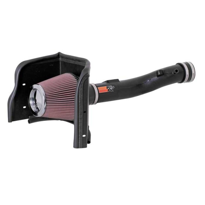

    I’m looking to buy a K&N Performance Intake for my 2009 4.0L. I’m finding two different models and was hoping someone could help. First off, part # 57-9025 says it fits and it goes directly on where the stock air filter clips on. Then there is part # 63-9025 which says it fits and has the longer tube and goes further across the engine bay. Do both fit & what’s the difference in the two?? Thanks in advance.

    They both fit, and the differences between them are obvious if you look at the pictures.
    57-9025 does exactly as they claim; it connects where the stock air filter connects, to the stock air box. The K&N filter heatshield doesn't fully seal, meaning you breathe in more hot air from the engine bay instead of pulling in outside air only.
    63-9025 deletes the entire stock airbox assembly, and replaces it with a tube that connects directly to the throttle body. Different filter heatshield from looking at the pictures, but still not sealed, same hot air intake just more direct flow path into the engine. If you put a gun to my head and told me I had to choose between these two intakes, it'd be this one.
    Bottom line; Either one will give you more sound, but unless you strap it to a dyno and get before & after HP/TQ numbers from your personal truck? It'll be difficult at best to prove it actually increases anything else beyond sound. K&N dyno charts are like EPA fuel economy numbers; achieved in a sealed test lab environment, not the real world. From experience, you'll probably lose MPG at first, as the placebo effect of a cool sounding intake makes you stomp the throttle more. Once the newness/cool factor wears off, your MPG may recover to where it was before adding the intake.
