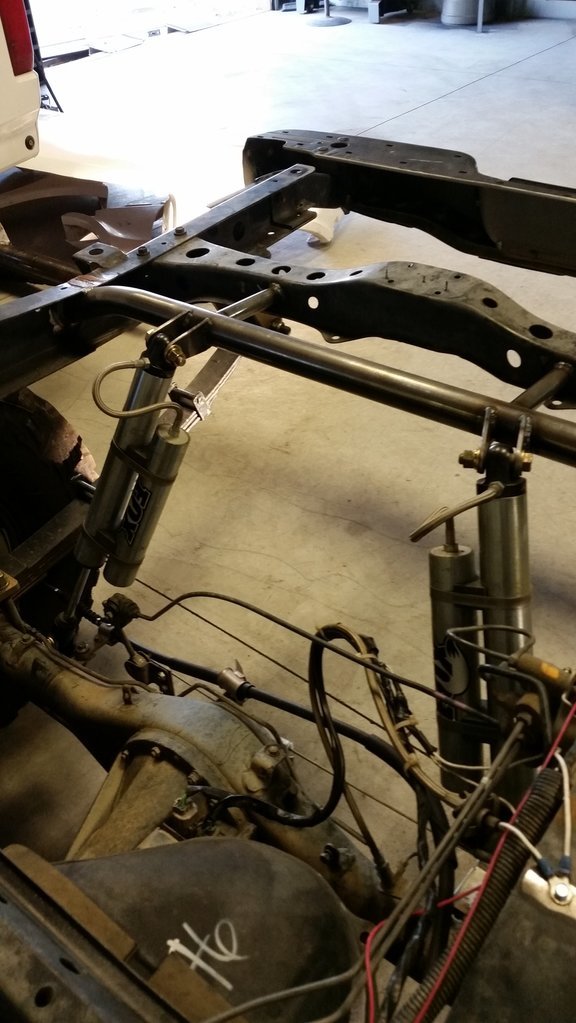

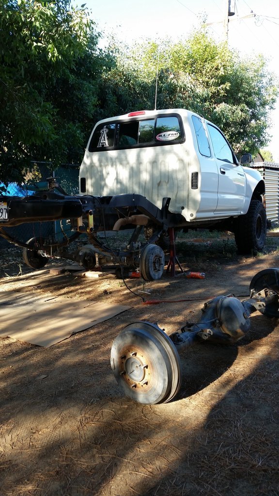

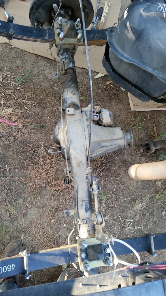

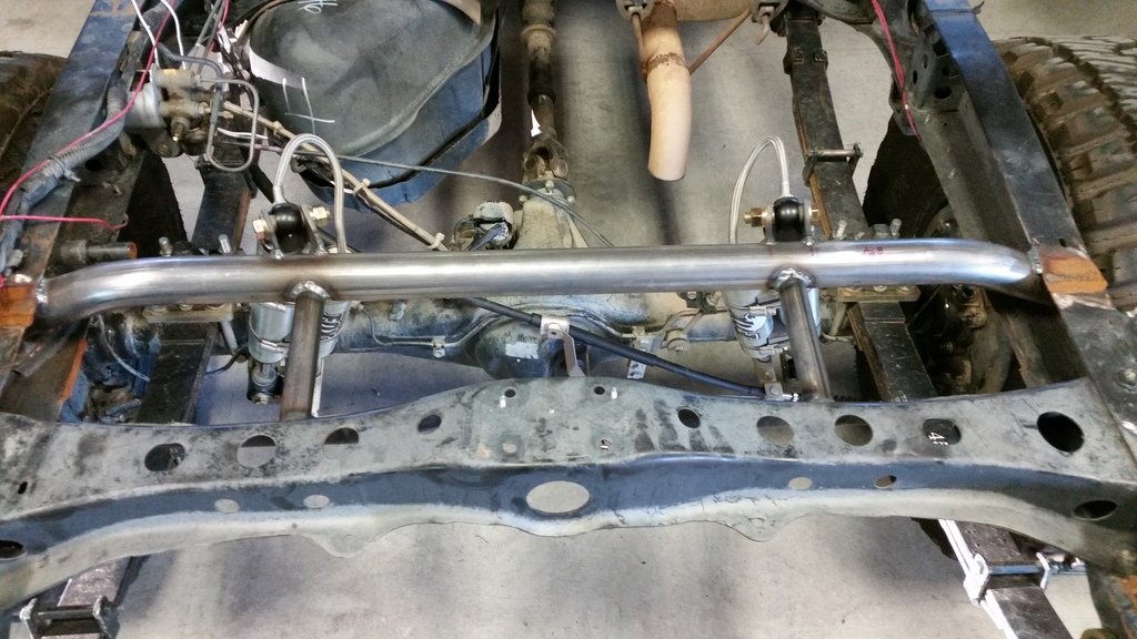

    Installing the new rear end factory e locker just waiting on a switch but its all wired up

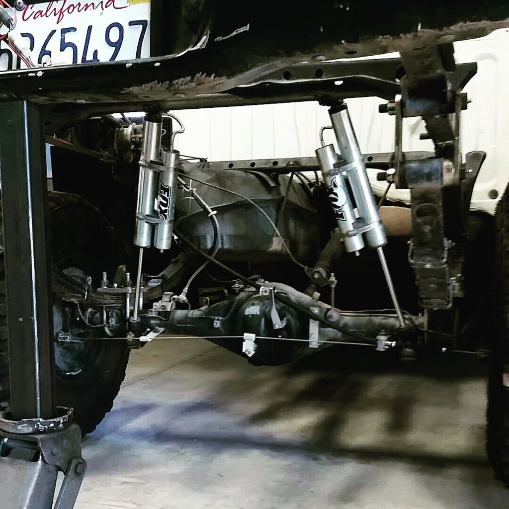

    Got the rear end done new geometry for the shocks in the rear rides better now!

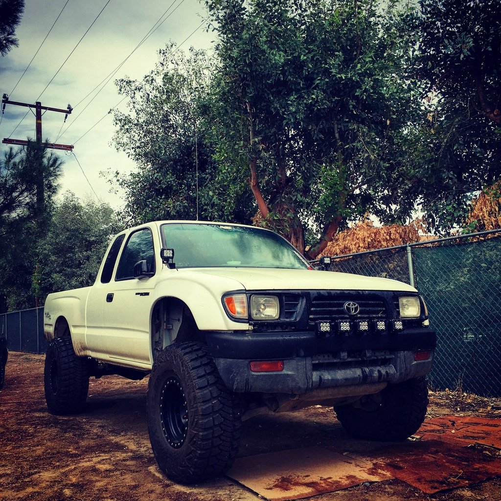

    What is your wheel/tire package here, size wise?
    Nice truck by the way.

    Right there is 285/75/16r
    But currently is 33/12.5/15r
    Thanks!

    update picture!

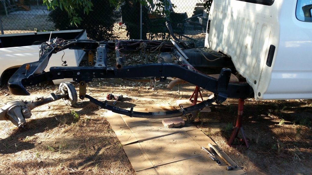

    awesome havent been able to really flex it out due to the gearing not the same as the front yet but its in the works the truck is torn to bits right now and non oped right now to really wrench on it. main thing for the rear is it needs weight dont have any weight in the rear so its a bit stiff for my taste right now but once i add the weight of my bumper bed rack tent and all that it will ride tits

    Ahh very nice. I'm curious to see the new flex shots with the new angle of the shocks.

    yeah same here man i will have some up here soon once i get the damn thing back together lol long travel is coming soon by the end of the year
    also if you need to know the angles are off a 4 door jk wrangler
