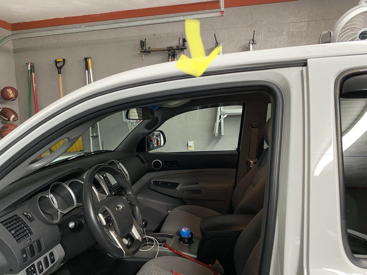

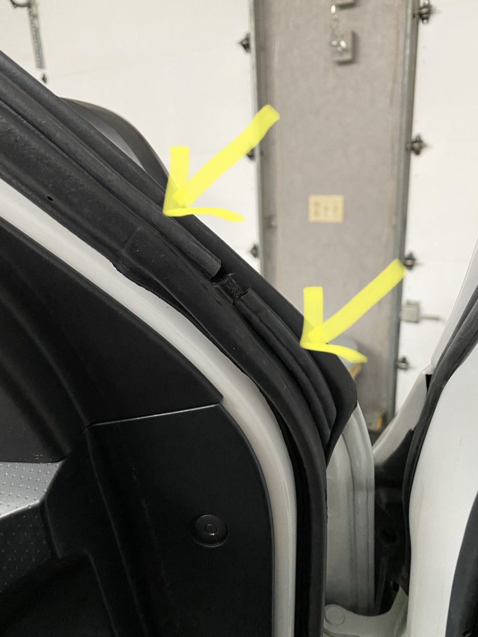

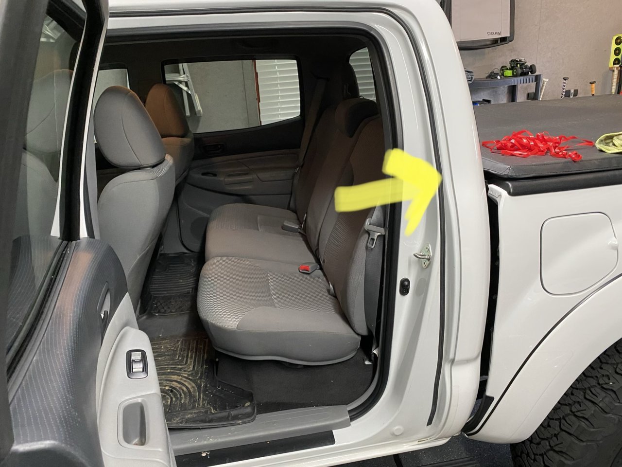

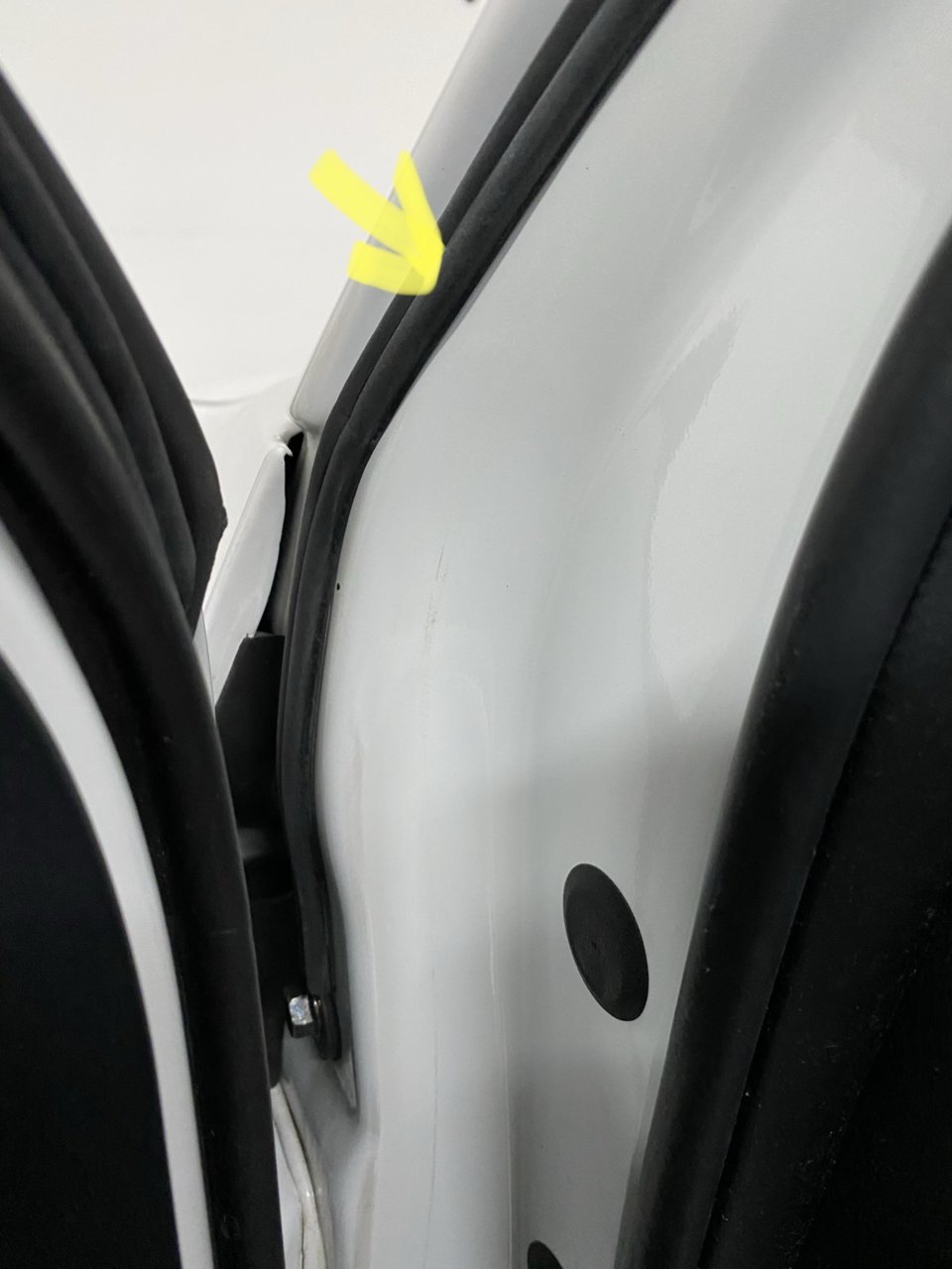

    From reading, using tubing, new seals, etc., I spent $12 total instead of the $100+ for each side with new seals from the dealership.
    https://www.amazon.com/dp/B0771T61VH/ref=cm_sw_em_r_mt_dp_U_.gVUEbYA93YSF
    I know plenty of folks have gone to the dealers and there was also TSB for it. I'm 1.5 hours from mine, and frankly don't want to waste my time with them if I can figure it out myself.
    I cleaned the locations with rubbing alcohol first, then added the new weather stripping on my truck, then actually between the seams of the seal on the door.
    Now I can drive it like I stole it again, without my wife getting so pissed off at the kazoo sound... well, I guess we'll see what she was getting mad at.

    mine would only do it when a strogn head wind or i went over 80 mph

    Thanks for sharing. I just did this after seeing your post, a definite improvement and beats paying over $200 for new striping from Toyota.

    Ive had that kazoo sound only when i get high cross winds. Good to know where to isolate the issue thanks
