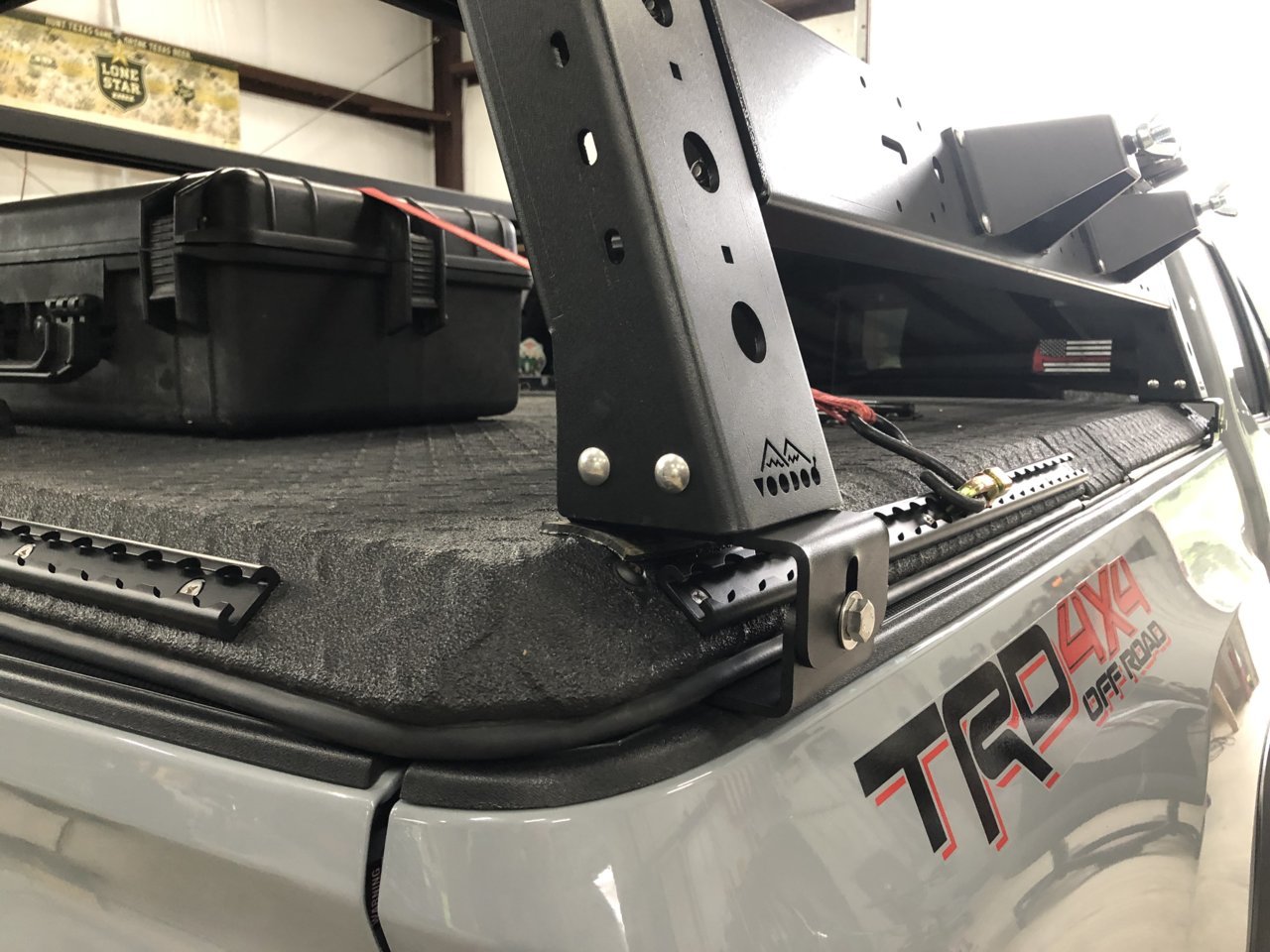

    Mine looks just like yours, but I used pieces of cut rubber boot.

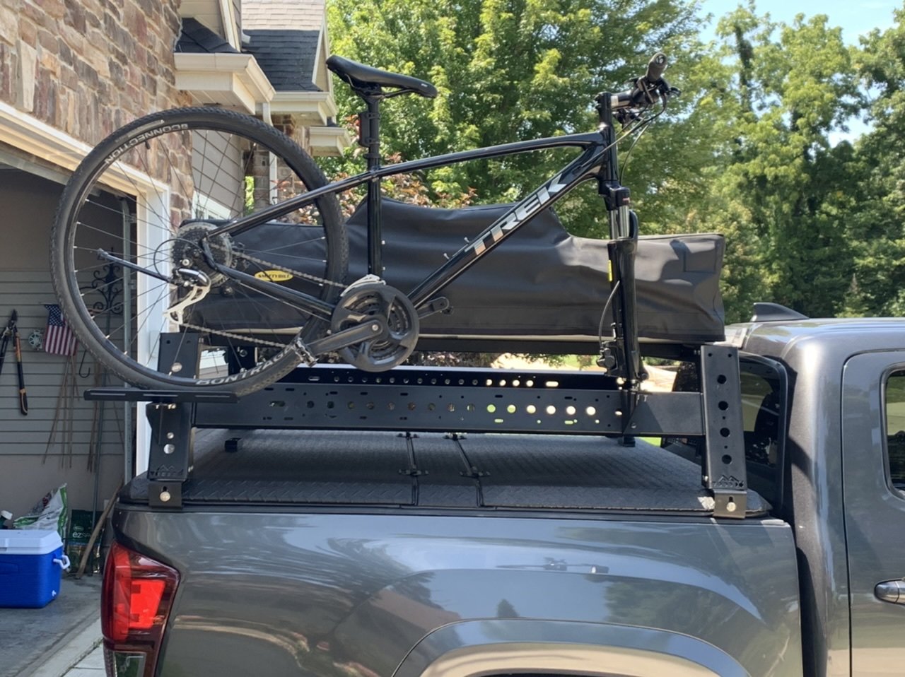

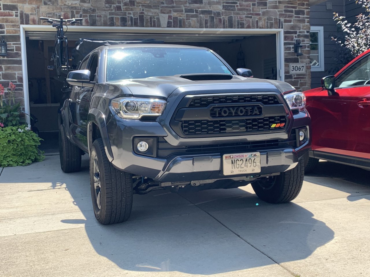

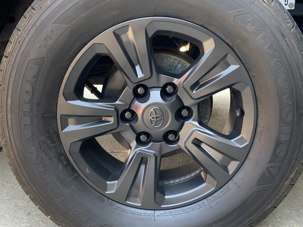

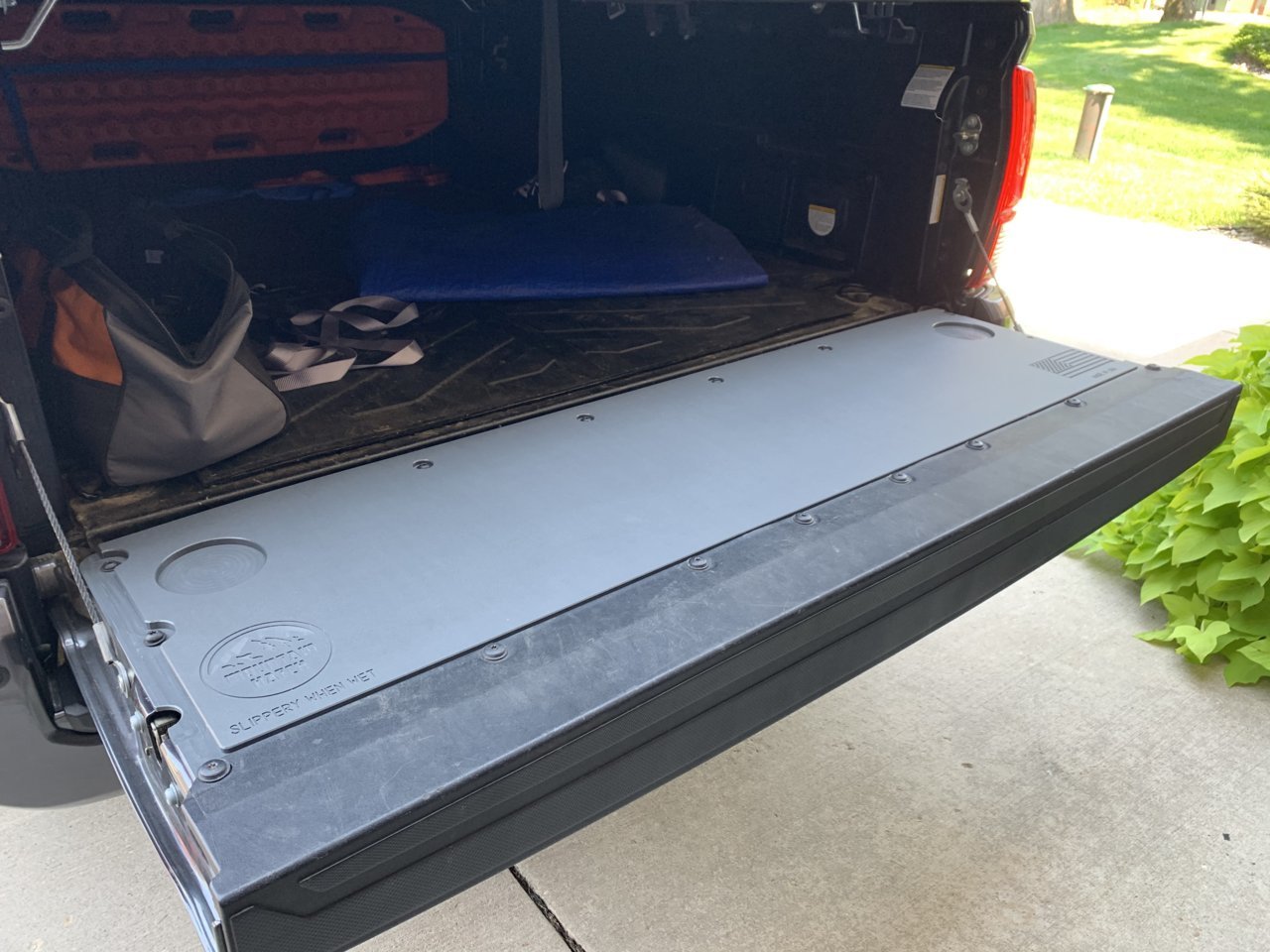

    Thanks guys! Here’s how I’m sitting:
    1353FF5A-F70A-4017-9203-E4DAF4E0DBC4.jpg 8EB6B7A6-9E09-4170-9C6E-8C23366FEEDC.jpg
    Installed the Mountain Hatch last week, haven’t used it, seems nice. I use my tailgate a lot as a workbench and I think the flat surface will be handy.
    Coated my stock TRD Sport rims with 10 coats of Hyperdip (similar to Plasti-dip). Went in perfectly and seems hard as paint. We’ll see what a Wisconsin winter does to it.
    Removed the “MA” so now the side emblems now just say “TACO”

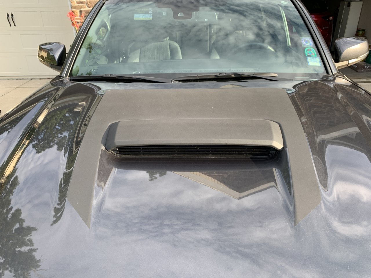

    I masked out and painted the hood scoop with Rustoleum Peelable Paint (again similar to Plasti-dip, but more matte and rubbery texture to it). This is one of my favorite cheap mods, second only to the “TACO” emblems.
    Thanks for the pics of the hoist system. I had bought an HF hoist, but of course it was dead on arrival, and I rigged a manual lift instead. I’ll revisit it with some new ideas inspired by your pergola set-up.

    Solid work my man

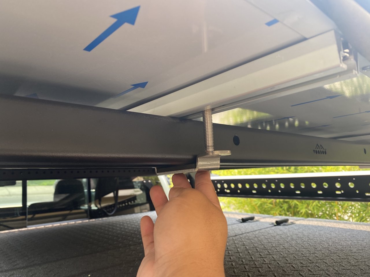

    Hey @Papadave418, how are you mounting your RTT to your voodoo rack? My mounting brackets from my tent appear to be too short.... E78CAF43-89E0-470E-A445-619D908721C3.jpg

    So for my iKamper I put a single bolt right through the crossbar with a locknut in each of the 4 corners. I have the AluMax rack which has a huge 15 series aluminum cross bar that I drilled through.

    Thanks for the reply! Someone else in another thread said to use longer carriage bolts. I’ll sleep on it and make a decision soon.

    All that said, you need shorter bolts. The thread is 3/8"-16 and any hardware store will have them. Several other people have already said this.

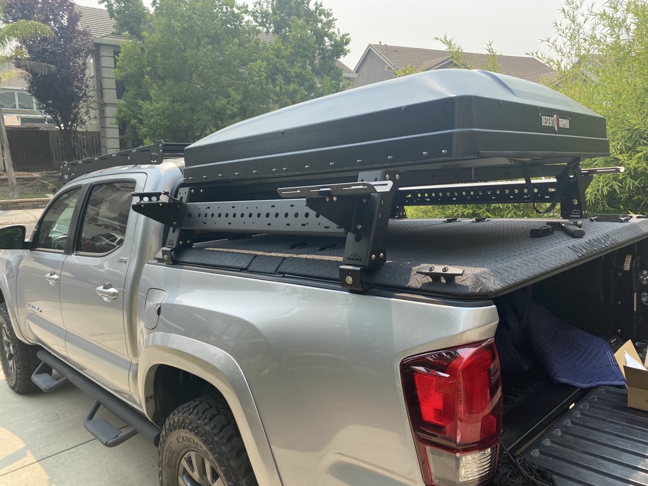

    That’s a slick looking truck! Nice job
