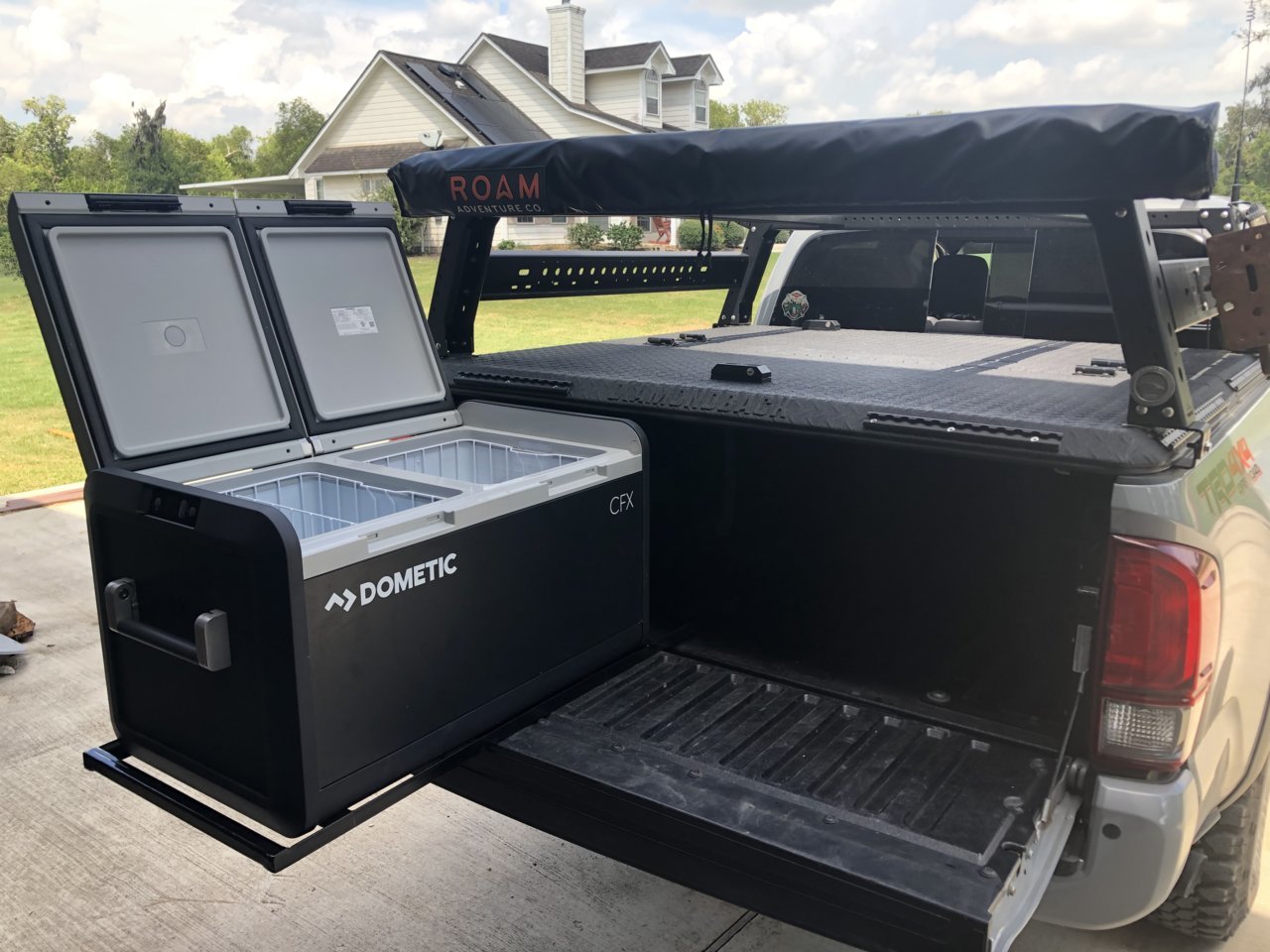

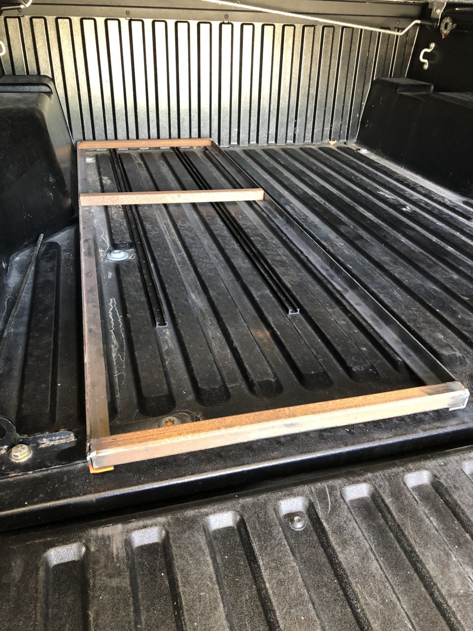

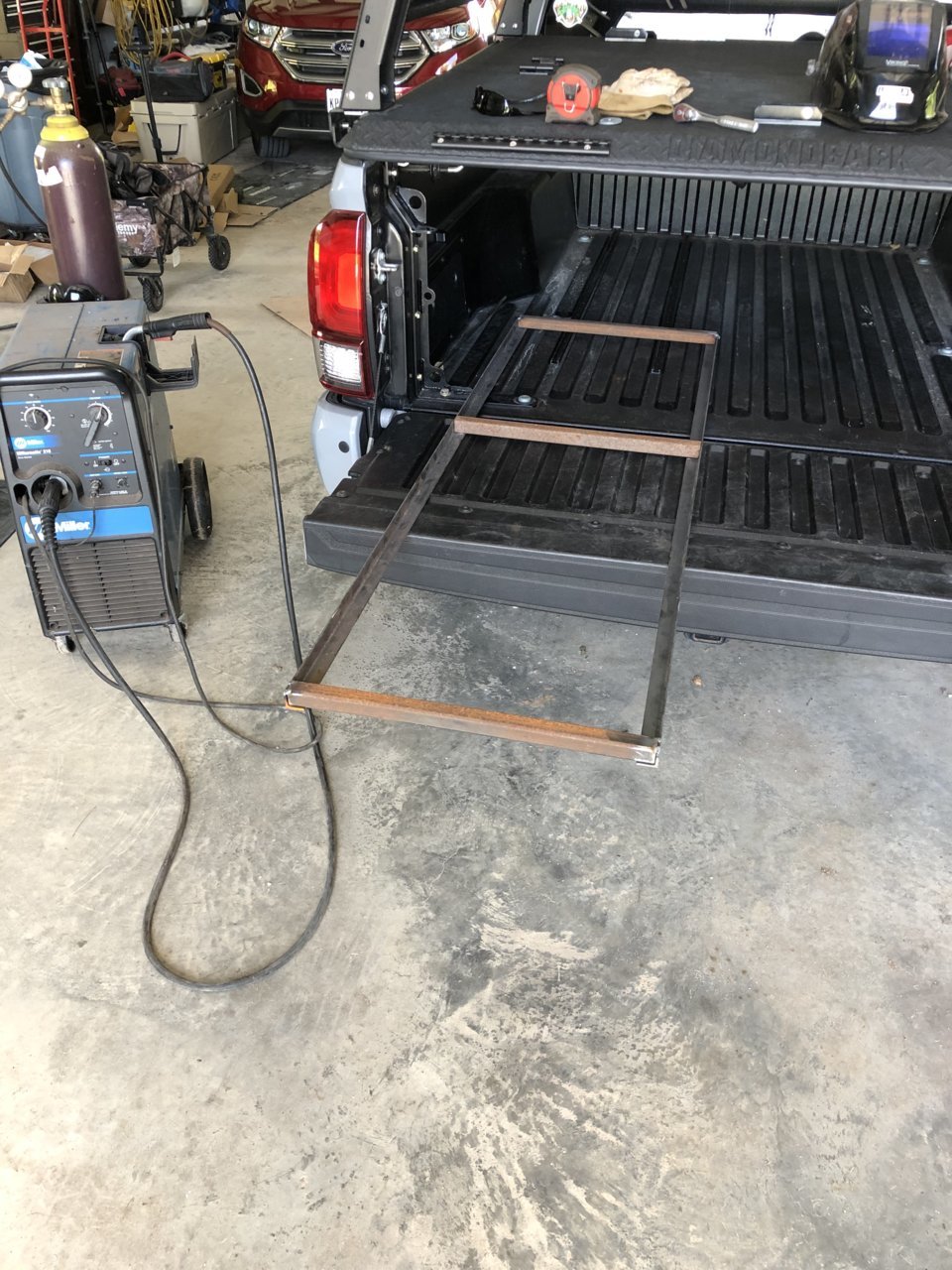

    Started fabbing up my sliding tray for the dometic. I have to give credit for the design to @Papadave418, I stole it from him.
    Blue Unicorn19 likes this.

    That looks good! Show us when you are done!

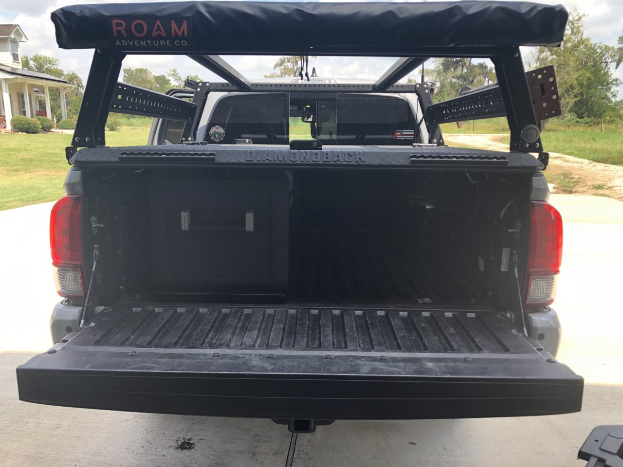

    I don’t remember how much I moved them, but enough out of the way to clear the rack when placed. I just drilled out new holes with a bit a little larger than the original hardware I reused. Moving the lock was the hardest part which required a bigger hole. I used nuts and bolts to seal the old holes and washers sandwiched for the old lock hole. Moving the lock didn’t affect the performance of the locking rods and was easy to adjust them. I had to move my lock because I had the @KB Voodoo cargo tray which has a cross member support that would land right on the lock when using the long bed rack on a short bed tacoma.

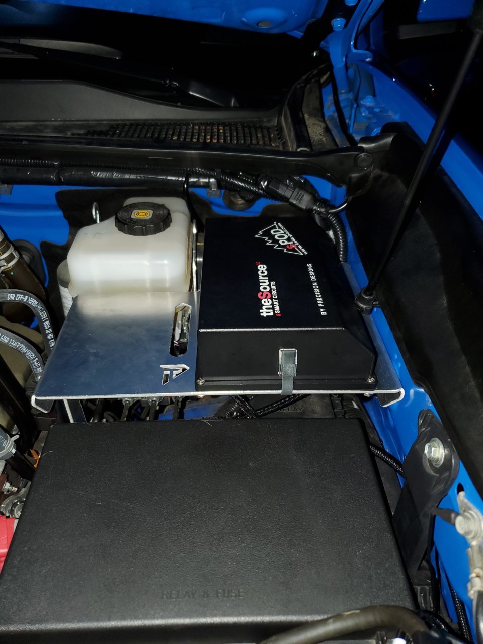

    Your lighting setup makes total sense for ease of use. I currently have an sPod installed under my hood for my ditch lights and future light bars because I didn't want to have to run a bunch of wiring into the cab. I only had to run the cable for the touchscreen controller inside. I was also looking into installing a bluesea fuse box so I wouldn't have to run a bunch of wiring off my battery. The Powertray mount that I have installed has an open area for the fuse box. I could probably route the waterwich switch panel to it. So many options. What do you think?
    You mentioned a buss bar that you routed the 10-gauge wire to from the battery. Where is that located at? Also what gauge 12-pin pigtail connector did you utilize to connect all your lights and other equipment?

    So the buss bar is screwed into the rear by the cubby underneath the truck. I actually ran both a positive back and negative as my original ground spot started to rust a little and started popping fuses. I wired a 100A breaker with shut off switch to an aux fuse box like you mentioned, then back to the panel. I ran a line for the compressor, then another for the fridge to separate those power draws. Then the buss bar is for the miscellaneous power needs like the rack lights and pin switch tonneau lights I installed. If your power tray has that feature use it! I do like my 100A BlueSea switch as I can instantly kill power to the rear and work on it.
    I used 18g for the rest of my rack wiring and such to the pigtail plug

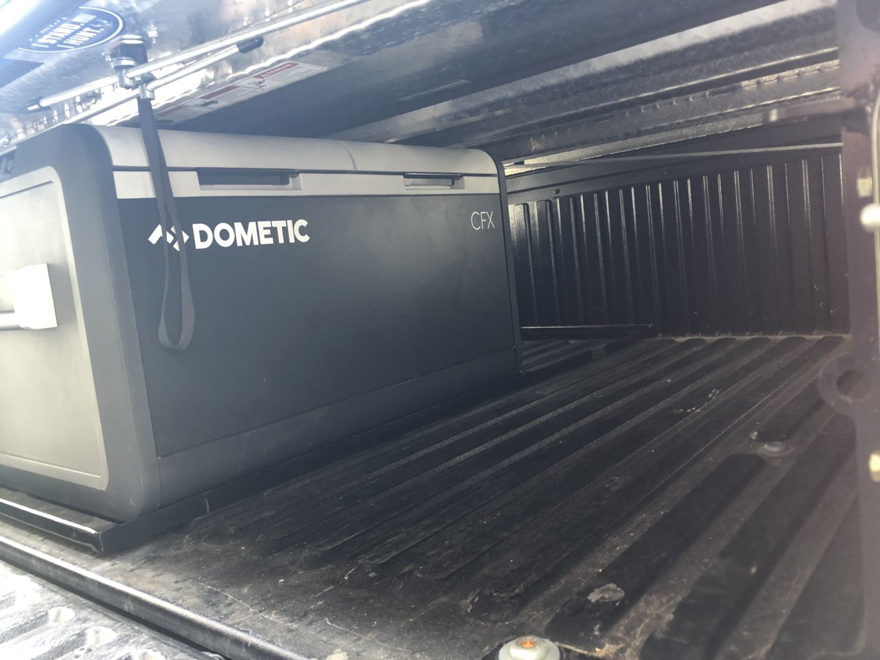

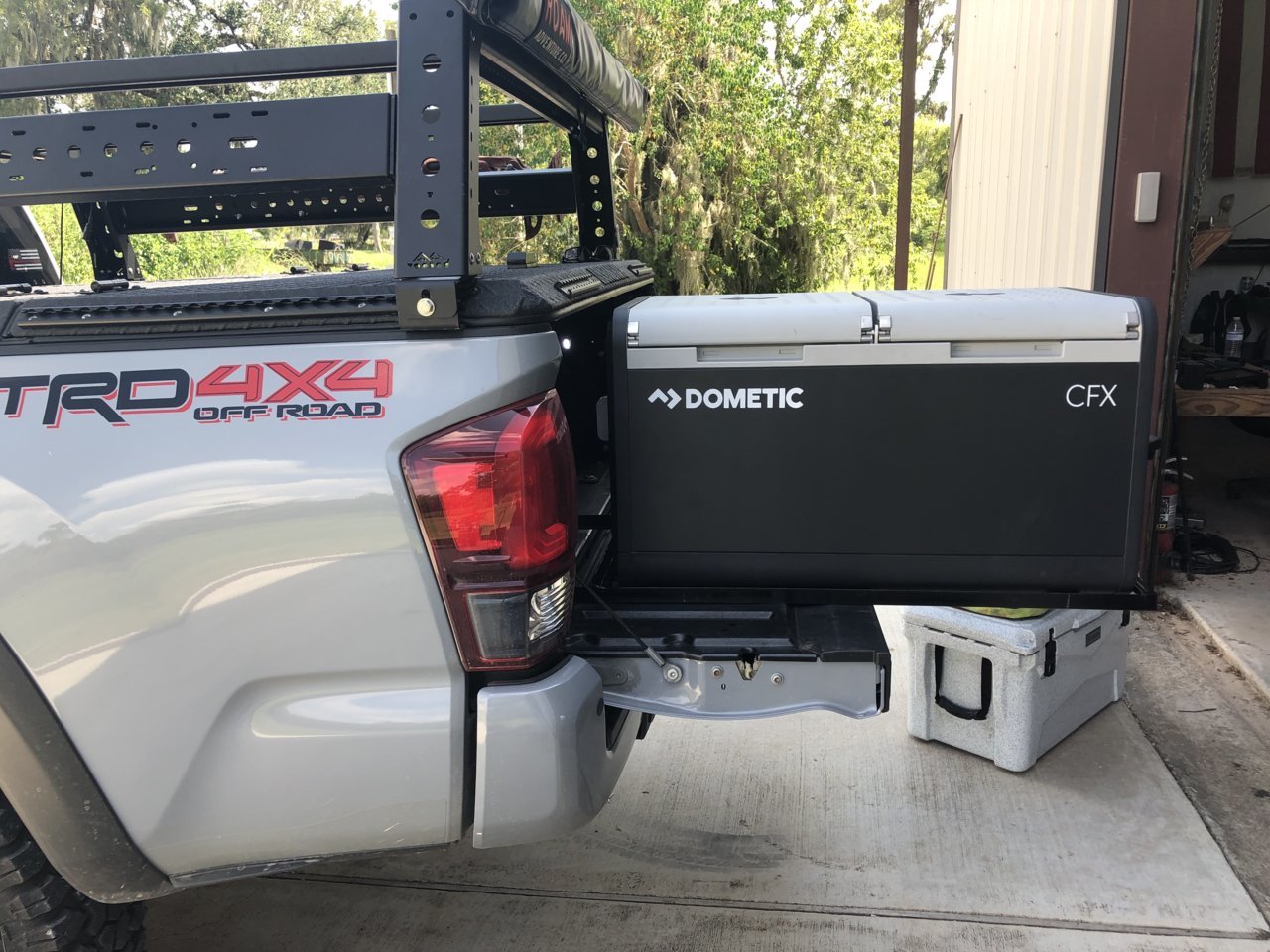

    That looks awesome! I put the fridge side out towards the rear as I access it most, which also means I only really need to pull the fridge halfway out. Works really well next to my Pull Kitchen. Are you going to add a base or keep it open frame?
    savin yours[QUOTED] likes this.

    I welded 2 pieces of 1/8” flat bar, under both sets of feet, but I think I will still skin it with some thin aluminum that I got. I’m thinking about swapping the doors, and moving it to the other side of the bed, to counteract the taco lean. Fridge, water jug and battery will be a lot of weight. Is the pull kitchen heavier that your slide when it’s loaded?

    Yes it’s just under 200lbs. The slides are monsters on it

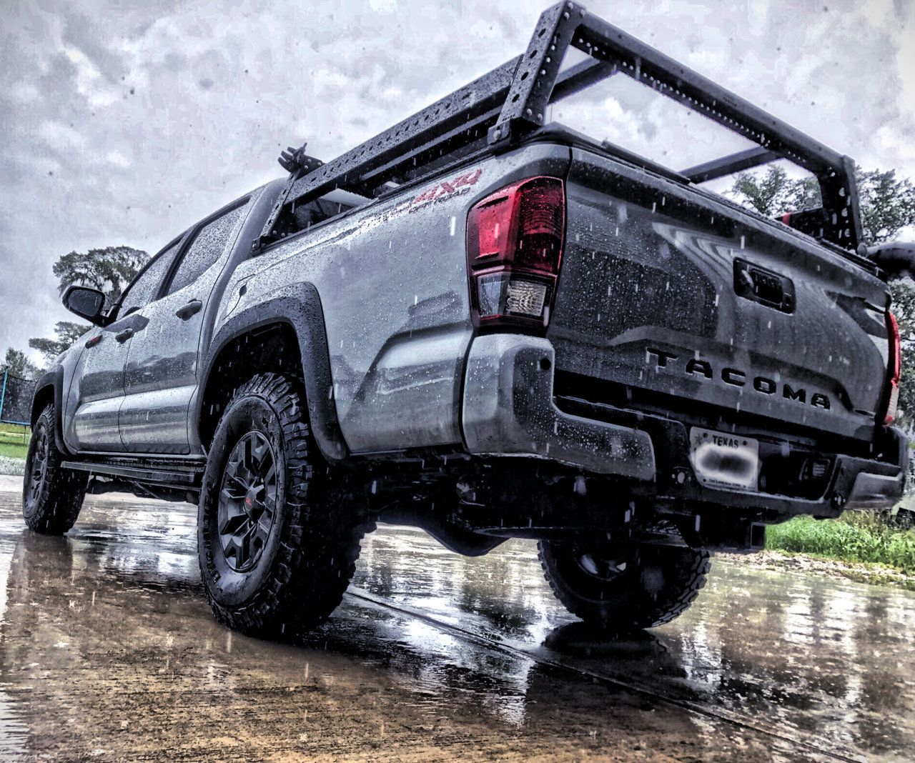

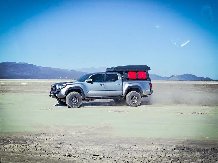

    I still love it! All that I’ve changed is I took off my bike mounts as the bikes hit branches too much so I don’t bring them out much. I moved the rock lights from underneath the bike mounts to the bottom of the side panels and they work great. I still take the rack on and off like a backpack all the time and love it. The 12 pin pigtail works great and love my KC Hilites multifunction light bar. I just did a huge Death Valley trip and then this past weekend I got back from a Mojave Road Trail clean up with Overland Bound. I’d recommend my mods of extending the length of the cargo tray for a long bed rack set up, and adding 56” full extension locking slides to get to the gear more easily. Both I detailed in these pages.
    E8DABF92-FE40-490E-8B8F-8EBEDAF3913D.jpg 0FC6B39B-E087-46A3-BAF8-A8C6F1CCAA5E.jpg DDB8B3E2-8C31-45E3-AFB3-B9DFECF75F79.jpg

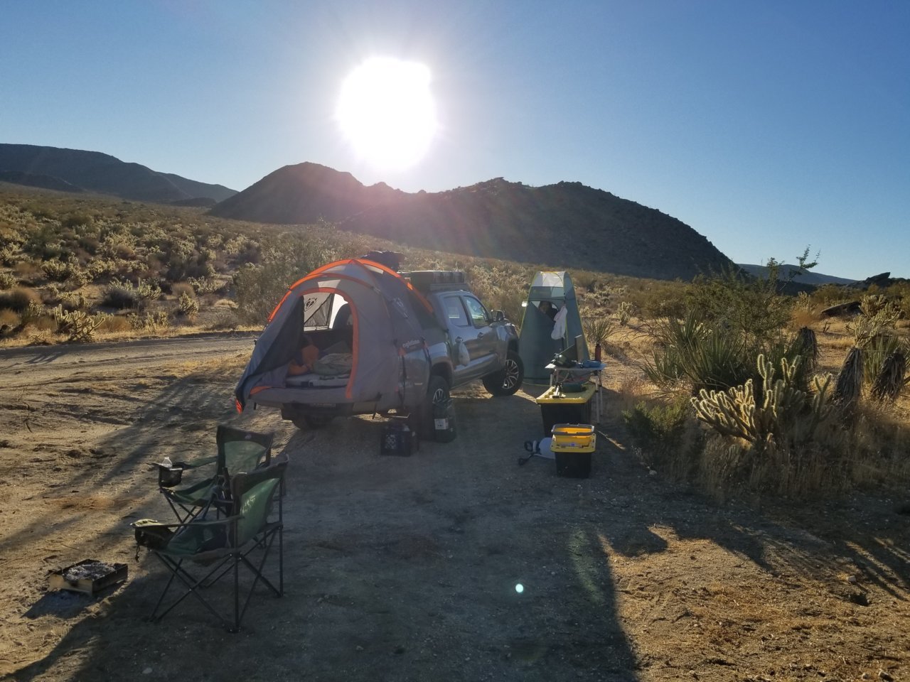

    Thank you for your reply, and again, great job. Those pictures look great. I'm glad that setup is going strong. I just came back from Anza Borrego this weekend, and yes, I had like 7 different boxes I had to unload, then setup kitchen, etc. Right now, it's taking me a little over hour to pack everything back up, and move to another location. I still enjoy it, but I do wish my setup, and break down is faster. If you were to recommend the first few things to add towards a similar setup as yours, what would you recommend do first? And to clarify, I'm more focused on the storage, and tent setup. I'm still not ready to venture into crazy trails, so I think I can wait on suspension upgrades, and possibly tires for now (I'm going to beat up the stock tires a little more before I change them out).

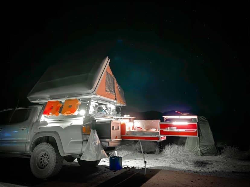

    Well...a Pull Kitchen.....hahahaha
    It takes me 5 minutes to set up my tent, 2 rugs (under the ladder and privacy tent), Quick Pitch privacy tent, full Pull Kitchen set up (15 seconds), 2 chairs and King Camp Table. Tear down is slower to get the table and chairs away, maybe 10 minutes to tear down. Normally I don’t get into my 2 bins unless I need my annex or hot water heater for my shower.
    So I would start with the portions of your set up that make camping suck, cuz the more you reduce those the more enjoyment you’ll have and the more you’ll go. The iKamper was HUGE for me because I do not like sleeping in tents. It cost A LOT, but I have at least 50 nights in it in 2 years and the set up is really like 1 minute. I quickly realized that the kitchen portion was a significant time suck since I don’t like hydrating my food, I wanted to actually cook food. So then my diy kitchen progression began to solve that.

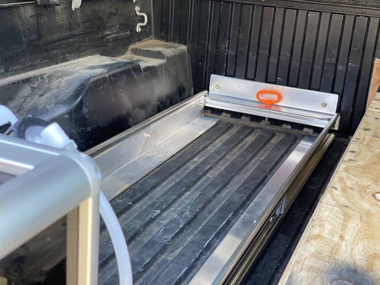

    I put an 1/8” plate on the plywood base at the distal end that the bolts slipped over to anchor the rear to the truck. Now we use an angle of 3” aluminum to anchor the rear and rivnuts through the bed. Much better solution. Picture below.
    I like that the rack was bigger and would cover more of the bed so that is why I did a long rack on a short bed Tacoma. It also allows more room underneath for cargo like bins and chairs. That’s why I had to modify the cover.
